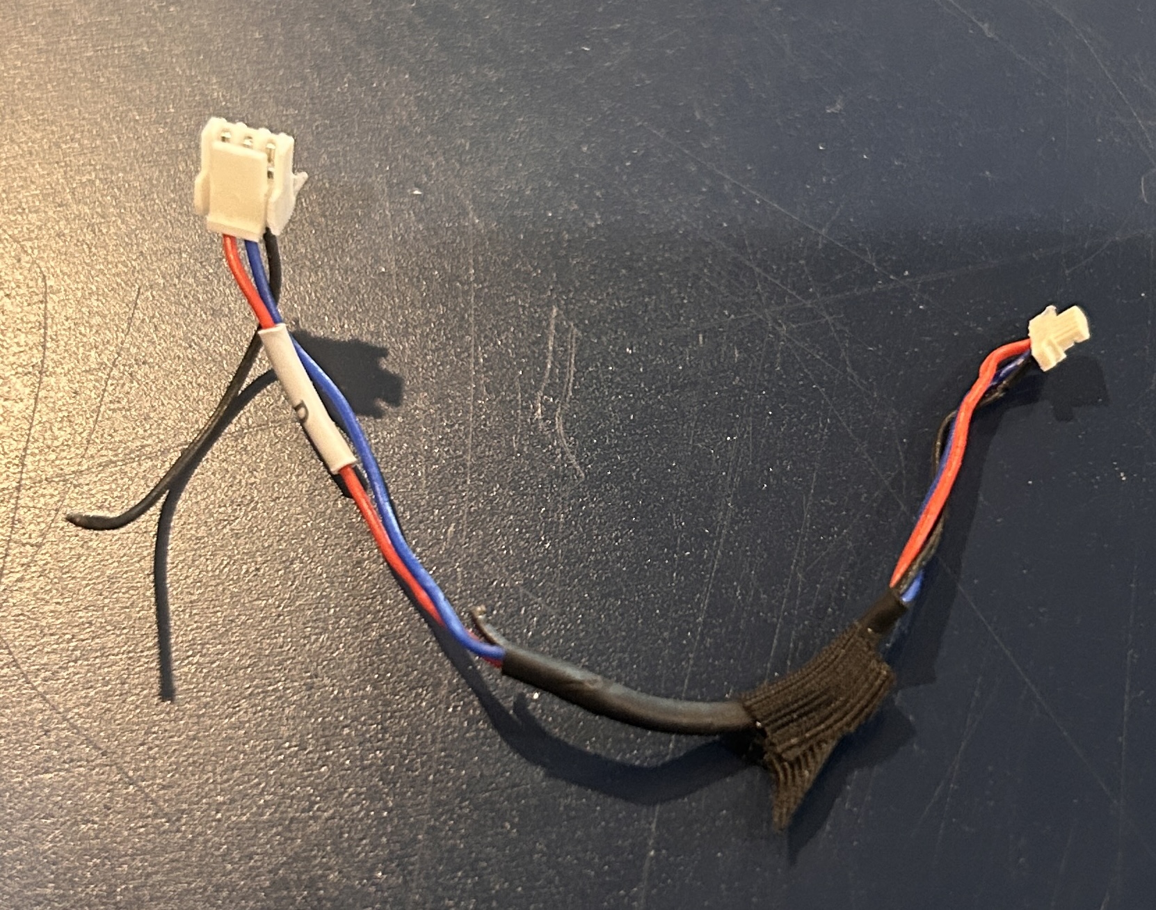

Printer started jamming in the extruder. I found the cable had been severed and although I have reached out to support, I would like to be able to buy parts quicker.
It is the extruder motor cable shown here.
If anyone knows where I can get them it would be appreciated.

It will be easier to solder. Or assemble a new wire. The terminals from the connector are taken out. New terminals are bought that correspond to the cable connector, and these terminals are offended.

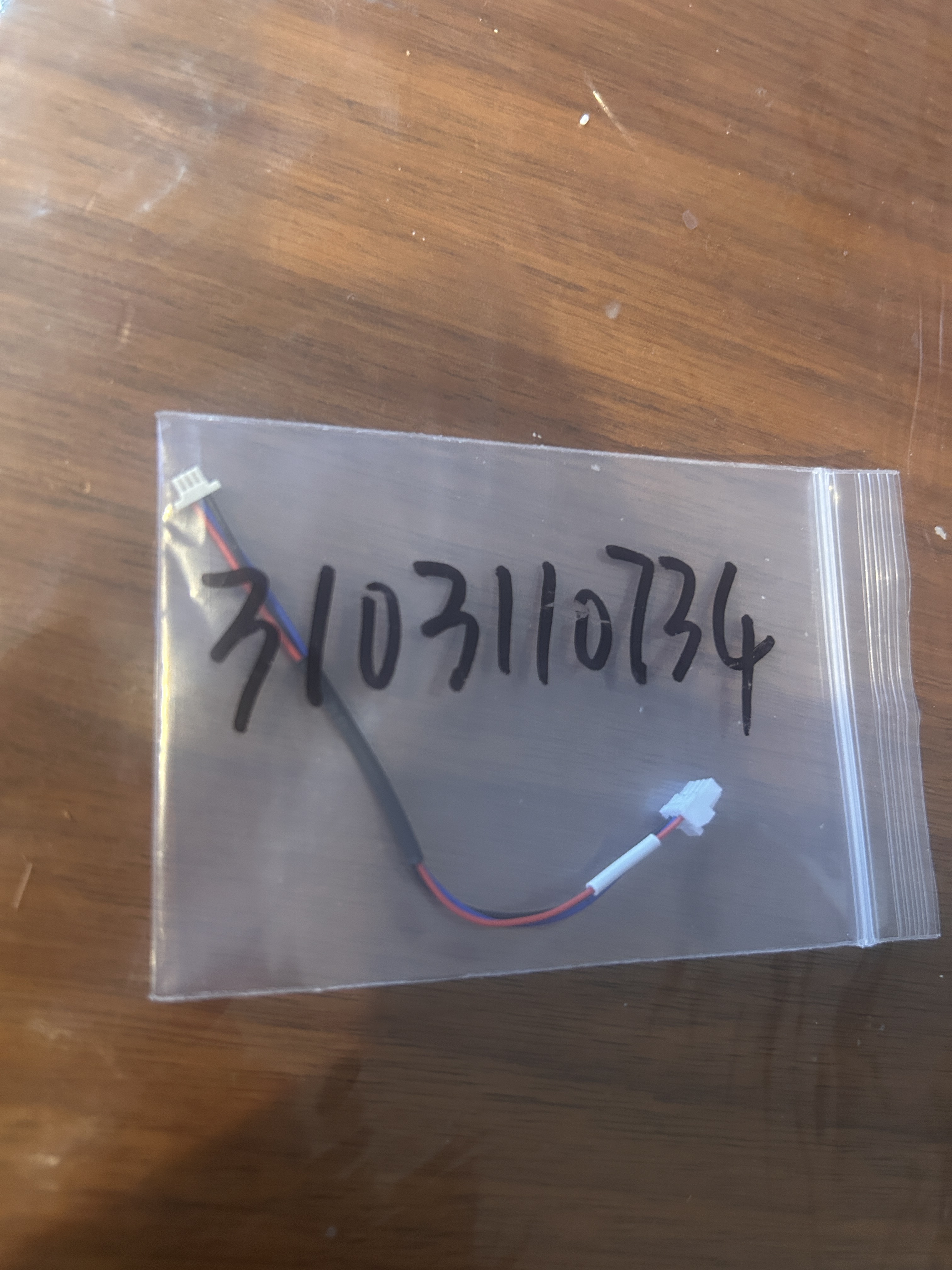

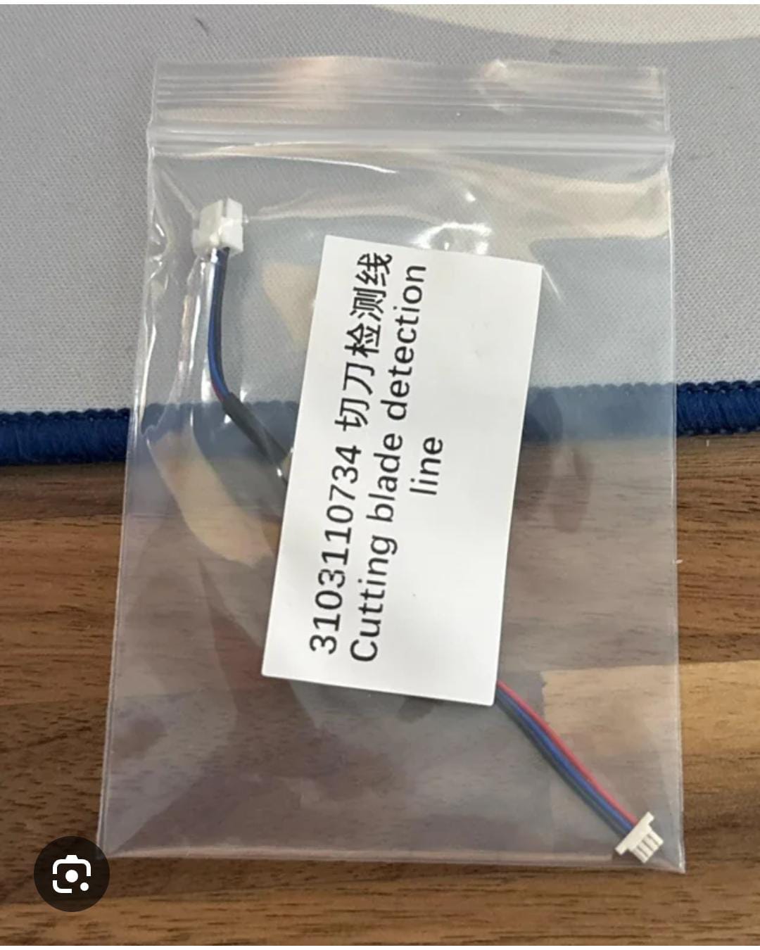

Received this P/N from Creality this morning:
3103110734 Cutter Test Cable
It should be noted that based on other forums, any cable that is not labels may not be required. On that premise, last night I tried printing without it and so far so good.
That being said, they are still sending me the replacement cable.
I hope this helps! :slight_smile:
Update: Two cables received today. One was wrong (as were the previous 3), the other was right. Apparently 4 wrongs make a right. Haha

Creality never did get it right. From what I have found, that cable is used for testing only. I’ve been running without it since with no issues.
Good luck!
