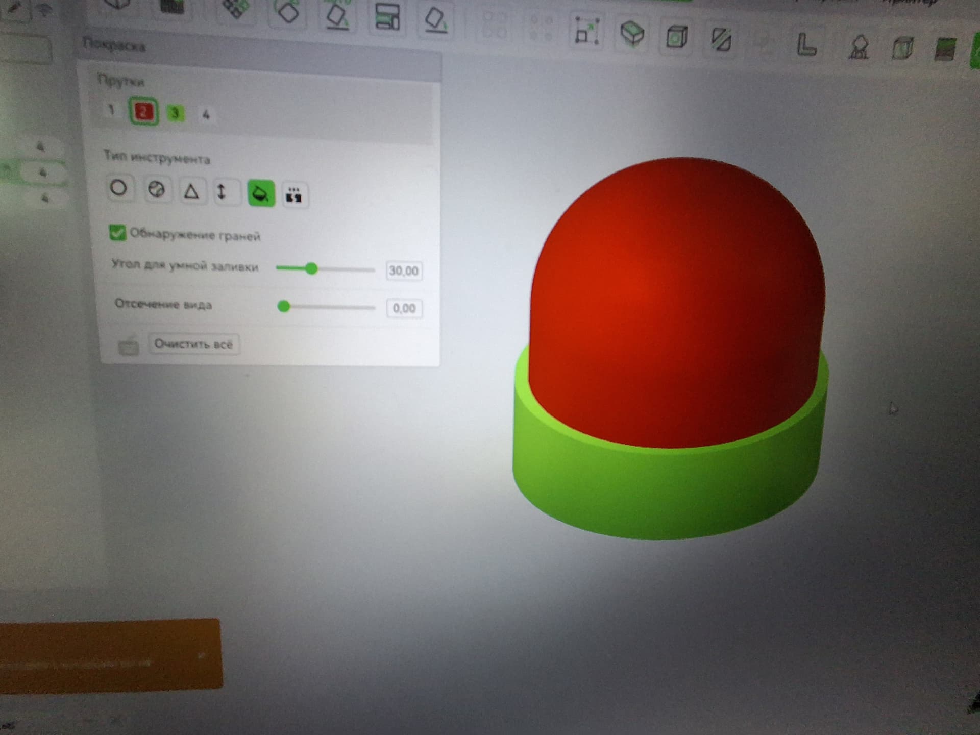

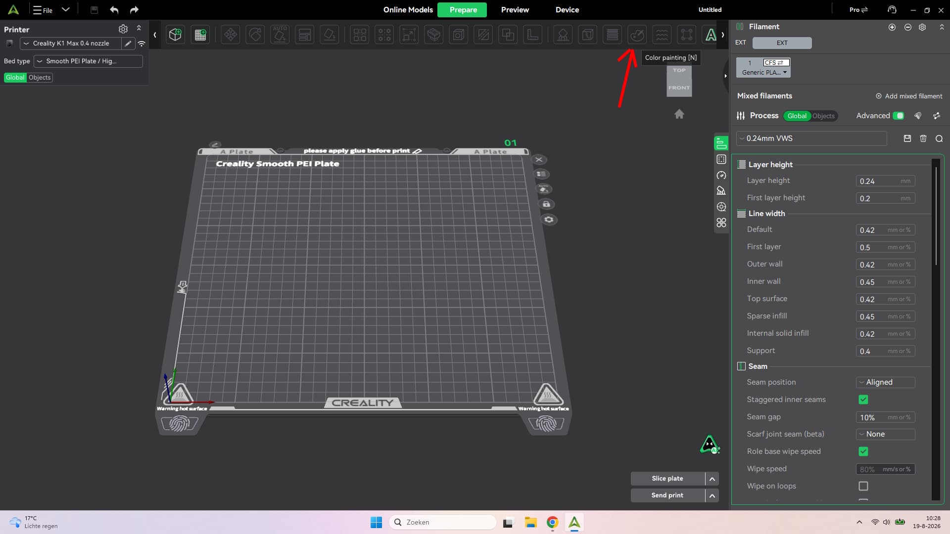

Hello, before printing in the Creality Print slicer, you should use the palette tool to color the model parts with the desired colors and then send it to the slicer. The printer will then print the color image. Happy printing!

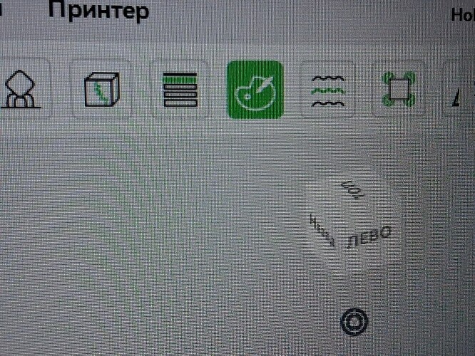

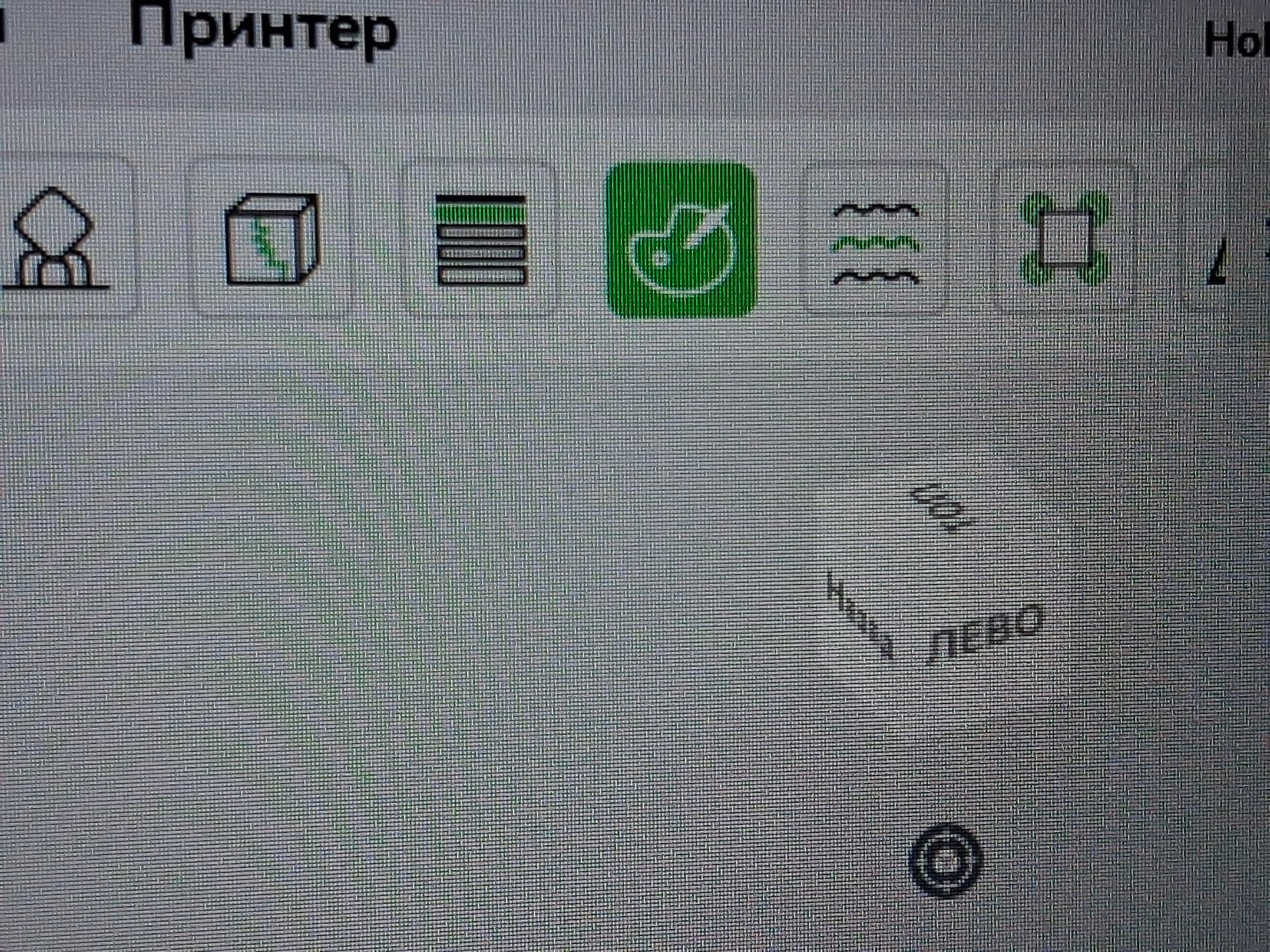

Ähm, what kind of software is that? I do not see this picture in the creality software? I tried to figure it out which icon i can use on the workplace🙈
If you don’t see the icon you have to scroll through the button-bar…
Hello, this is Creality print 7.2, only the theme is white.
This is Creality print 7.2 only the theme is white.
Видимо она использует creality cloud , мобильное приложение а не десктопное
The photo was taken from a laptop. Tomorrow I’ll take a photo of the entire app and the laptop.:grin::+1:
