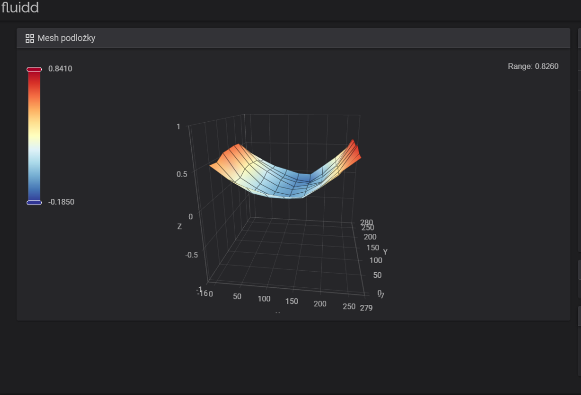

Hello. I want to ask about manual bed leveling. Is it possible to do this with this printer, and has anyone done it on an i7? I’m a newbie, and I’m afraid of making things even worse.

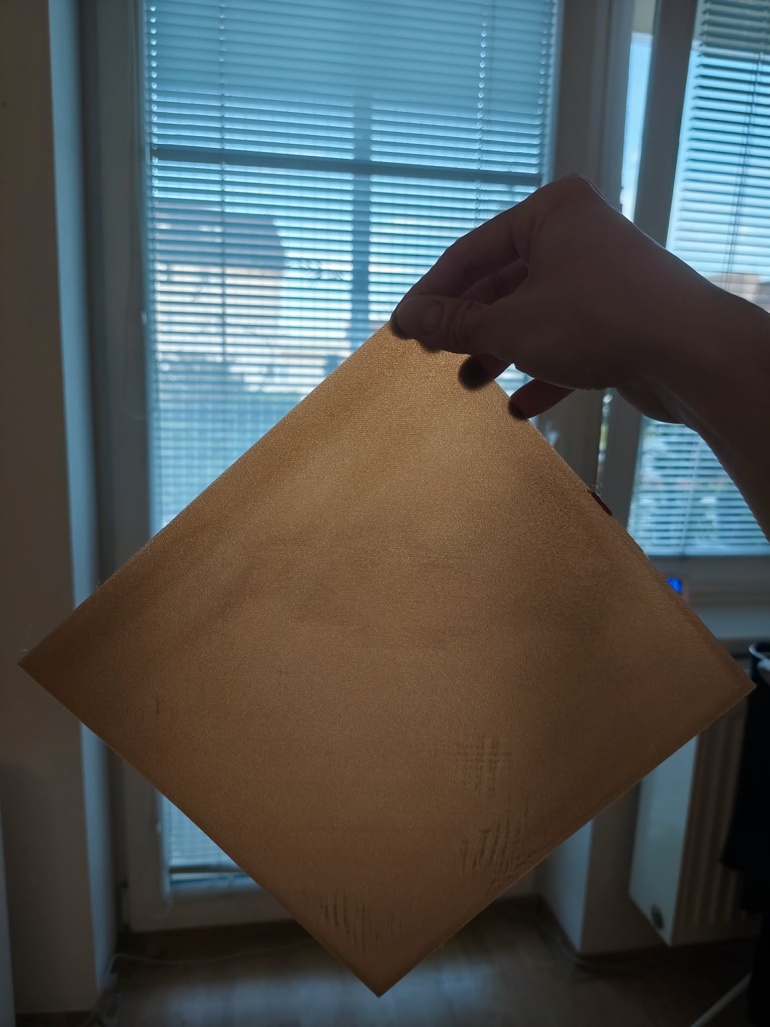

Yesterday, I was printing an object with a large surface area on the bed, and I noticed that some areas of the first layer looked pretty ugly. Before the print, the printer performed quite a long auto-calibration on the whole plate, twice.
When I checked the bed mesh map in Fluidd, I discovered that my bed is warped like a banana, with a height difference of 0.826 mm across the bed. That seems like quite a lot.
What do you think? Is this normal, and what can I do about it?

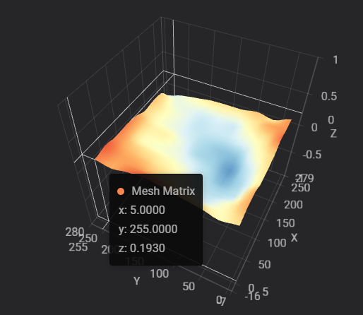

Yes, the video is quite old; in fact, I was learning as I filmed it (XD). You don’t actually need to use your hands or paper; in fluid you can lower the nozzle past Z = 0. Go to the bed mesh map and click on the corner that is too high; check the value shown there, loosen the corresponding bed screw, and lower the nozzle at that exact corner using a negative value (for example, -0.40). Once the nozzle is in that position, adjust the screw; that corner of the bed should now have a lower value than before. If it has lowered but isn’t quite right yet, you can repeat the process until all the corners are level.
DONT LOOSE THE 4 SCREWS TOGHETER, DO IT 1 BY 1 AND IN CROSS (X),
For example:
in that corner you see: X = 5 and Y = 255, so first make sure you take out your pop shotter by unscrew 2 screws that hold in place, dont make force to take it out, be gentle so cant brake by accident so you can work with more space. then press home all on fluid (on tune tab), when home process ends, go to the (home tab) and put a value like 100 to Z so the you cant make mistakes while traveling on X and Y. when you are there, just travel to the position of that corner but just using fluid, on the home tab, put the corresponding values of X and Y of that corner, then loose the screw, and lower the nozzle so the bed lowers to the corresponding Z = O, if your corner is “Positive” (0.6) you must put negative (-0.60) to Z value, and then you tight the screw of that corner. after you do that to the corners you are having that RED values, as i see on your photo your problems are on your 4 corners, so you need to do every one, step by step, corner by corner, (i recommend you to do in X (cross) first front left corner, and then, back right corner. and then back left corner, and ending with right front corner. once you adjust every corner by lowering the bed with the help of the nozzle and the negative values that you put on fluid and then tight, when you done, press home all on the tune tab, and then in that tab, press calibrate (all in fluid) when calibration is done, post a picture of your new bed mesh if your results are better than before, if not, try it again until you find the best way to do it

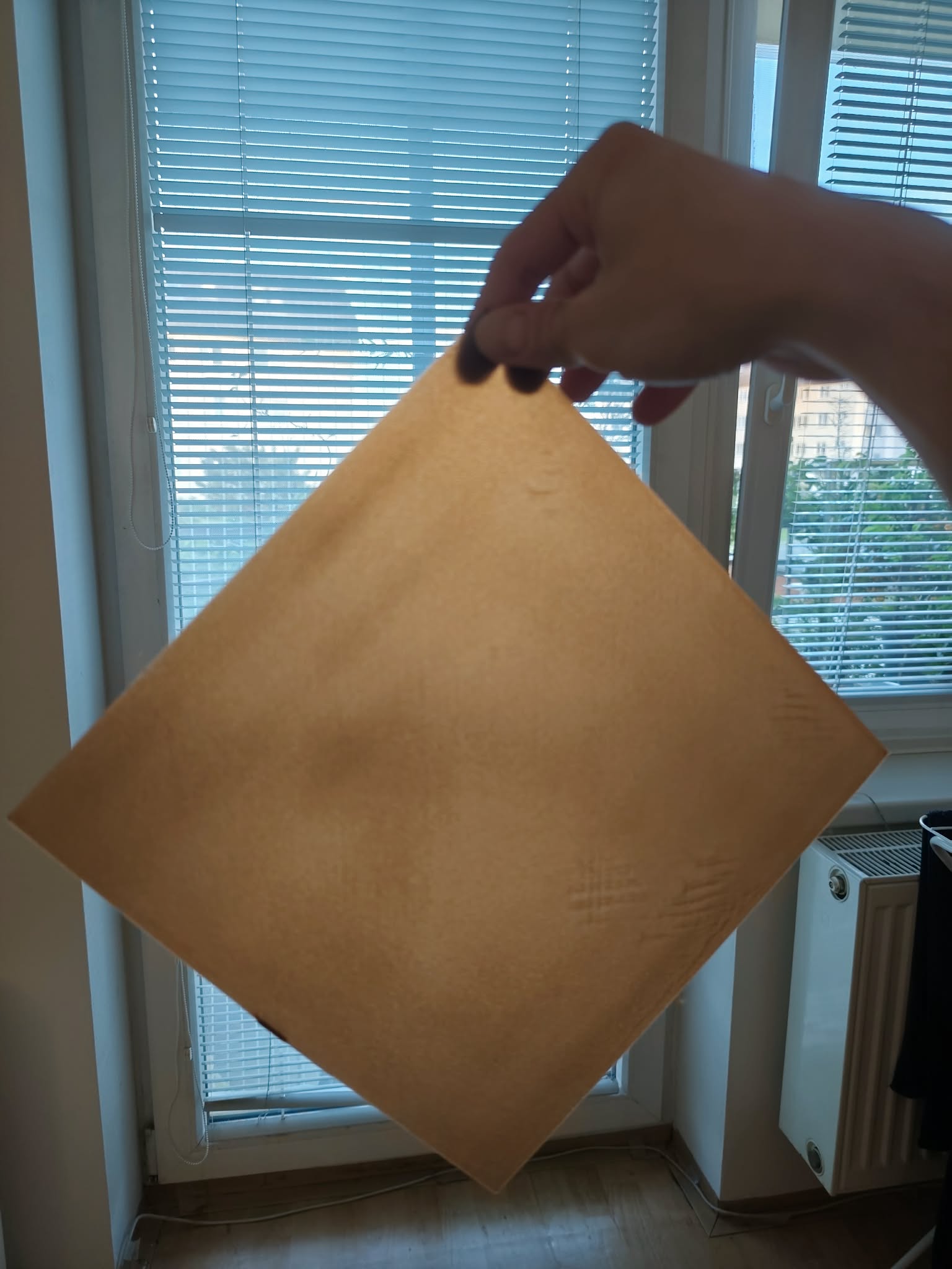

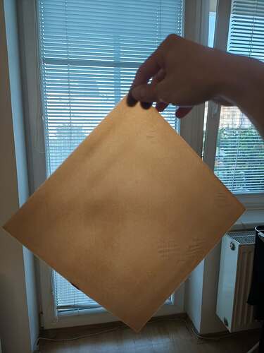

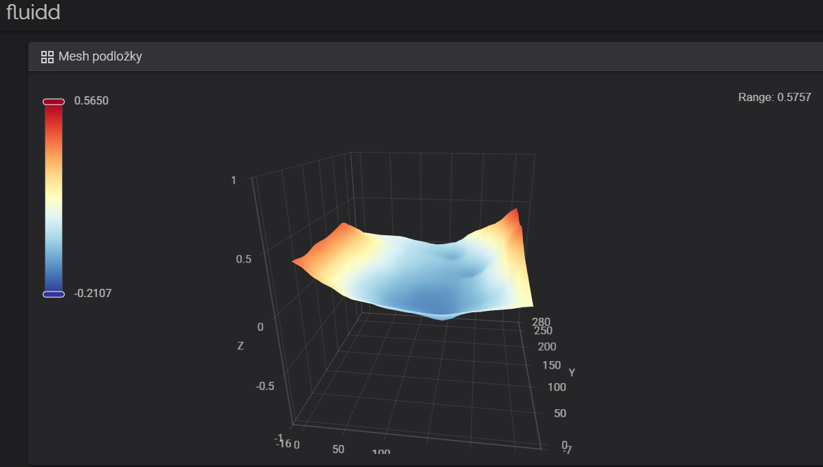

Thank you for your time and detailed manual. I wanted to do it today and i decided to do first layer test before and after. After first test i got pritty alright first layer. So i decided not to fix something what is not broken. :smiley: I will do it eventually if it get worse and i know where to find manual.
On the sheet there are some artefacts but they look worse then it is in reality. From the bottom it is completly smooth. I clean plate with IPA after every print and also i stumpled on pritty decent and cheap filament which i recommend - Flashforge hyper PLA.

Thank you for teasing my nerves. :smiley: I played with it for last 3,5h and this is best result. I once had minimal difference in 3 corners and 4. was 1,1 mm high. So i pushed last one with big hopes and than i got what you see bellow. I tried your method and also cooperation with my GF. I loose screw or both screws on one side, than she pushed with her palm and while pushing i tightened screws. We also tried diagonal pushing. I am tired boss.

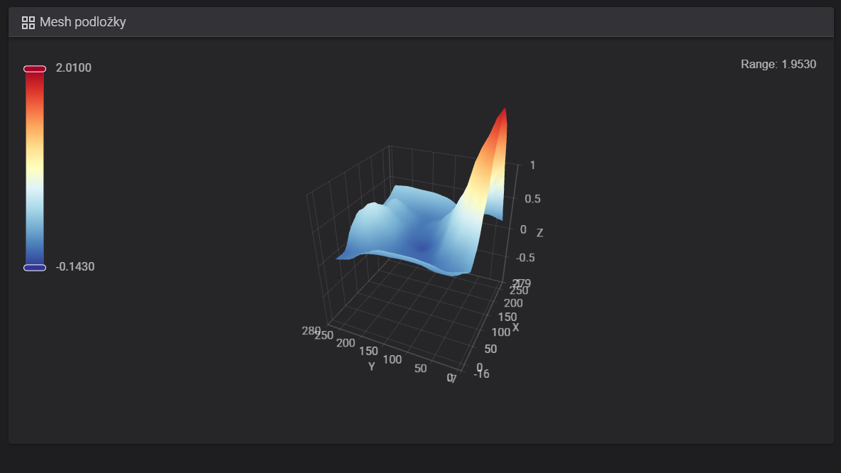

Bro i tried trick with aluminium foil. It did not go well as you can see :smiley: Even printer was tapping one spot many times like “bro, are you serious?” :smiley: Using old crumpled foil was probably bad idea.
OMG BRO WTF HAHAHA, if you can avoid aluminium foil.. good!, but i cant, to get the best values of my bed i must put aluminium foil
