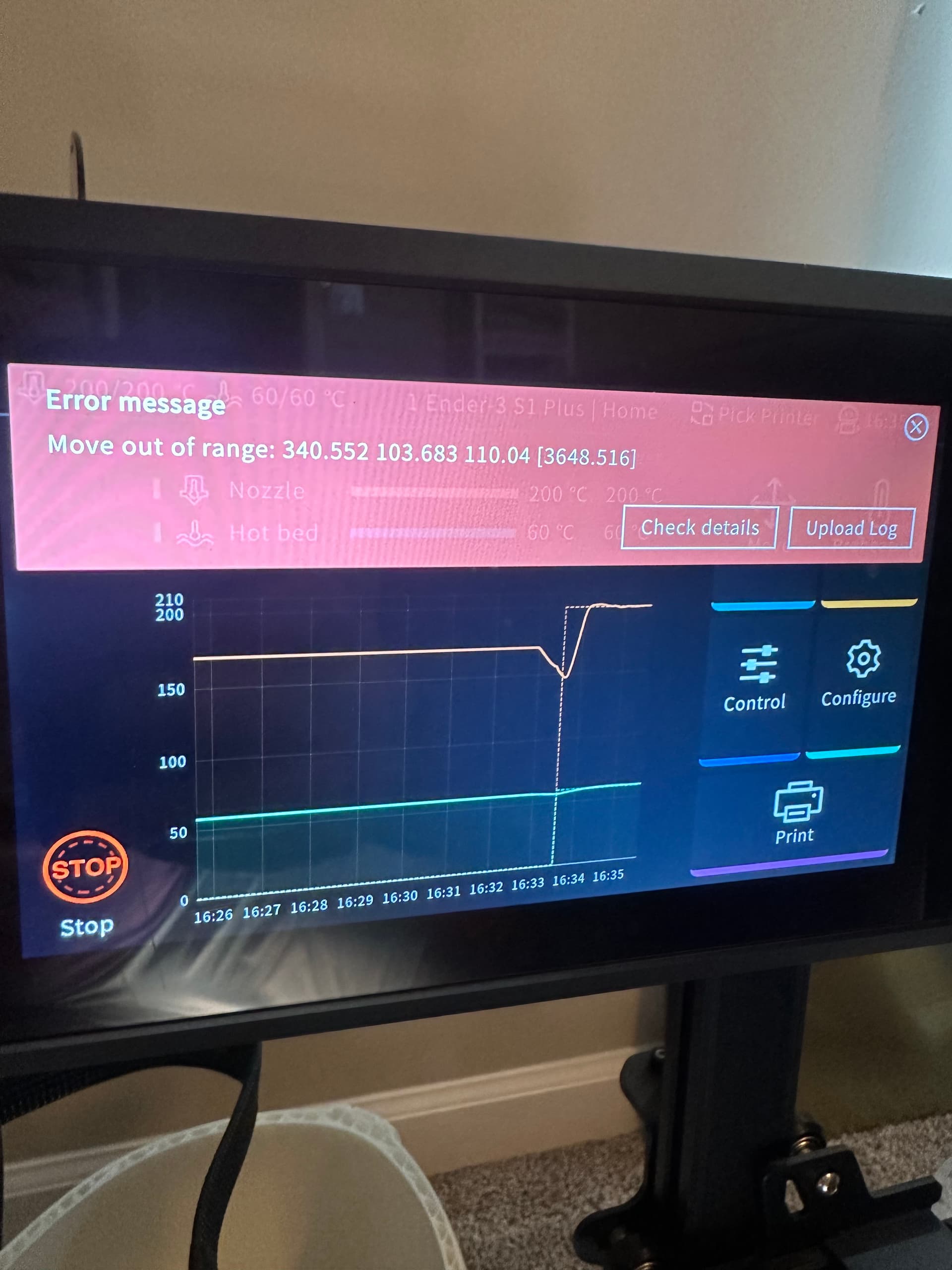

Hello, I’m running an Ender 3 S1 Plus with a Sonic Pad. I’ve been printing a large helmet for several days. It’s printing beautifully. However, at 70% complete, I started getting the Error: “Move out of range”. I’ve never received this error. I created the GCODE using Pursa Slicer. No errors, everything went well during slicing. When I got the error, I tried to re-slice using Creality slicer 5.2.1. Re-uploaded and replaced the file. Then restarted and resumed the run. I still got the error message, but the location numbers were different. So I tried again with Cura. Re-uploaded and replaced the file. Then restarted and resumed the run. Same error. I’ve attached screenshots of the errors and a video of one of the restarts.
Is there anyway to have it ignore these errors or to edit them out to it can resume printing where it left off? Thank you!!

I did also open the GCODE in a text editor to search for the coords…none are in the code. Why would it try to move where the code isn’t entered?
Most online troubleshooting points to a klipper issue solved with a reboot…but that’s been tried a dozen times and error persists.
Try looking at your print.cfg file. For some reason, the slicer pulls from the print.cfg file vs the printer settings as set in the slicer program.

Set the "position_max: " for your [stepper_x], [stepper_y], and [stepper_z] values that match your printer. (Only [stepper_x] is shown, but they all have about the same variables.
