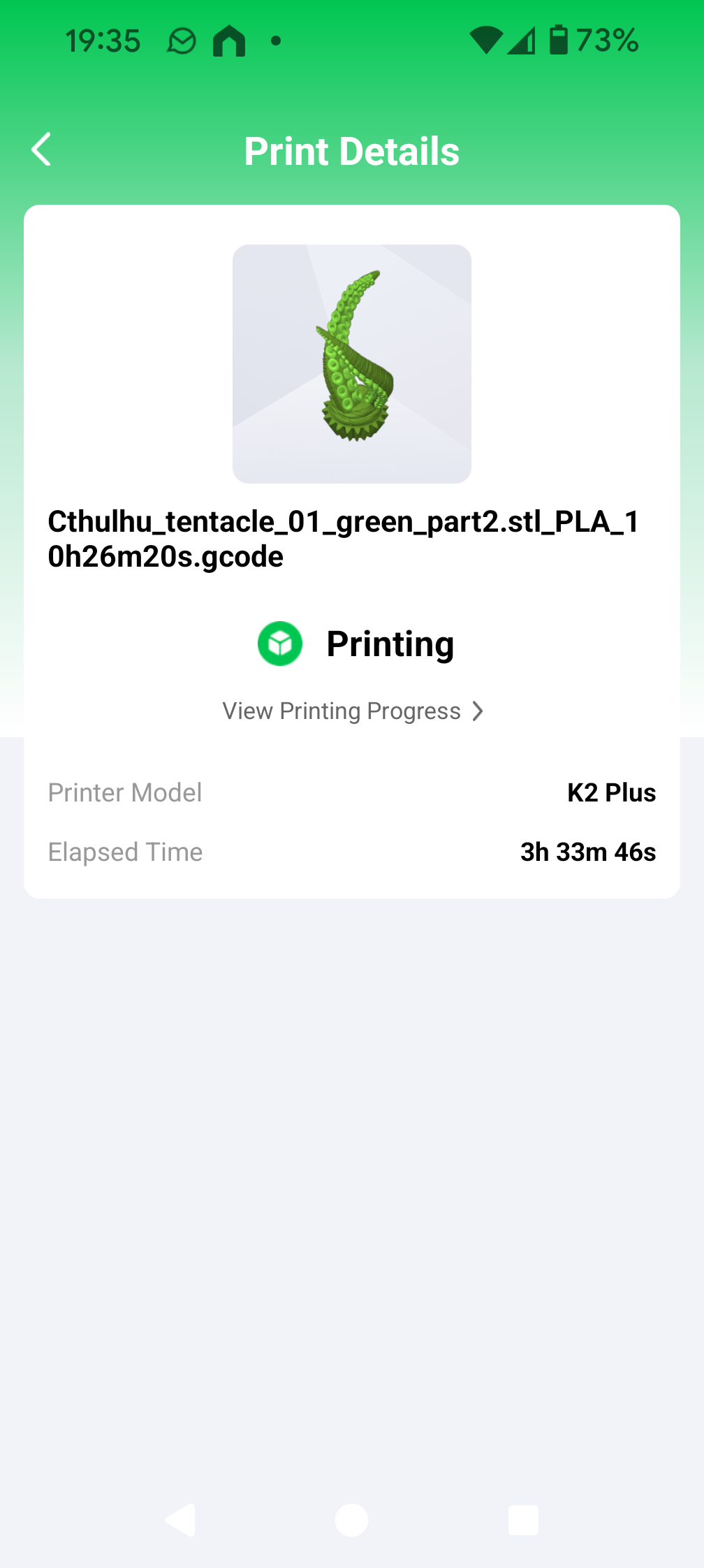

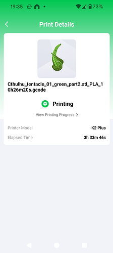

it can’t be more than 6" tall, but it’s going to take ten and a half hours to print, and I expect my waste receptacle will be kinda full too (if the &£+*#@ litter tray didn’t keep getting blocked.

Thanks for the input…the waste being generated (and the time lost as I seem to be having a night for throwing errors - the latest one being the PTFE tube popping out of the hydraulic seal on the extruder…fortunately after some previous problems they’ve already sent me a replacement extruder housing, so I’m up and running again) is huge considering the size of the part…I’d need maybe half a reel of filament to be given over just to the littler tray.

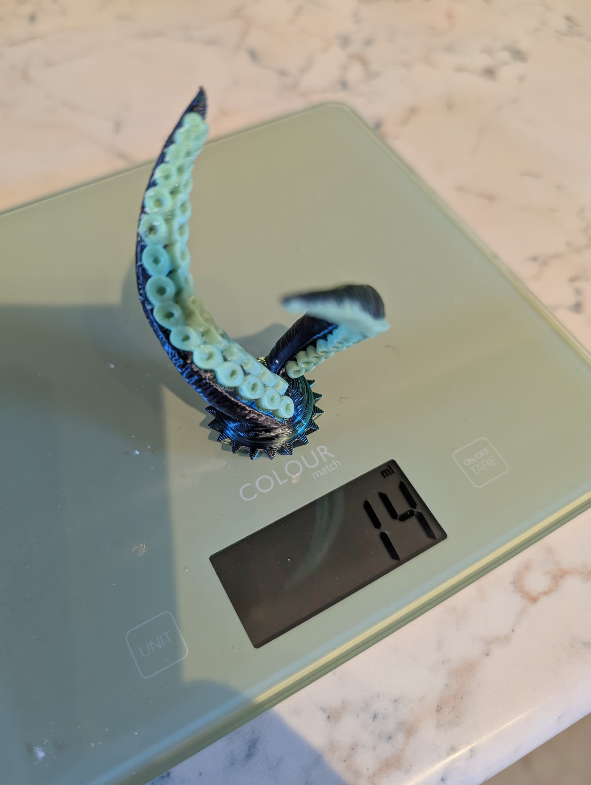

Well, I let the tentacle print finish. I am both impressed and horrified.
First impressed…because the purge tower on this print decided to go for a little walk.
Not only that the print paused due to errors at least half a dozen times (all I think symptoms of a failing pneumatic seal on the extruder housing), and yet…

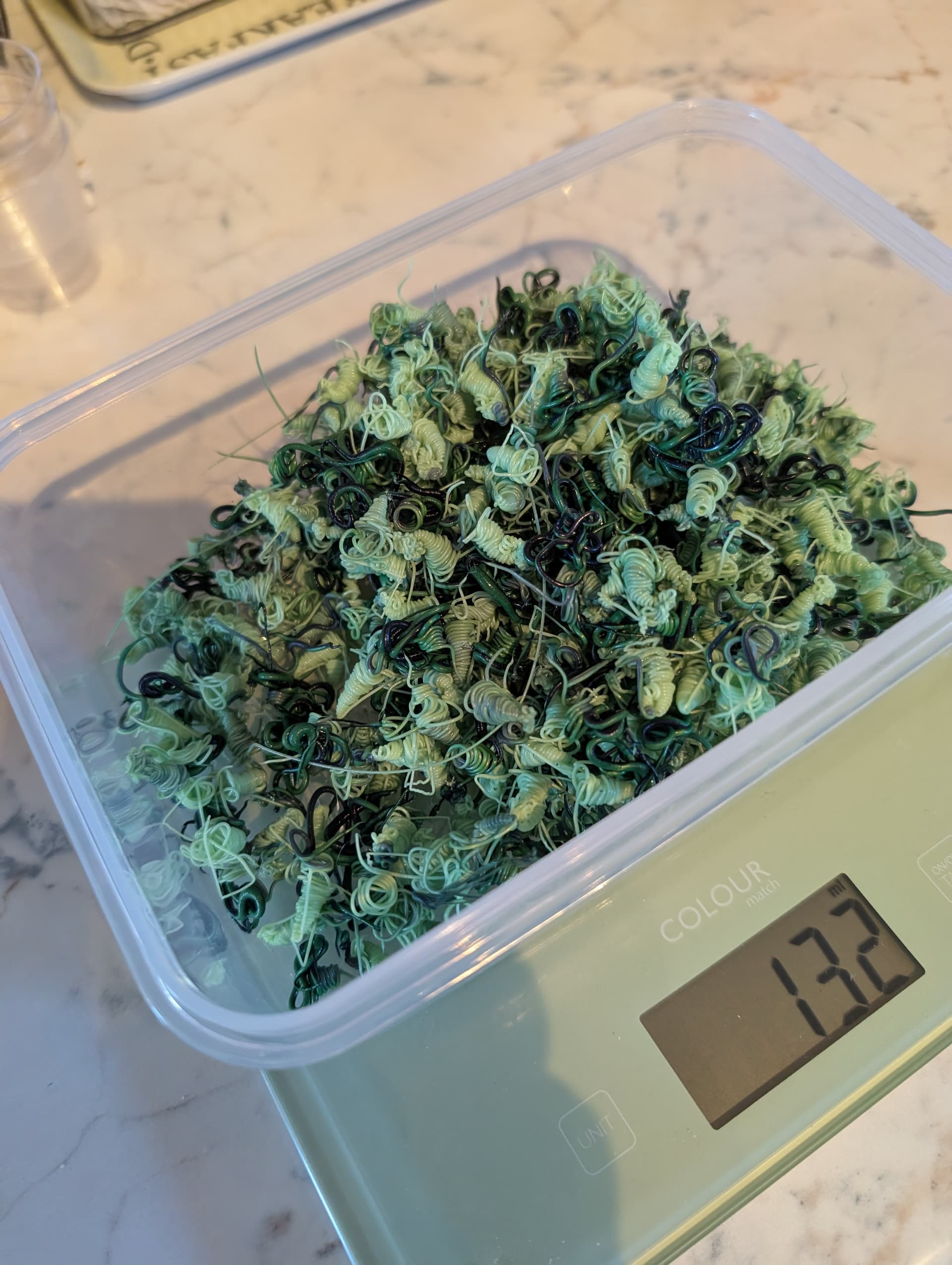

Litter tray waste 132g. Are you effing kidding me? So a 14g part generates 162g waste. Eleven and a half times its own weight, or if you prefer, the part itself represents just 7.95% of the filament used. 92.05% waste.
I’m staggered. I knew it was bad, but this…? Remember I said “remember that” a few times during the calculation?

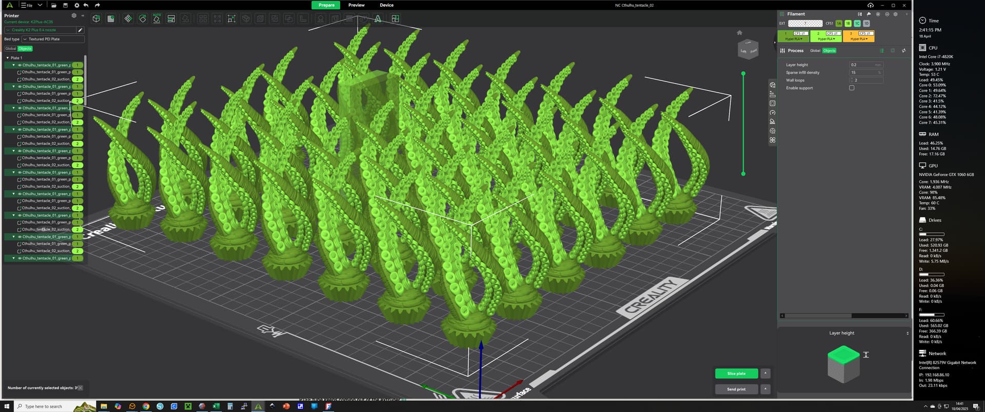

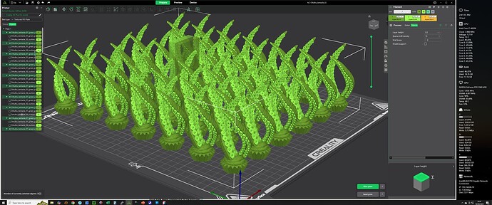

@Martin_Prent of course multiple parts will drop the impact…but let’s assume waste remains completely constant as part number rises…
Weight of part :14g
Weight of waste: 162g
If I print ten parts, then I’m at 140g product, 162g waste…so I still haven’t even broken 50:50.
In fact I just did a quick test in Creality Print and the most of those tentacles I can fit on the plate is 40…that’s 560g product and 162 g waste; still running at 22.4%.
Also…/.watch the video again and now imagine that purge tower doing it’s little dance through a field of 40 or so tentacles…nope. Sorry I just don’t see it.
…and to revel in the joy of that box bottom left, who’s only function is to tell you how many parts you have selected…go on, zoom in. Explain yourselves Creality. I’ll wait.

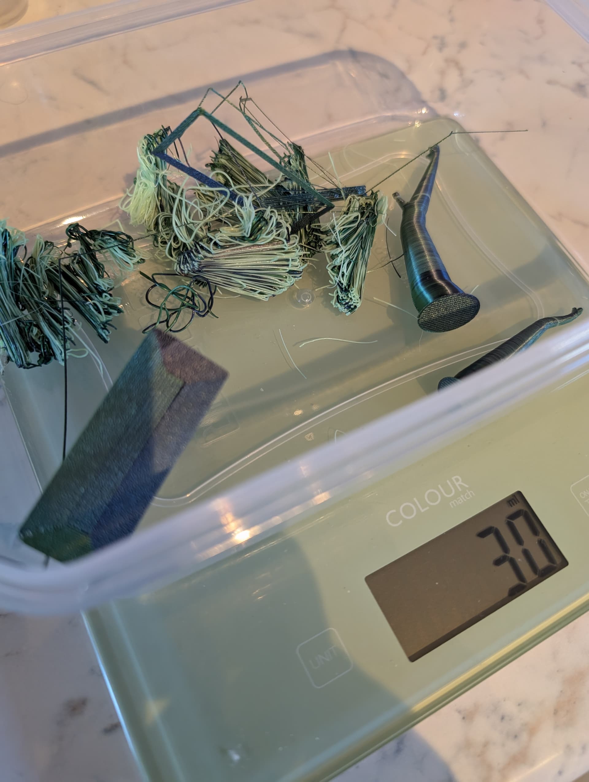

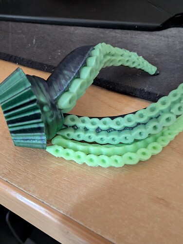

Last word on this. Just to say that even at this ridiculous waste figure, the vast majority of which is a purge designed to clear out colour contamination, it still isn’t even doing that job…I printed the suckers from the tentacles separately…

You are right, however, there are things you can do to make it more cost effective. First, always print as many as you can on the build plate. When printing multiples, the amount of waste is the same as printing one, because it only changes colors once for each layer. So if you can print enough copies, it will offset that waste. Second, you can add a model to the build plate to flush your waste into, instead of making waste. This model will be random colors for each layer color swap, but if you make something that you will paint later, or doesn’t need to be color coordinated, it can save all that waste. I always add a little Godzilla and flush into that, and then I sell them for $5, and people seem to like the random colors, or I will hit them with a few shots of spray paint for a solid finish. Printing a single model in multicolor is a huge waste, but if you are trying to monetize and sell the prints, quantity is your friend.
How do we know the number of objects that you have selected? As far as I can tell, you selected the front and the right and the left objects.
Did you see the waste stay the same?
You can indeed do multi-color with very little waste. But you selected one of the worst-case examples that there could be, there’s just about a change of filament on every layer.
As to your color contamination, there’s a setting for that, just increase it. Of course that would mean more waste.
