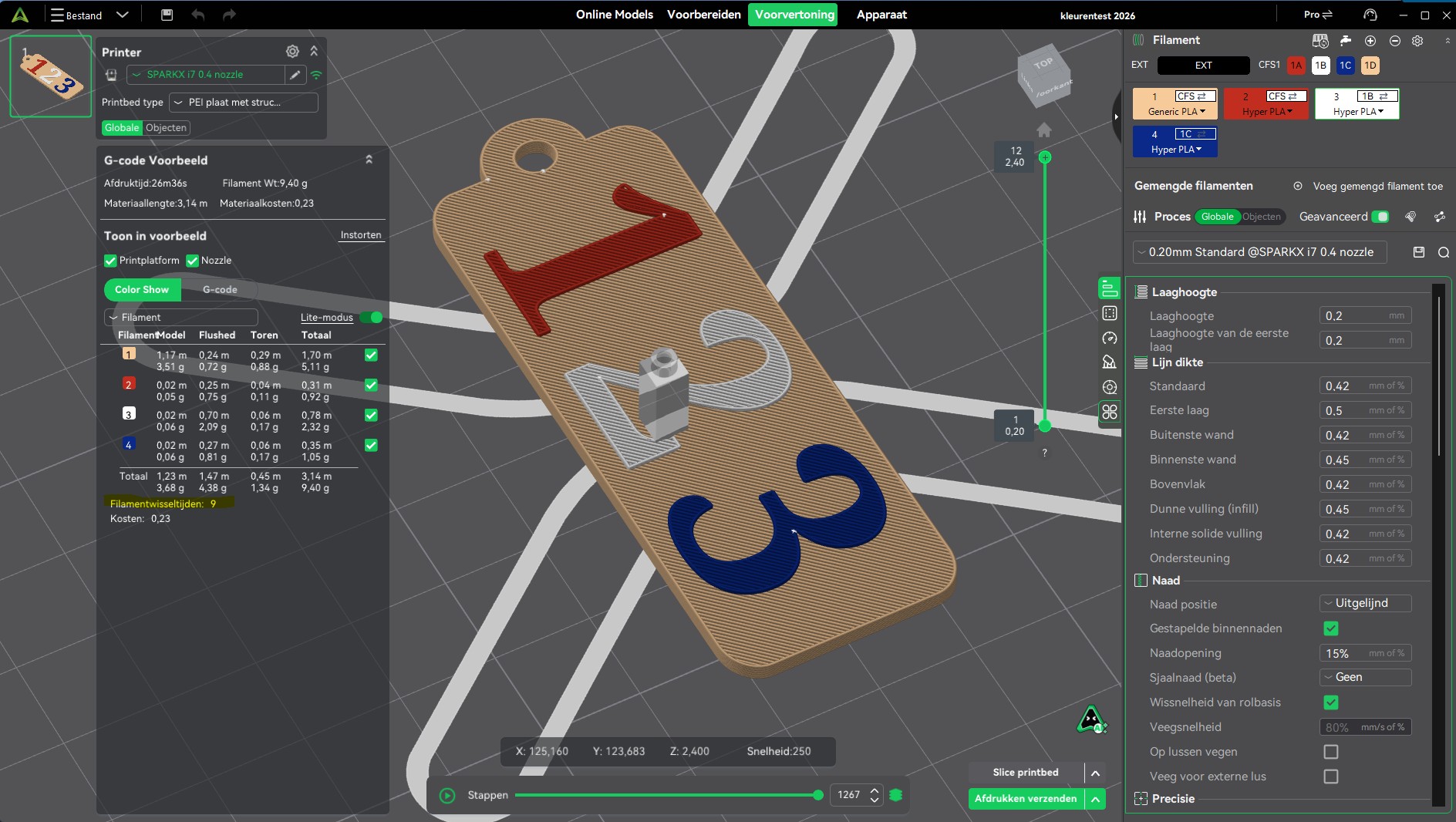

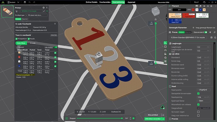

hi @alia_rifat still struggling with this issue. I have a testprint ready consisting of a 2mm flat base with on top the numbers 1,2,3 with a thickness of .4 mm (double the layer height). after colouring and slicing the result is a print with 9 filament changes. Is there an option to reduce the number of filament changes, in other words can i make a print where the base is printed in one colour first, then a filament change, then a two layer print of the number 1 in the second colour, then a filament change, followed by a two layer print of the character 2 and so on. Would save 6 filament changes.
