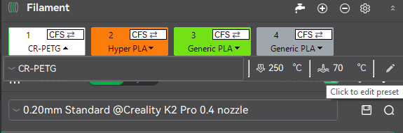

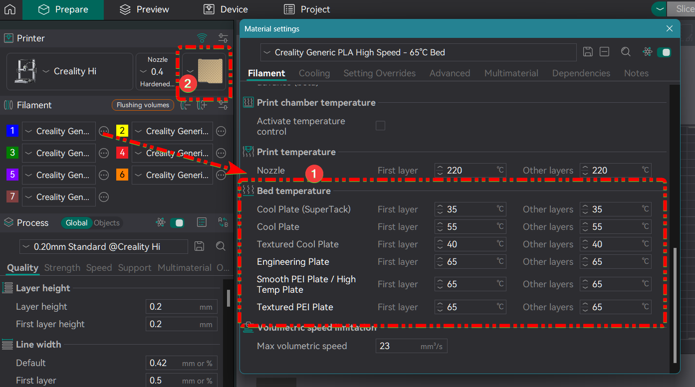

You must select on Orca Slicer a Filament with the correct bed temp.
The temps on the filament properties (1) are linked to the type of bed you select (2) when slicing.
I selected the sunlu petg which i am using, it was printing fine at first but then suddenly i started getting issues then it stopped sticking completely, I’ve cleaned the bed and tried glue it doesn’t seem to work.

thanks for the help!!! this was the problem haha
