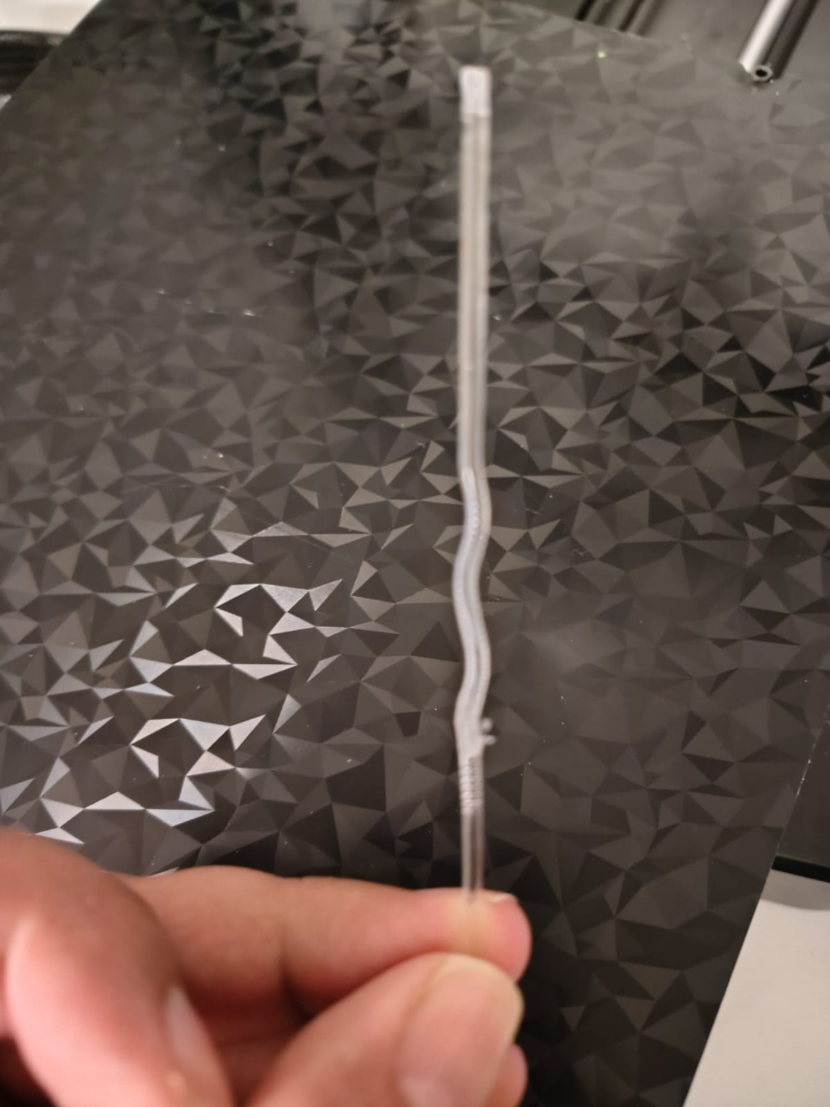

My filament is bunching up in the PTFE tube and jamming.
My filament is bunching up in the PTFE tube and jamming. See attached pictures. It looks like the extruder is trying to force more filament into the nozzle than it can melt.

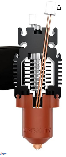

I would suggest this “could” be heat creep, the filament is softening after the extruder gears but before it gets to the hotend.
There is a heatbreak built in but it is VERY dependent on the hotend fan.

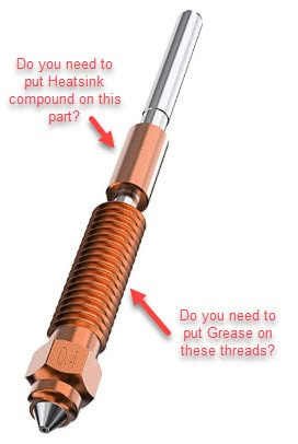

There is also heatpaste applied to ensure heat is transmitted to the heatsink efficiently, have you replaced this?

  1. This is my new (third) unicorn hotend and I replaced the whole thing (the stock one got death blobbed) and the replacement (also the unicorn) was working for a few months before this issue. Where would I apply the thermal paste? I looked at the manual and the instructions that came with the hotend and there is no mention of applying paste.
  2. I have ordered a replacement hotend fan as well. It is a bit noisy so might be failing. I had to replace the motherboard fan a few months ago because it was failing.

  1. I checked the thermal grease between the nozzle and hot-end. It was there from the factory and not the problem.
