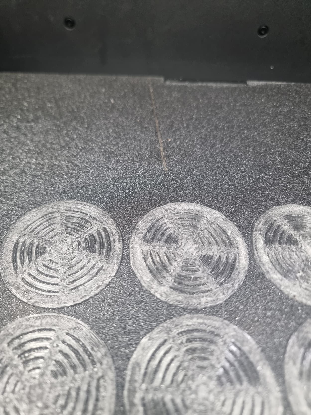

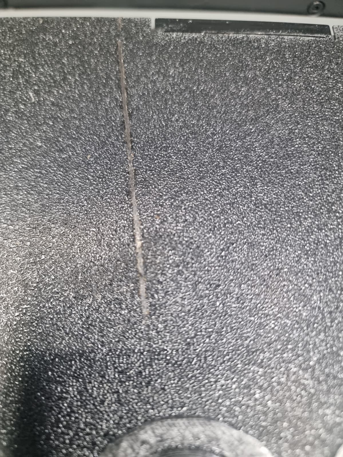

  1. Nozzle Clog & Crash
A few days later, filament built up around the nozzle during the first layers, touching and ruining the print.
I paused the job, ran the “NEW_CLEAR_NOZZLE” macro in Fluidd, then hit resume button on display.
Immediately the nozzle scraped across the heatbed at high speed, bending the nozzle and damageing build plate about -1mm scap —yet the printer logged no error.
i have used Emergency-stop in Fluidd took 2 seconds to react, by which time the nozzle was already damaged.

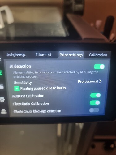

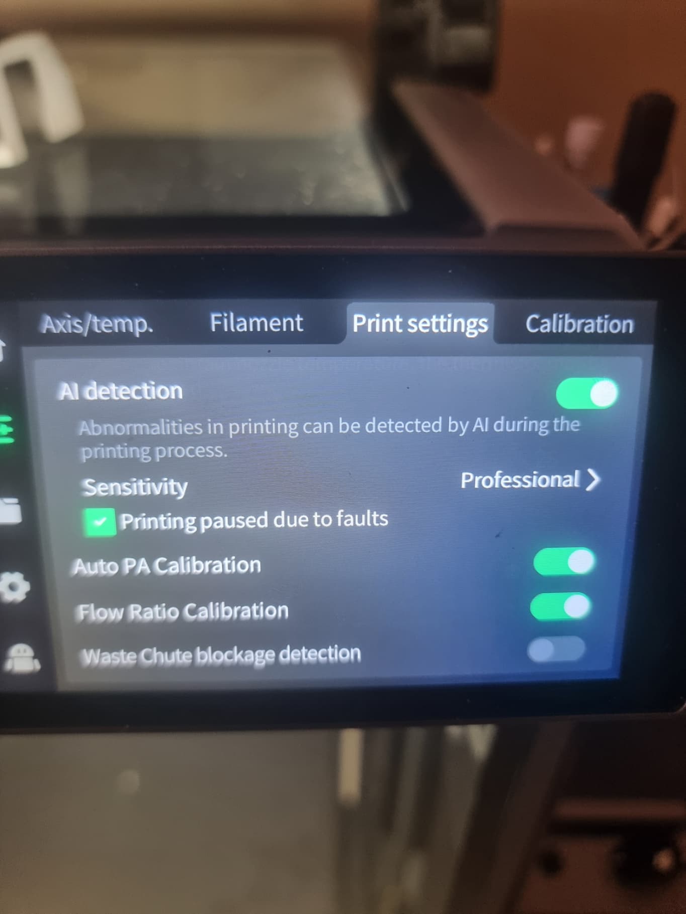

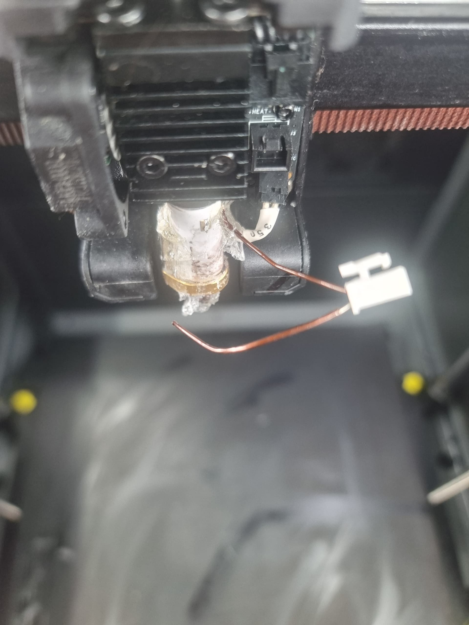

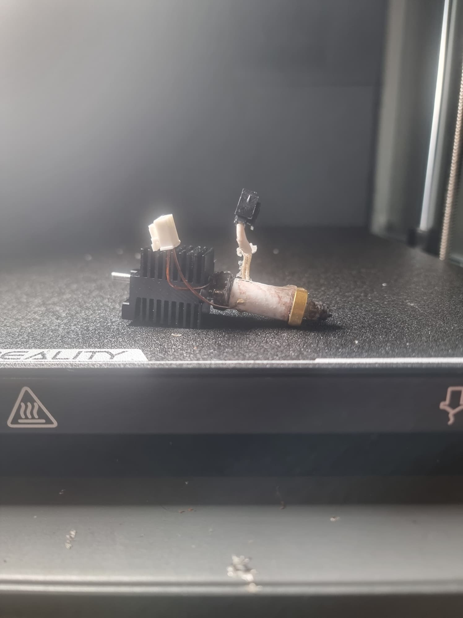

  1. Total Failure Under “Professional” AI Monitoring
I flipped the heatbed, then re-ran every calibration: input shaping, bed leveling, belt tension, and nozzle height.
I started a calibration print and fell asleep. When I woke up, there was no model—just 150 g of PETG wrapped around the nozzle and extruder.
The “Professional” AI quality-check (supposed to pause every 15 seconds on errors) did nothing.
It ran over 65mins, extruding filament into its self endup whit huge blup of petg filement all over nozzle and extruder, i tried to heat nozzle to 250c to remove the blub of petg but i damaged the sensor wire, lucly i found that on amazon for 35gbp same day delivery and ordered,
what pissed me off most is that when i report this first to support whit out realising that nozzle is bend after the print pause resume > build plate damage, they told me its user fault, at that moment i wasnt even demanding anything i send them both moonraker and kippy logs . just to get told its user error and would need to pay for replacment … still waiting to hear explanation what was my error pausing print ? or buying this printer at first place ?
