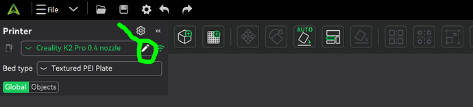

Hello @CAnnaP :wave:
If you are using Crealilty Print click on this setting to edit…
Usually the printer profiles are automatically set here so I’m wondering if something else was changed..
