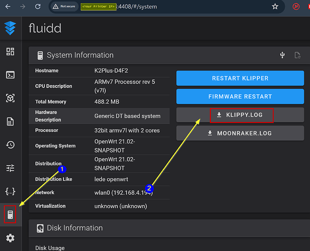

If you’re comfortable with Fluidd, download and review the KLIPPY.log. That file shows exactly which subsystem triggered the stop. If you’re not used to reading logs, pass the file to your preferred AI and ask it to identify the underlying fault. It will walk you through the steps to extract the log if needed and give a direct explanation of what the printer is reporting.
Here’s how to get access, point your browser to your printers IP address and append the IP address with a ":4408" to access the Fluidd port. Then click on the Klippy Log and save the file then upload to your favorite AI.
