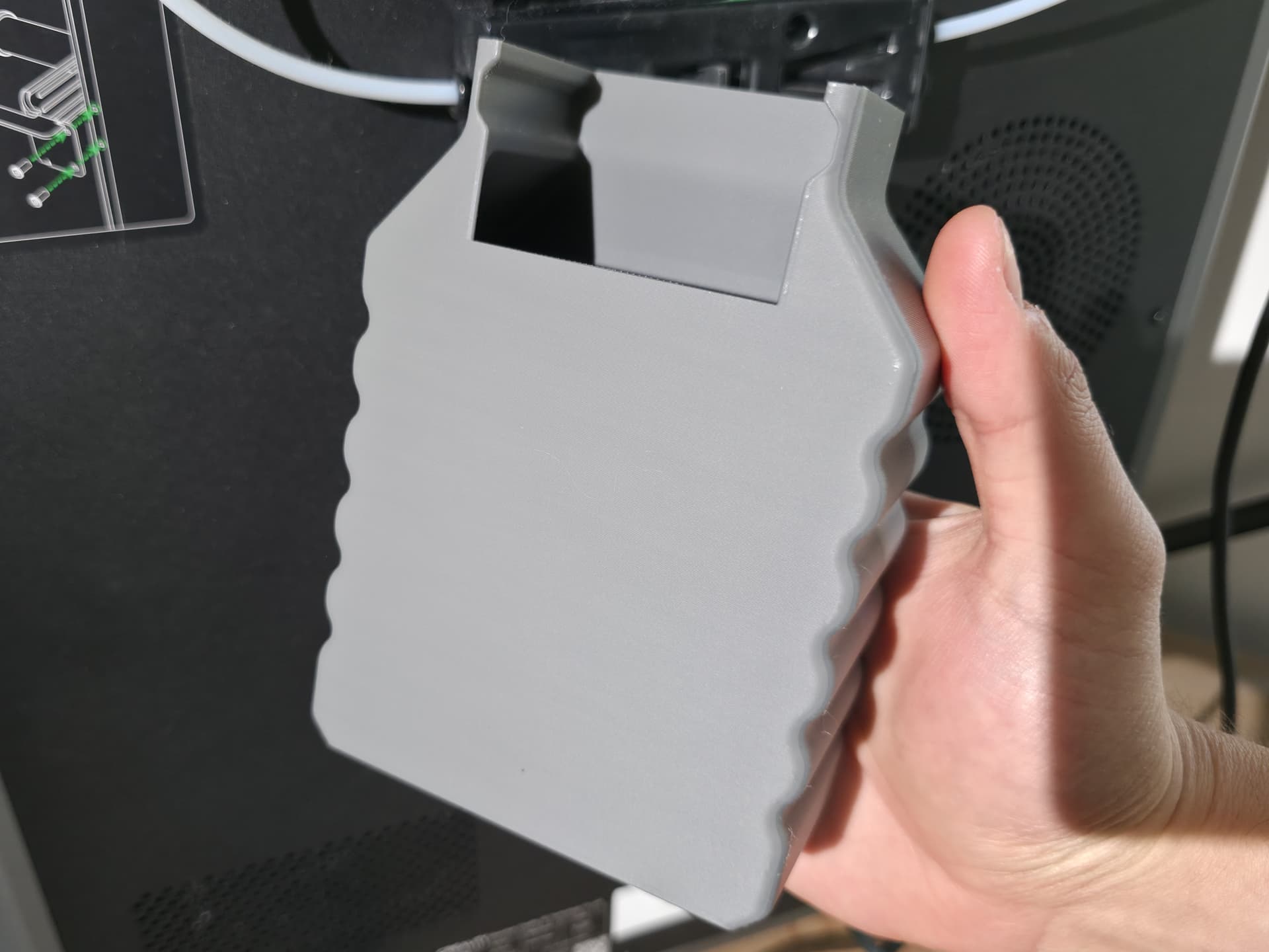

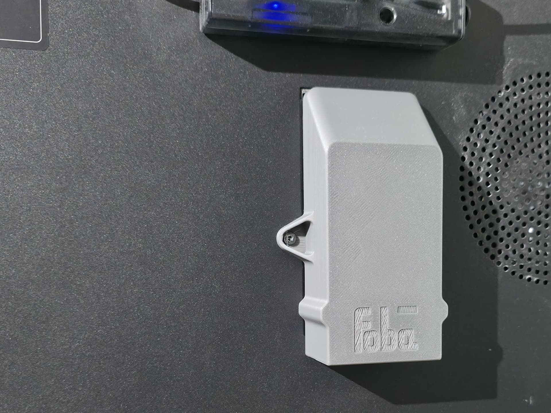

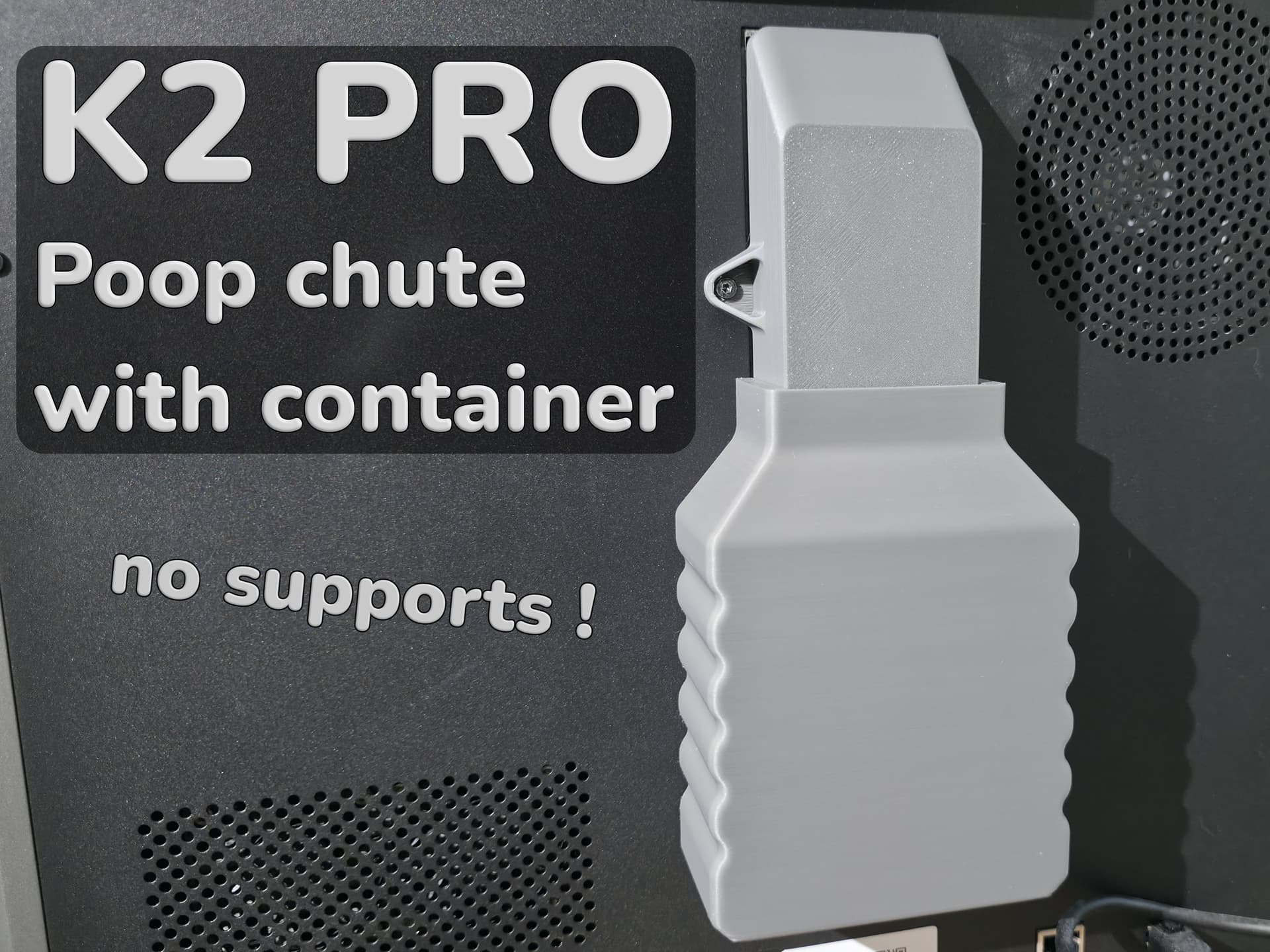

I want to share with you some of my new upgrade for K2 Pro - poop chute with waste container. I wanted to create fully closed solution using original screws and printing without supports.

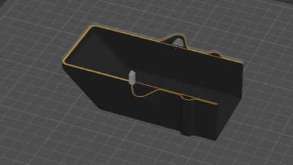

This model uses a simple but effective design trick to eliminate the need for supports.
The mounting holes are printed with a bridged first layer (intentional overhang). This temporary layer acts as a base, allowing the hole perimeter to be printed cleanly on top of it.
After printing, you only need to:
pierce the thin overhang layer using a screw or any sharp tool
That’s it — no supports, no cleanup, no wasted material.

Models are available on Creality Cloud - Poop chute with quick mount container for K2 Pro | Creality Cloud
Remember that this container is not too big and it should be maintained every few days.
