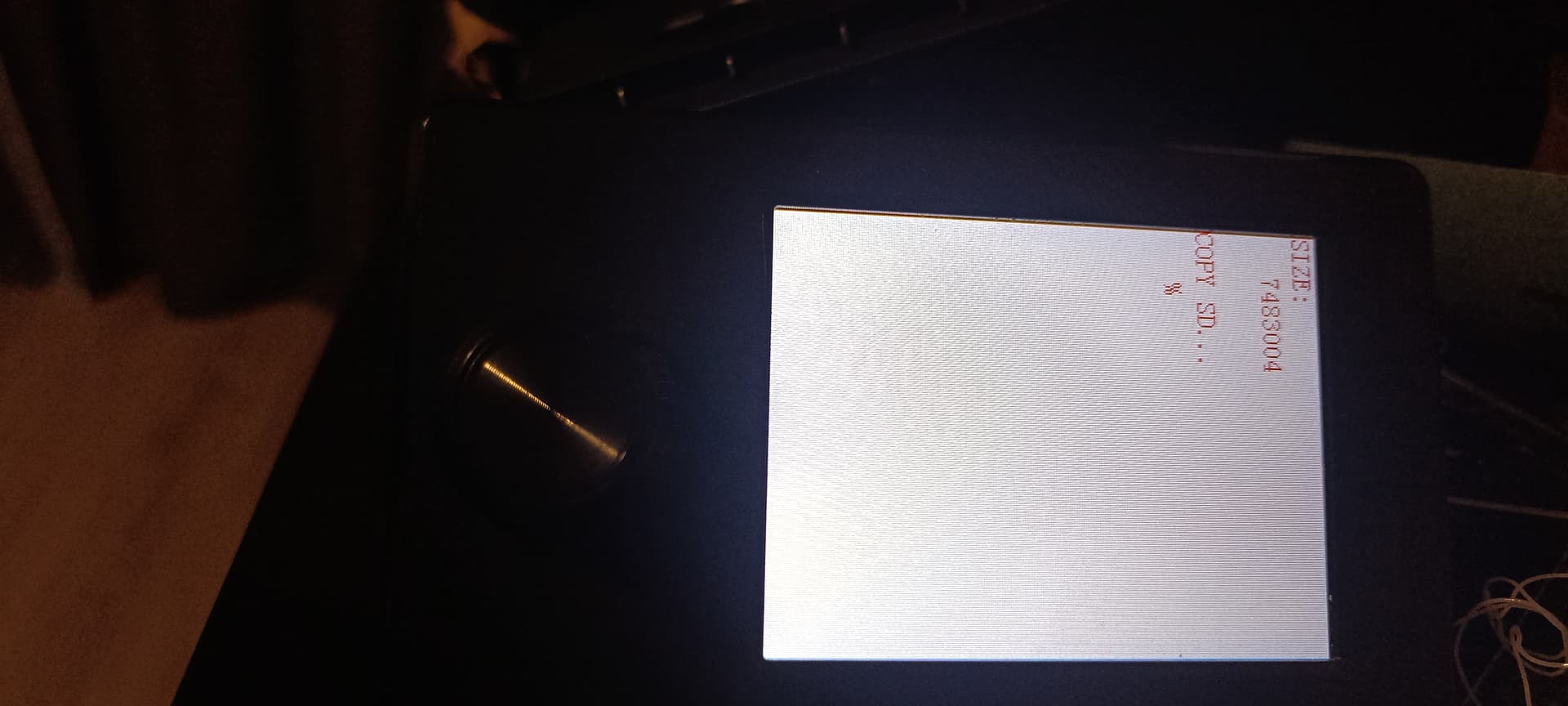

Need help. Ender 3 v3 se hardware update stuck
Screen update stuck here. Ive formatted my microSD with 4090 allocation size, dropped TJC into it and putted it incide turned off printe. It typer “update will start in 3 sec… 2… 1” And now it stuck here for about 25-30 minutes
Take the SD Card out. Restart and try again.
Next reformat the card and and then install the software.
Try again.
These happen too frequently.
Be careful on the mother board update. Check your card and software as it is very easy to “brick” the motherboard.
Tried different microSD size, different display firmware versions, different allocation size, nothing worked. Btw is it really possible to break the motherboard by just installing wrong display firmware, if it right what did i break? Printer’s motherboard or display’s motherboard?
It could be either one or both. Most likely the motherboard.
I had to replace mine to get it to work on both the SE and the Plus.
