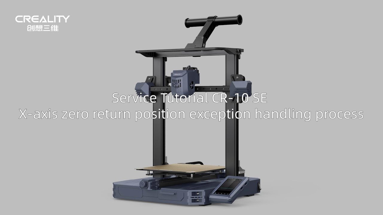

At one point I did a version upgrade so I thought maybe that’s the issue. I tried factory reset and now the printer is still stuck at the self-levelling phase. The printing head tries to exit the edges of the bed and then fails. It is as if the bed is not centered or something.
The error I get is 2022 which I understand is about the belt tension (the tension seems to be proper) or alignment (which looks like this is indeed the issue). Only, I have no idea how to adjsut the alignment. Since I’m completely new to this printer, I have no idea how to even search for the right terms here. I would really appreciate your help here.

I might have solved this. Or at least improved. I found these two service guides. Indeed, the y-axis screw was a bit loose, and I messed with the front screw as well at one point. I will try to do a real print later.
