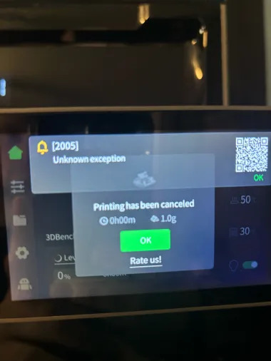

Hello everyone I need some help. I’m new to the 3d printer community. Recently purchased my K2 about a week ago. Set up everything up and it work like champ. My last print I stepped away for a bit then came back to the blob of death. I replace the block with no problem. Turned it back on to get it running again keep getting an error 2076. Couldn’t find anything about the code online. Decided to do a factor reset to see if that would solve my issue. So I recalibrated the machine and try to run a test print with a boat. Now I’m getting another code 2005. Please can any help with suggestions or lead me in the right direction. Please and thank you.

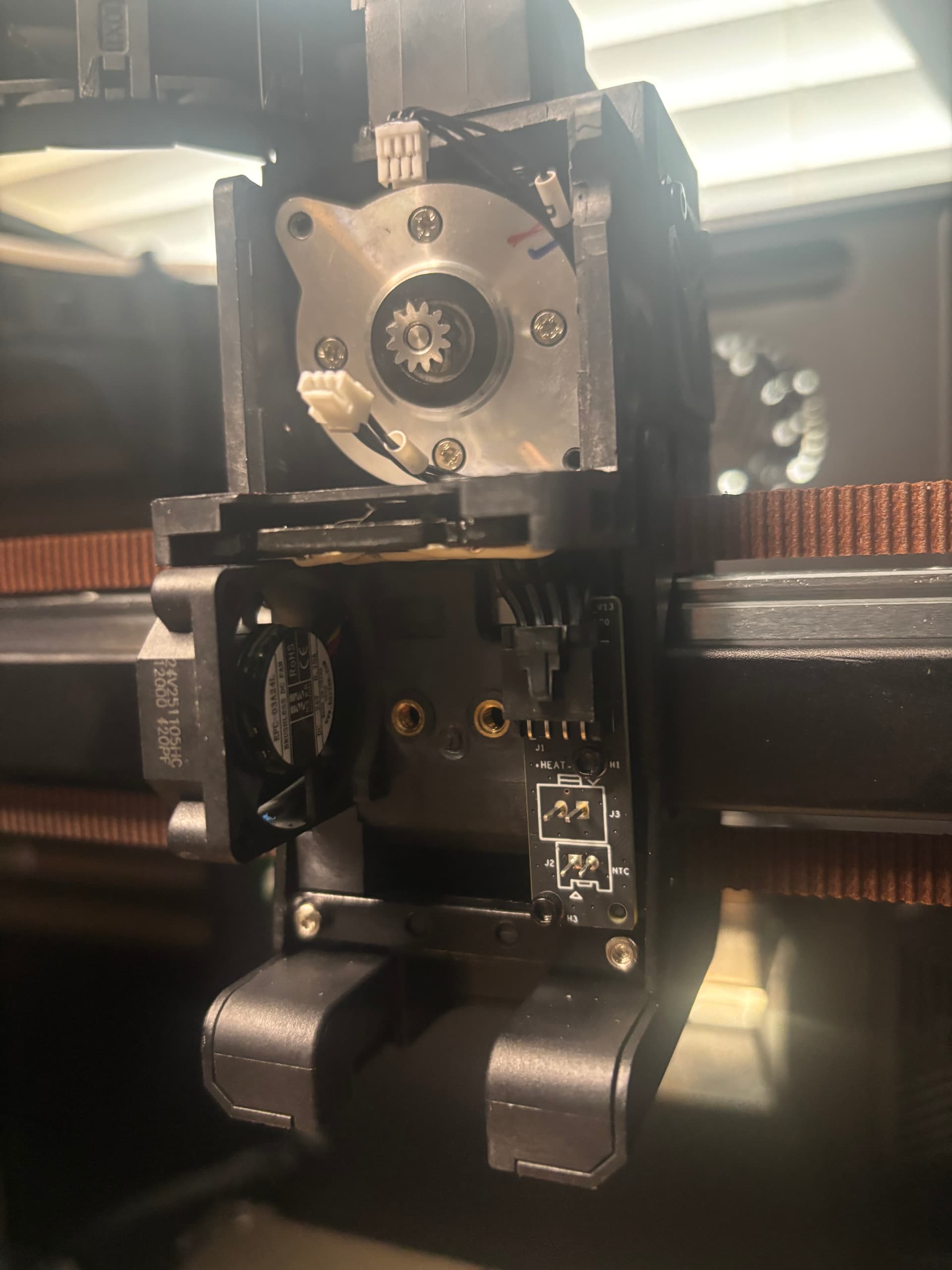

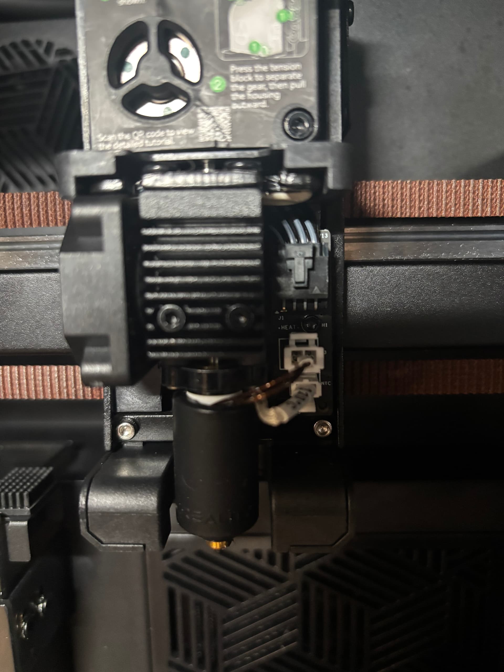

Here is picture of the take down. Does anything look off? thanks for your help
Thanks Alawhie, here is a picture of the takedown does anything look off? Going to put back together and calibrate again. I do have videos but it wont let me post on here.

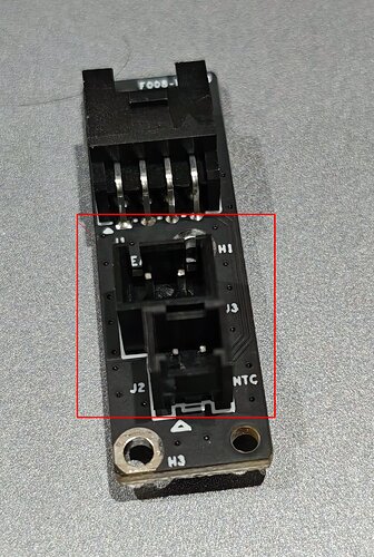

i would replace the circuit board that the heater and temperature sensor plugs into . from the picture you have supplied the connector housing for both has come away when you removed then. The new connector would not lock in correctly.
