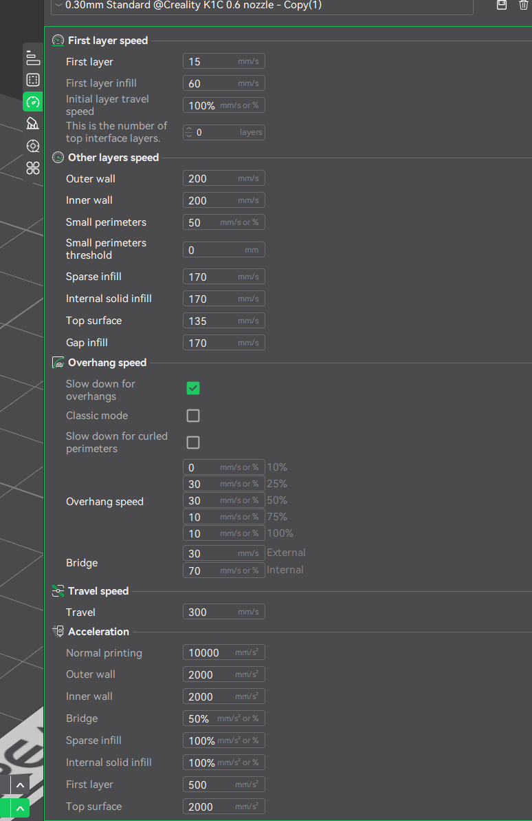

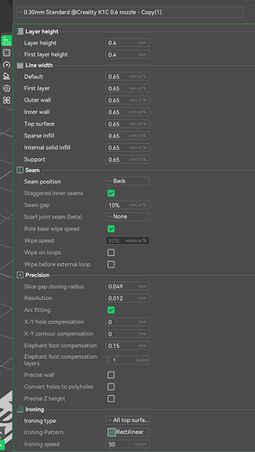

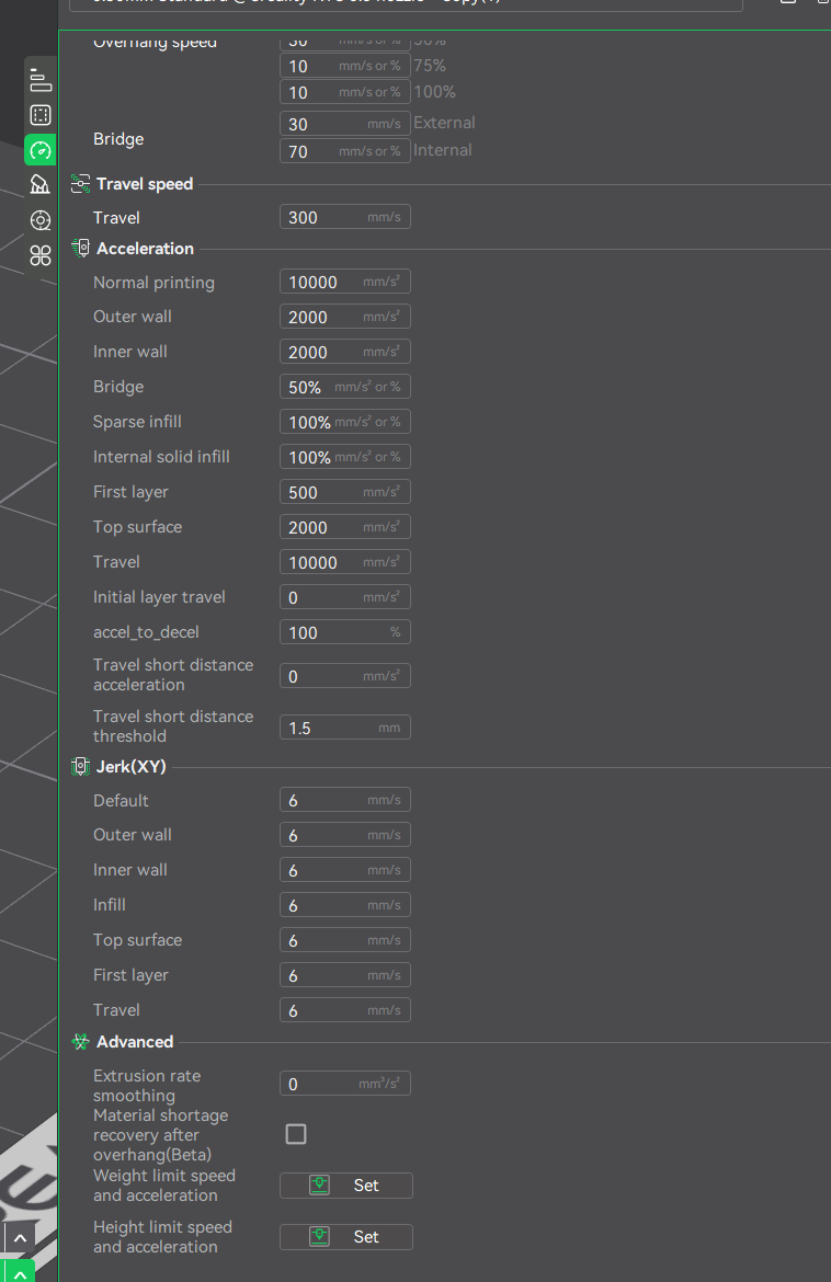

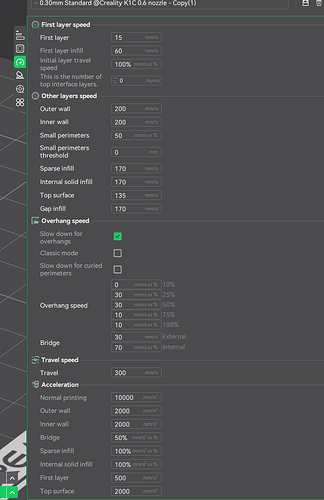

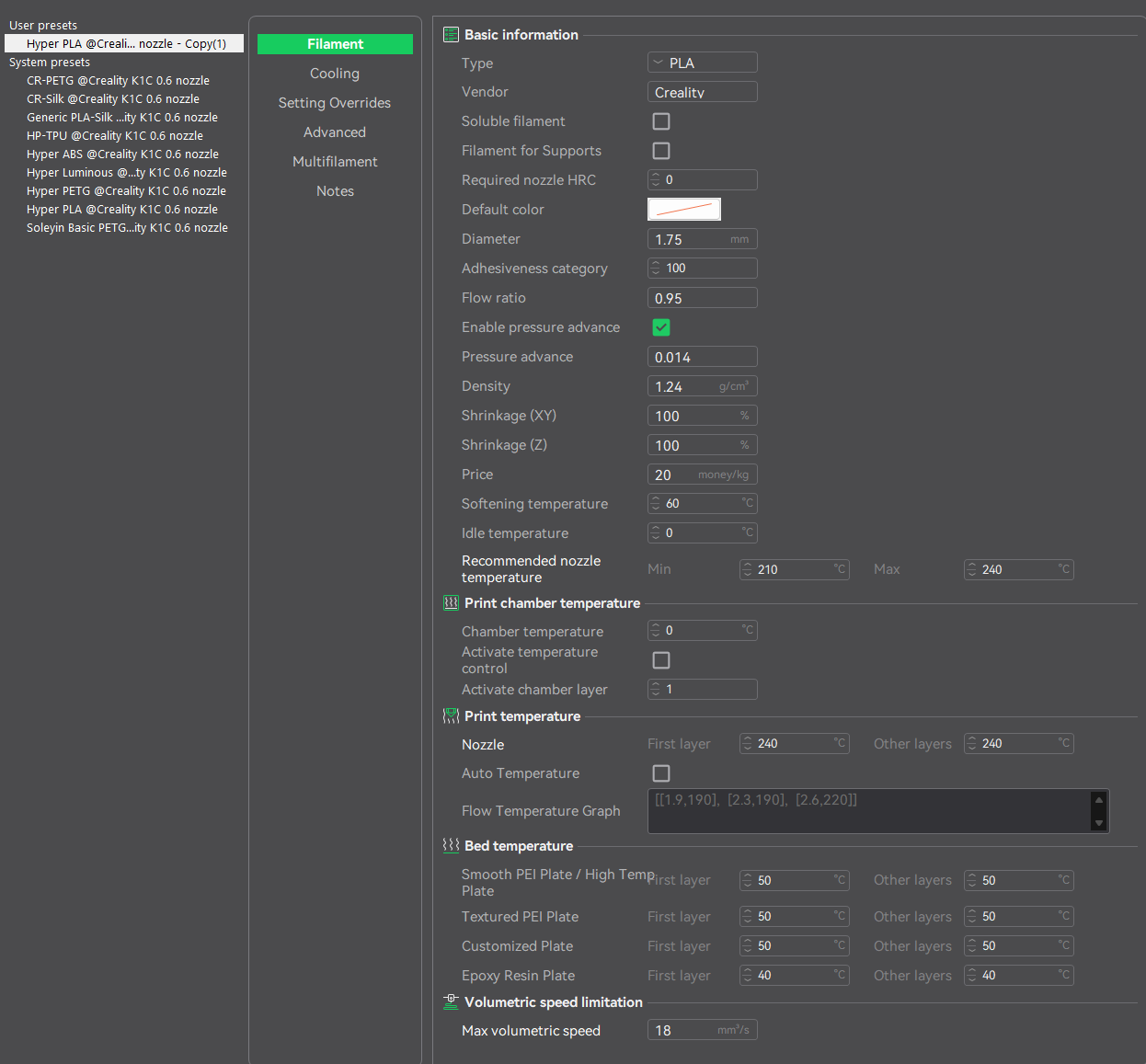

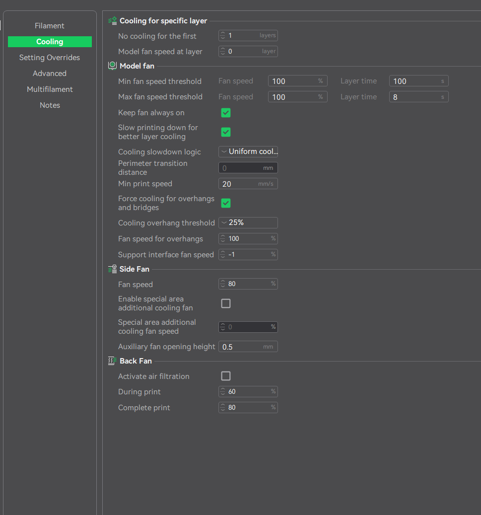

need help setting my printer to print Hyper Series PLA Carbon Fibre
I’m having trouble getting a successful print off my k1c printer with 0.6 nozzle.
it keeps failing to place down the first layer and stop the flow of the filament.
I have try different settings in creality print and I have no luck in getting to succeed.
figure it out. I remove my top cover of my KC1 and change the system preset for hyper PLA to generic PLA and uses the wiki guide in calibration tab to fine tune my print
