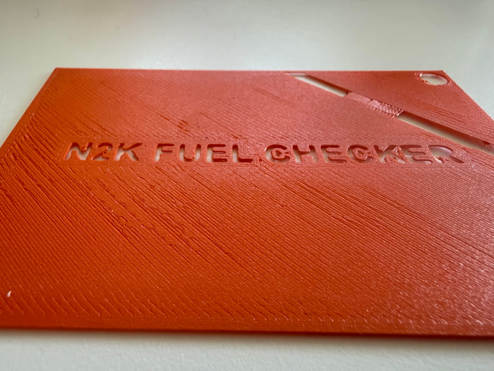

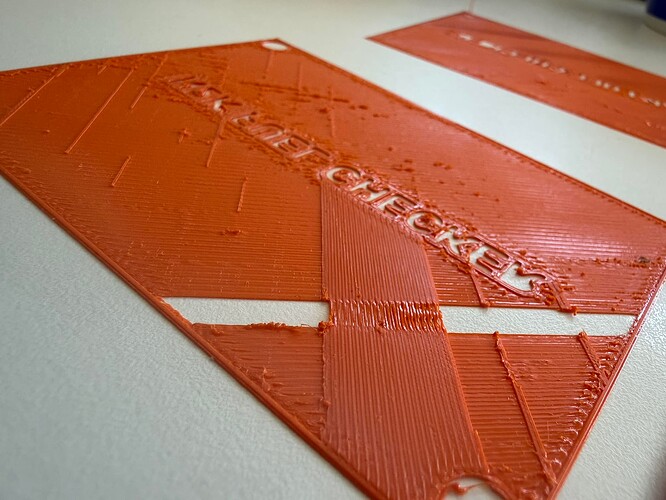

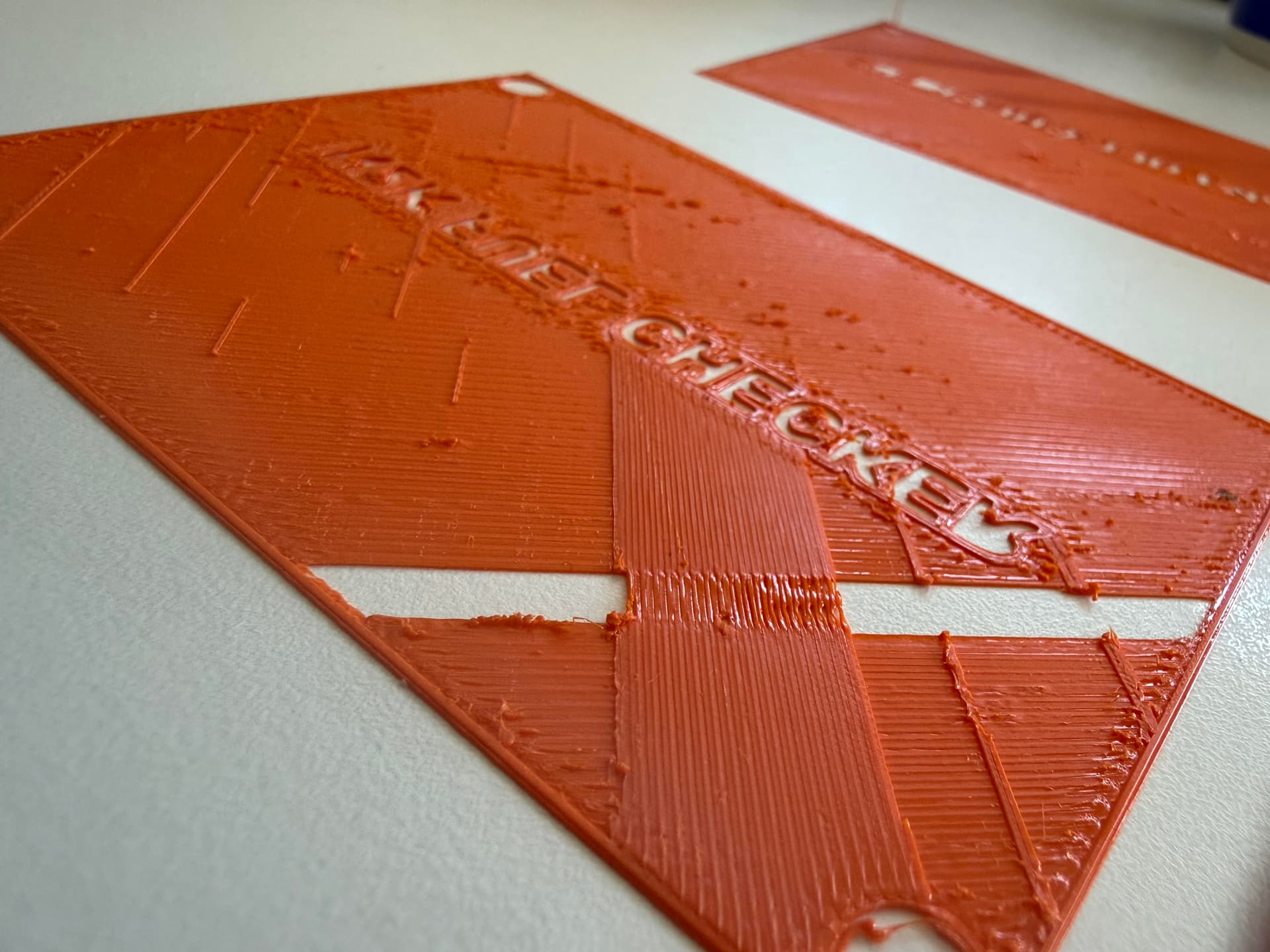

After using a 3 v3 KE for years without any mods / special settings, i bought a 5 Max. From Start, quality of prints was not very good, and became worse. Can someone with more experience have a look on my pictures, to give me Advice what to change? When i bought the V3, i had issues too, and was getting help by People that knew with one view what was going wrong. I aborted printing after first layers. The Object is a part of an enclosure and should start with a plain plate with some text.
deckel.stl (107,8 KB)
I used PETG at 240/80 degrees.
Any Advise is highly appreciated!
Did you calibrate the filament profile? This looks like at least in part a flow rate issue. I don’t have much experience with petg so don’t know if those temps are good or not, but the E5Max does have a brass nozzle which conducts heat differently than a hardened steel you might be used to. You might find lowering the temp for the brass nozzle a bit will help too.
Hi, i see these post fresh and i want to leave here my knowledge, for having near perfect layer without any mod than root is:
1st- check bed mesh for any spike or anormal bed mesh, this will confirm if you need to buy new strain gauges. If is not your case continue
2nd- it seems to make the bed mesh too fast and makes a rebounce effect, to solve that after root must change on printer.cfg
tri_min_hold: 12000
tri_max_hold: 26000
speed: 1
After this weird things stop to happen,
  1. Raise Z-Offset (+0.02mm to +0.05mm): PETG hates being squished. Give the nozzle some breathing room so it lays the filament down instead of plowing through it.
  2. Drop Flow Rate (95%): Cut your extrusion multiplier/flow down by 3% to 5%. This stops the nozzle from dragging through excess material on the next pass.
  3. Slow Down (15-20 mm/s): Drop your first-layer speed way down so the layer actually has time to stick.
