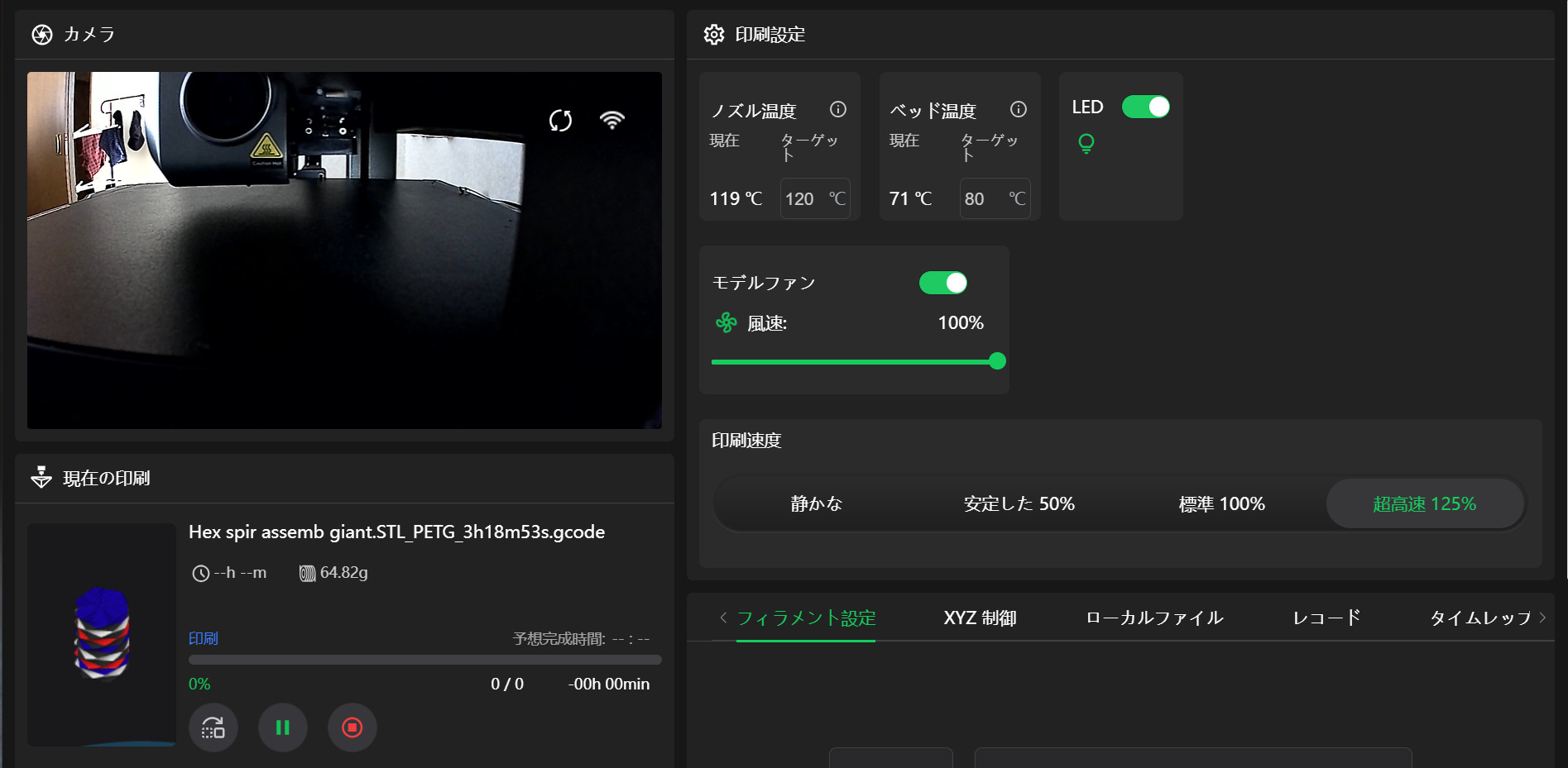

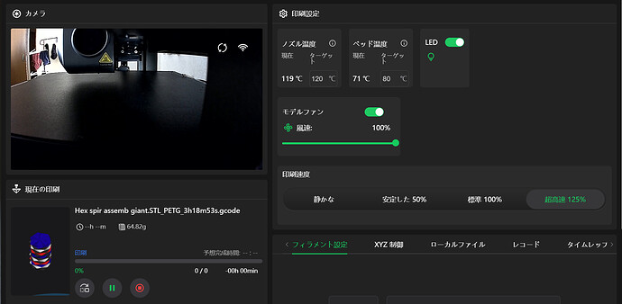

i only have a working camera in the phone app after the .72 update but the cfs reports supplirs running out when all spools are 50 to 90 % full.
yeah CFS is a lot quieter indeed, but im also having the camera issue… sometimes it works when on the website port 4408 but most of the time it doesnt, in creality print camera is not working anymore…
I have been aware of this issue since the last update killed my cam the Hi cameras seem to work in the browser at [local host] :8000/webcam/?action=stream , my K2 on browser or Orca just shows a white screen. Creality is still using :8000/……. But they are using a more secure transmission which I like. But it would be nice if we had access to share if we wanted to . Let me know if :8000 works for you. You can jump back a couple of updates and your cam will work again.
最新のファームウェアー074にすると問題解決しますよ。ただ、USBの手動でのアップデートの必要があります。
