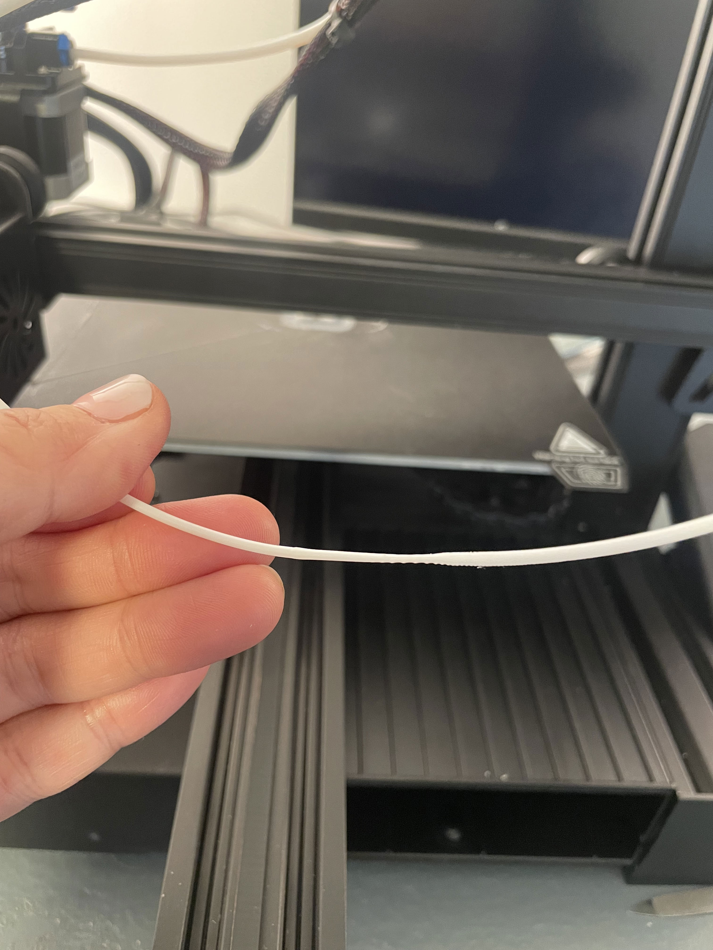

Hi, everyone! I’m running into some challenges getting my Ender 3 v2 Neo up and running. I’ve never successfully completed a print.
What’s happening:
It prints a great base layer, good adhesion. It prints about half successfully. Then, it suddenly stops pushing out filament. The extruder wheel is spinning, so it’s trying. But, almost nothing is coming out. When I pulled out the filament, I noticed there is a narrow section about 3 inches from the end of the filament. It’s as though that portion is melting or being stretched out before it gets to the tip of the nozzle.
Video of failing print
Photo of filament
Photo of half print:
What I’ve done so far:
  • Leveled several times
  • Adjusted the z-index several times
  • Checked for clogs (none exist = when I manually feed, the filament comes out perfectly)
  • Calibrated the e-steps
  • Adjusted speed down from 100% to 90%
  • Tried printing a known good model (the included rabbit model)
  • Reformatted the SD card and rebuilt the gcode files
I’m at a loss. Any suggestions? Thanks in advance for your help!

I have the same issue, tried upping the heat, slowed the print speed. The heat block gets crimped from the mechanical extruder pushing, heat melts the center core which prints with a very fine thread. Then stops. Nozzle is likely blocking but raising the Z level makes no difference. I backed off the tension on the mechanical extruder so it wouldn’t jam the filament so hard. I
have become a wiz kid at disassembling the whole extruder and reassembling it super fast, Again works for a while. I have ordered a replacement extruder.

Start your first layer and adjust your Z offset until the filament sticks, this is quite tight but seems to work.The danger is backing up the nozzle and heat block. After the first layer is down, back off the Z offset at least 4 one hundreds, causing the nozzle to rise and flow easier. It’s still tight but won’t scrub your work. For me it continued printing until done.

Update: I may have solved my issue. I have upgraded the extruder (Amazon.com), the hot end (https://www.amazon.com/dp/B0BRQF986W?psc=1&ref=ppx_yo2ov_dt_b_product_details), the filament (https://www.amazon.com/dp/B0BY1ZMCW8?psc=1&ref=ppx_yo2ov_dt_b_product_details), and calibrated everything, crucially: the e-steps (https://www.youtube.com/watch?v=3AGysy5gLQs). Now, it’s printing much more consistently. Hopefully, that helps someone else.
Kk so I got u you have to adjust the tightness of the gears by disassembling the hotbed and loosen the gears to stop from digging a dent in filament or tighten
