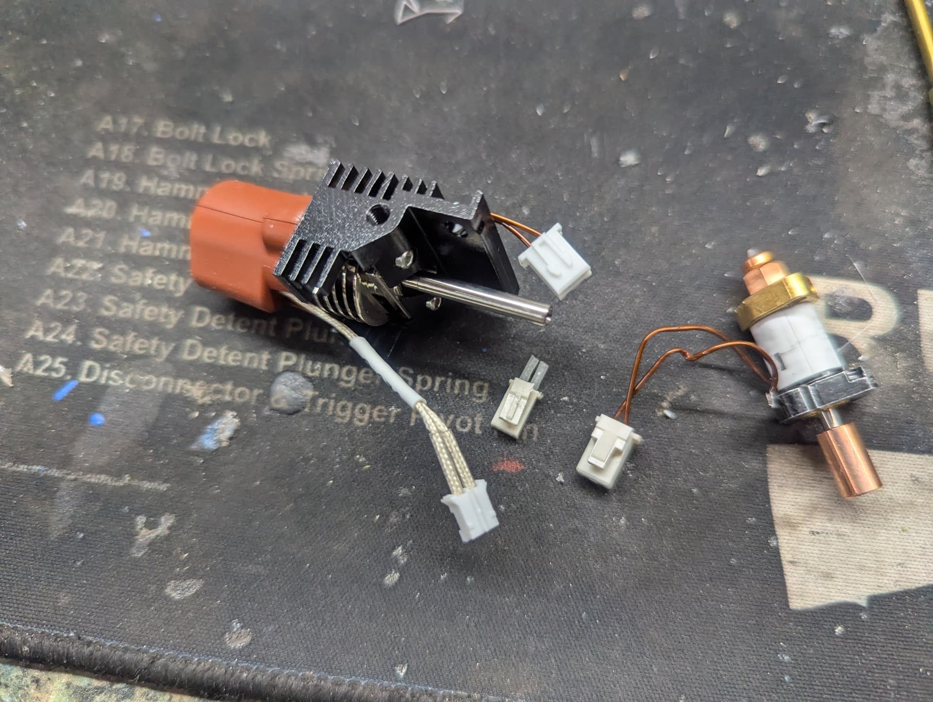

New replacement K1 hot end board connectors incorrect...! wtw
annoyed
New K1
trying to replace either hotend or hotend w/heatsink, but the connectors are incorrect…?
This is what I bought:
Can somebody PLEASE give me a correct part number or link?
see pics
many thanks

part IS available–in austrailia! While I am waiting to hear from creality (hit them up 5-6 ways) I decided to swap the old connectors by releasing the pins…you still have to trim bottom side of pins with you side cutters to fit ‘old’ connectors, but they will slide in and work…I’ll update if I find the correct 2025 hotend

I’ve contacted Creality support and gotten a ticket entered for the issue. If I don’t get it resolved soon, I’m just going to release the wires from the old hot end and resolder them to the new one
you purchased K1C and you have K1, so you purchazed the incorrect one. I swapped mine to this one, just add to change metal thermal (the one to cooldown) and from now on i use k1c ones
Microswiss has adapter cables!
I just ordered these adapters. Hopeful they will work!
