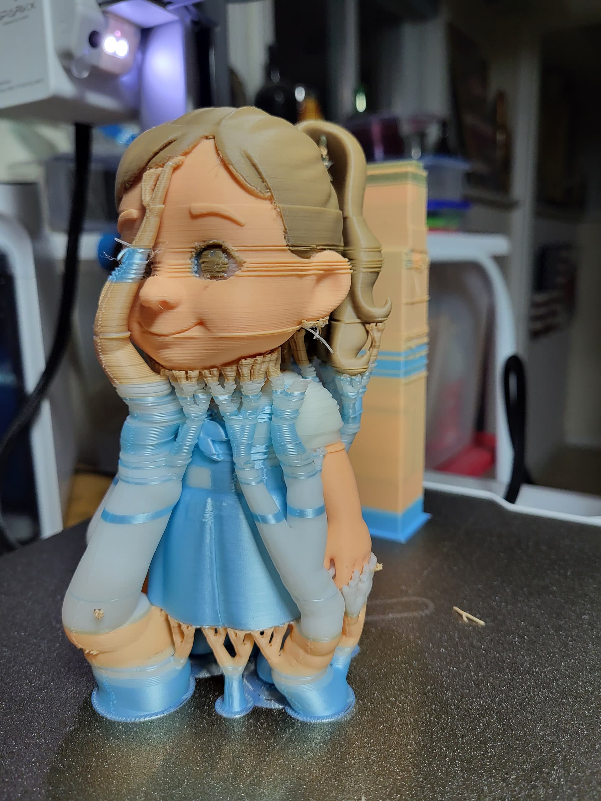

Brand New and this is my first print on this printer and I am very disappointed in the Quality it started out great then it jumped left then corrected itself and kept doing it.
That looks like layer shifts, have you used the Creality Print 7 profile for the Sparkx i7?
I wonder why it did that though, maybe you can check the belt tension if the belts are completely loose on the X axis. Otherwise it would have either needed to stall the motors or get caught in something for this to happen. Best candidate for that is the default grid infill (not sure why they chose this, that sometimes causes issues when the nozzle gets caught by the print), change the infill to cross hatch, maybe that helps if there are no obvious hardware defects.
I haven’t experienced this with mine. I would check your lead screws and make sure they are clean and lubricated and check the tension on the belts as well.
Check the belt tension. Clean and lube the lead screws and rods / rails. Another though you uploading the file to the printer or using the memory card? Possible the file or the model is corrupted? Is there any error messages pop up at the slicer?
Try to reslice the file again and preview it see there any abnormal with the model.
