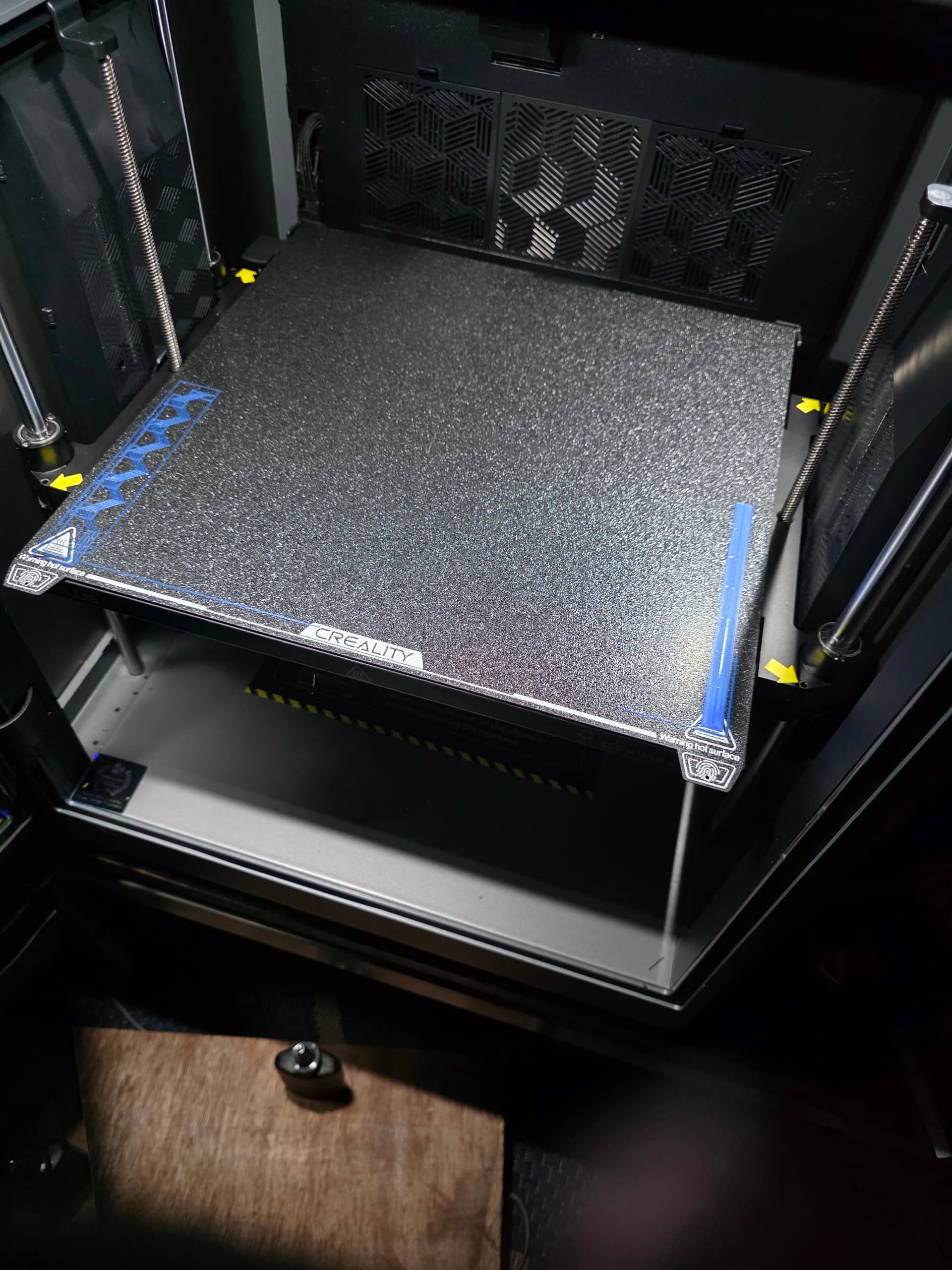

How do you get rid of purge line and the swivels line
Picture attached
If you mean how do you stop them being printed,
Goto calibration menu (next to filament menu) and disable PA & Flow calibration.
Or when you send to printer disable auto calibration button… on the screen after you hit send to printer.
But those fine-tune those parameters, if you don’t have a user profile, your prints will look worse off by disabling
https://wiki.creality.com/en/software/update-released/Basic-introduction/calibration-tutorial
Follow those instructions, to create profiles, so when you disable those lines, you still have good prints.
Edit, to get rid of the purge line you need to update your CR start print macro’s, however if this purge line is removed often the start of prints fail, due to no filament being extruded… which leads to 1st layer adhesion issues
IMO, the purge line modification should only be removed experienced users, with specific filament requirements… personally I recommend leaving the purge line to ensure the start of prints work as expected without missing filament gaps due to under extrusion (under extrusion is an understatement, non-existing filament might be a better phrase)
