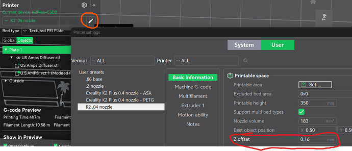

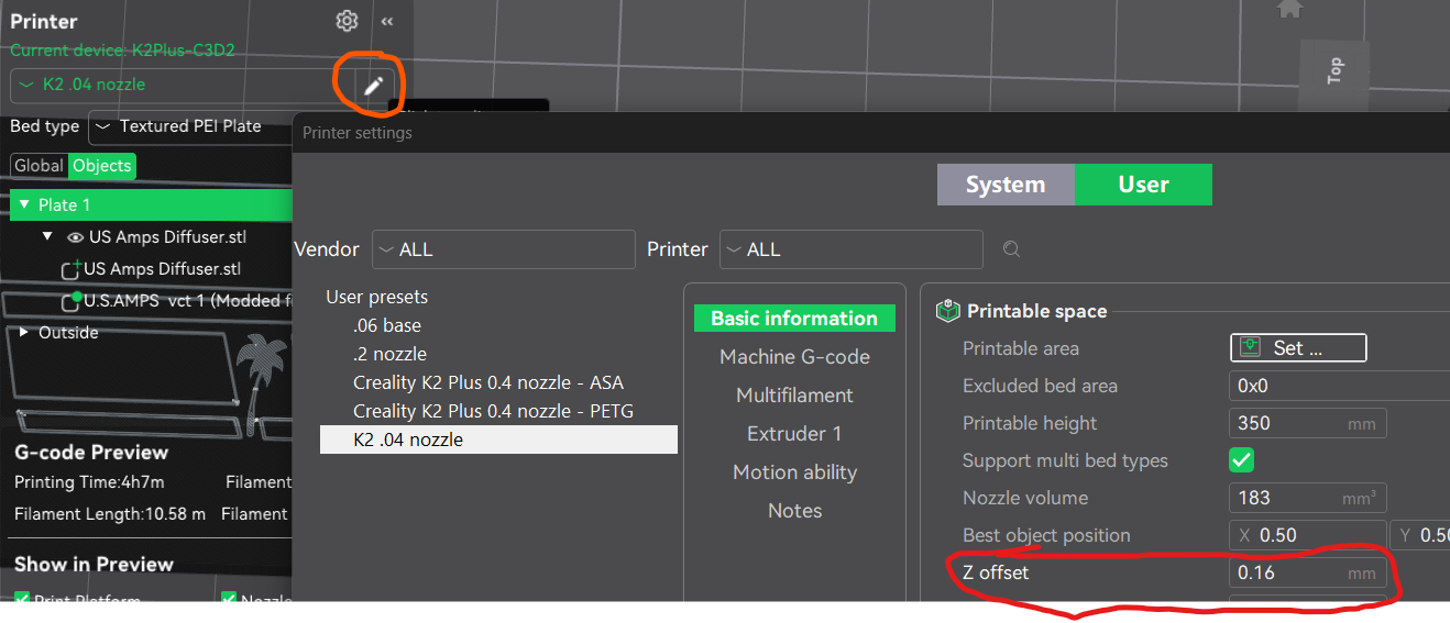

thats not what i mean.
i mean ON The Printer.
you cant Manually SET the Nozzle Height. only Adjust The Offset. which is not the same.
like with Ender 3 models, you can use the Auto Bed Level probe, OR you can Manually SET the Nozzle Height.
and still adjust the offset if need be.
Z offset can be adjusted on the fly from the K2 screen. Goto SETTINGS - EXPEERT MODE - Z OFFSET.
You can set the change value and direction from this screen.
