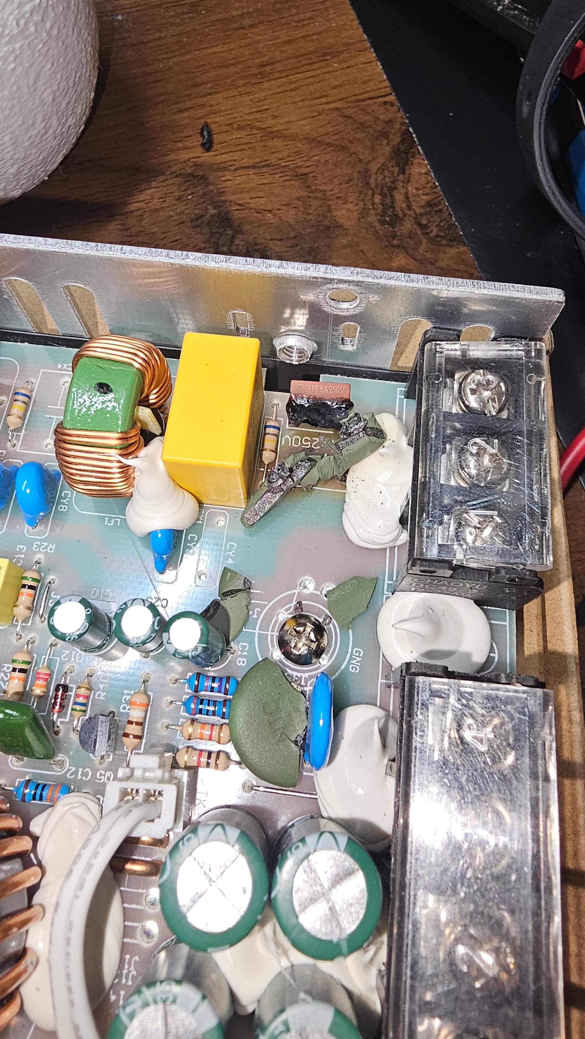

I just received a new K1Se. I’ve made sure it was switched to 115V and the machine is not getting any power. I’ve tried different wall plugs and still nothing. Has anyone else had this issue and /or any suggestion to “fix” this? Really frustrating. My apologies in advance if this is a topic that has been added already. I could not find it when searching. THANKS!

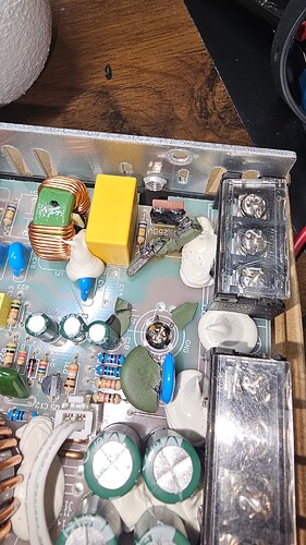

I have had mind a month. First touch screen turned on but touch didn’t work. Replaced touch screen. 1 month later machine died. If you look inside of power supply it was fried. Replaced power supply in it. Now working good.
