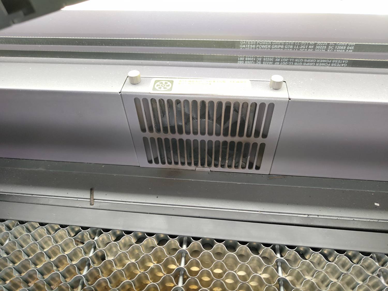

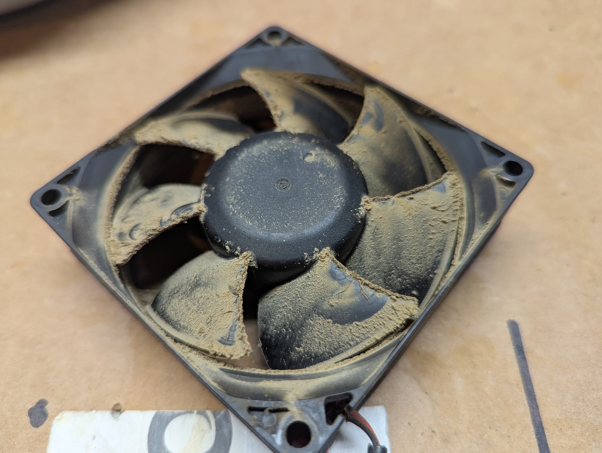

I cleaned my fan a few months back and it quieted down quite a bit from the high pitch whine it was making. It was night and day. Yesterday I cleaned my fan and was reminded how much of an impact this cleaning had again as it quieted down a lot.
To clean it, compressed air will remove 90% of this build up or a brush. Do this outside if you can, this fine dust will go airborne. Isopropyl alcohol with cotton swabs will take care of the rest.
Anything you laser produces particles that have to go somewhere.
