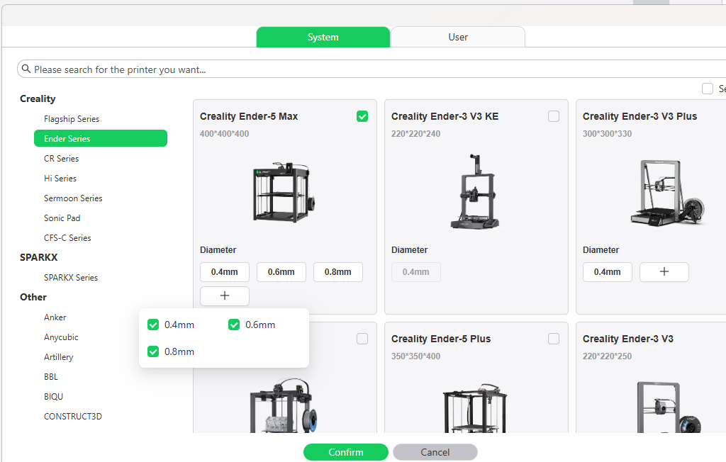

There are profiles for both .6 and .8 nozzles in Creality Print but it basically creates a separate printer profile for each. So go into add printer, ender series, then click the + to check with nozzle sizes you want.
I switched to a .6 nozzle and found I needed to do a lot of tweaking to the default profile. But it’s there for a starting point.
