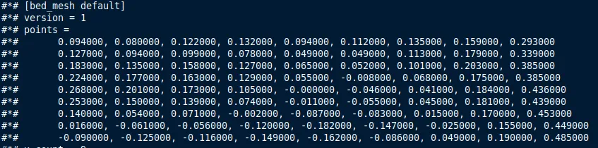

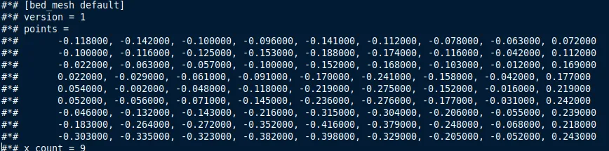

I had firmware V1.1.0.48, it was working perfectly. August 29 I have updated to V1.1.0.50, then I launched Autoleveling (after firmware update). And now it feels like the hotend is clinging to the plate. The first layer is smeared, even the logo on the plate is scratched. I ran the calibration again, the result is the same. Compared the printer.cfg file before and after - All values in levels became on average 0.218 smaller.
Downgrade to V1.1.0.48 did not bring results.
How can I fix this situation?
Was:
Now:
Updated 31.08.2025:
I look on my “flat plane” in fluidd (4408), and it looks like almost all points below the surface (I don’t have a perfectly flat table), but before update I had only a small hole.
For the experiment, I’ll raise the z-offset, and maybe play with the foil (recommendations from Z offset not saving - #9 by Teddy_G_Limanto ). But, in reality, a new good firmware is needed. Today I rolled back to “Factory settings” - did not help. Downgraded to the 44th firmware - did not help.
