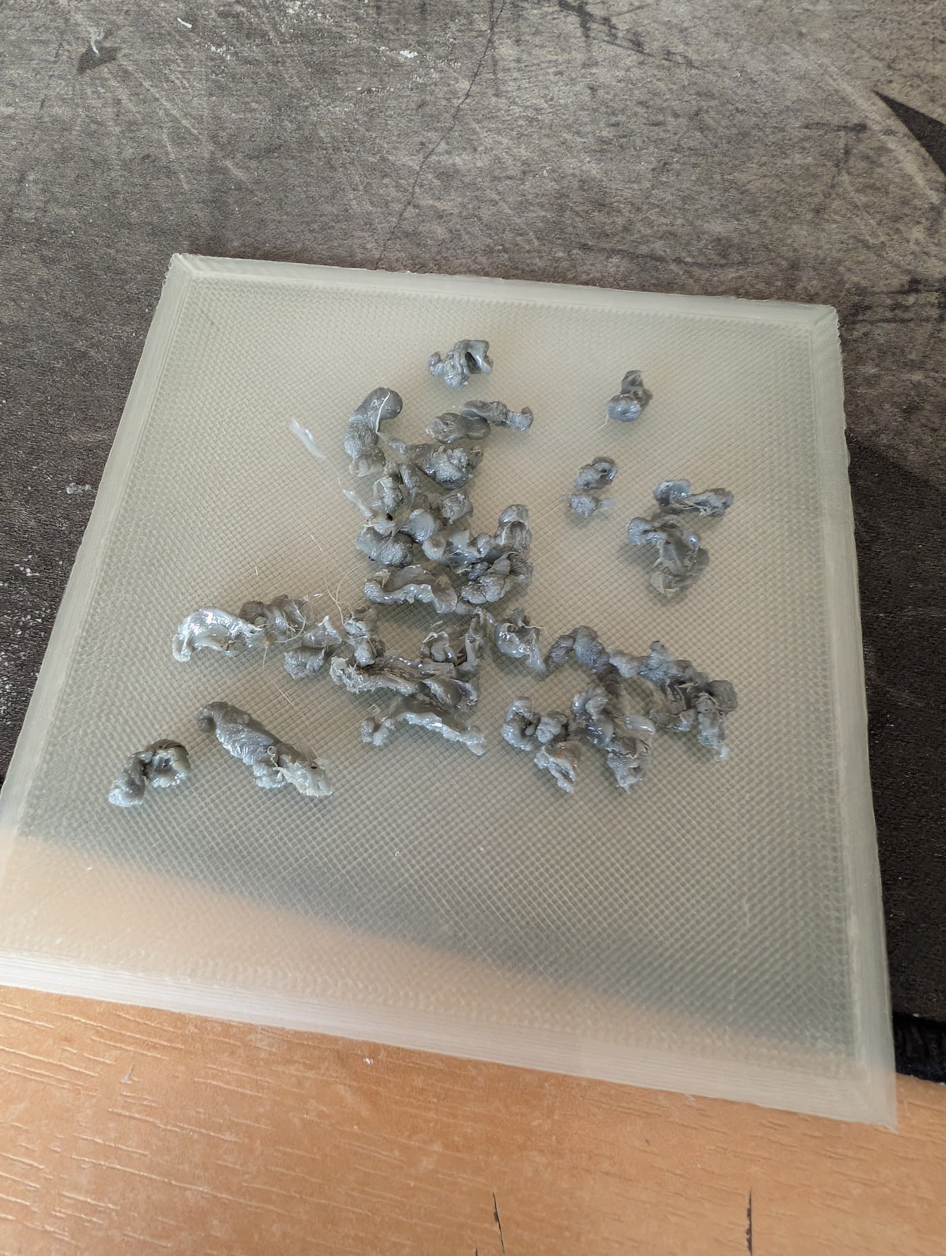

I get this “deposit” when printing PETG. It collects around the nozzle and eventually detaches and drops on to the bed if I’m lucky, or onto the print if I’m not. It doesn’t happen with any other filament.
Is it possible to be over extruding with PETG but not PLA?
I think I’ve solved this one…seems to have been a temperature issue. Gone from 235/80 for printing to 240/70 and…zero snot.
