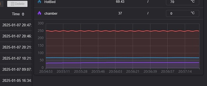

Do I need a new Hot end ?
This was a replacement from Creality because I had a clogged Nozzle,
Just today temps gone wacko .. Yesterday was fine.
Had wacky bed Temps too
Checked all connecters seems fine ..
Any thoughts ?
Thanks Rob
Any thoughts ?
Thanks Rob

I just Selected the Generic PETG in the Creality Slicer 250/70
Everything was steady in the last 2 days of printing
and today I noticed the up and down on the temps…
I’ll look more on the printer or get another Hotend …(Not even 5 month old)
Thanks for your Reply

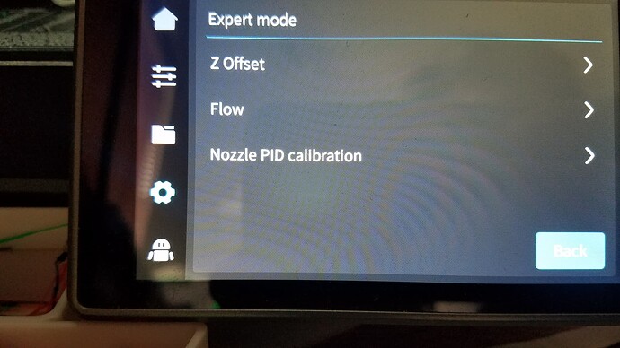

If you have replaced any component on the hot end you may need to recalibrate the hotend by performing a PID test. this will reset the hot end to the new components.

No issue. @Rob_H , I think the other fellow, Mr. @Bill.b , is on to something too.
If you update hardware or software, upping to the tested true PID testing is necessary. Now, Creality keeps coming up with new settings for their nozzles and firmware for their boards. This is the good news.
The bad news is that when you “blindly” update hardware or firmware Over-the-Air, PID testing and settings are sometimes lost and an update to the nozzle and leveling is needed once more.

Where did you see PID Calibration on the Gear Icon?
Seth
Thank you, sir!
off to test…
and done. Cheers!
Didn’t get a chance to print after the Calibration because an Update appeared .. lol
So Can’t Really say if it fixed the problem or the update did .. but looks much better now .. and yes it’s HOT! Default setting “Generic PETG” even tho the PETG i’m using is recommended 200-240c but it printed fine ..lol
