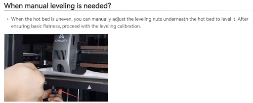

I’m sorry but this is incorrect. Creality’s Wiki page clearly indicates that manual bed level is possible on the K2 Plus, when/if necessary.
Troubleshooting for K2 & K2 Pro First Layer Adhesion and Layer Compression | Creality Wiki
OK, you are right. I have tried adjusting the knobs on my own machine when my prints were failing and the knobs did not move the bed whatsoever. They did not get any looser or tighter and did not change the distance between the bed and the nozzle at any point on the build plate. I concluded that the automatic bed leveling had solved that problem that was so much of a nightmare on the Ender 3’s, etc. I guess not then. Back to the old paper trick : (
At least on mine, hex flat-head screws were used, so the screws themselves are free to rotate in the bed. Solution was to remove each one and add some high-temp adhesive. Then re-tightened and allowed to dry. Now it works as intended / expected.
