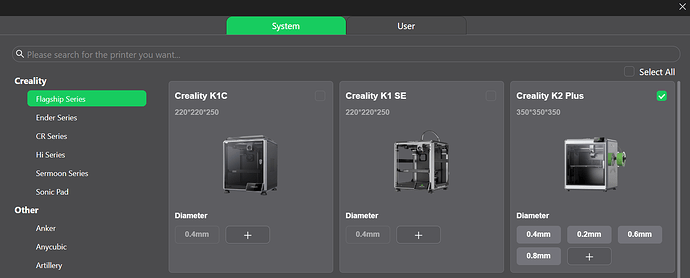

If you upload some screen shots of all your configurations, from what nozzle version pre-sets you have installed (if more than 0.4)
Basic configurations your using:
as well as extruder
then someone may be able to help you.

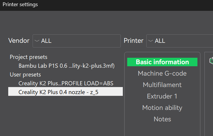

Id expect you to have to configure a custom Bed / nozzle setting in the slicer software (where you choose PIE, smooth, cold etc) and tell the software you have an extra 5mm that needs to be offset for the software to generate gcode based on this new height that the ABL levels… the ABL is likely giving you a mesh based on what it thinks is the build plate… but that info isnt saved.
In the fluidd bed mesh page, you can save this ABL data as a profile and load it at the start of a print, but a better way forward is to create a custom base/build plate correctly offset.
Id be trying an offset of 5.005 to start with, you shouldn’t need +.85 ontop an IDE flat profile…

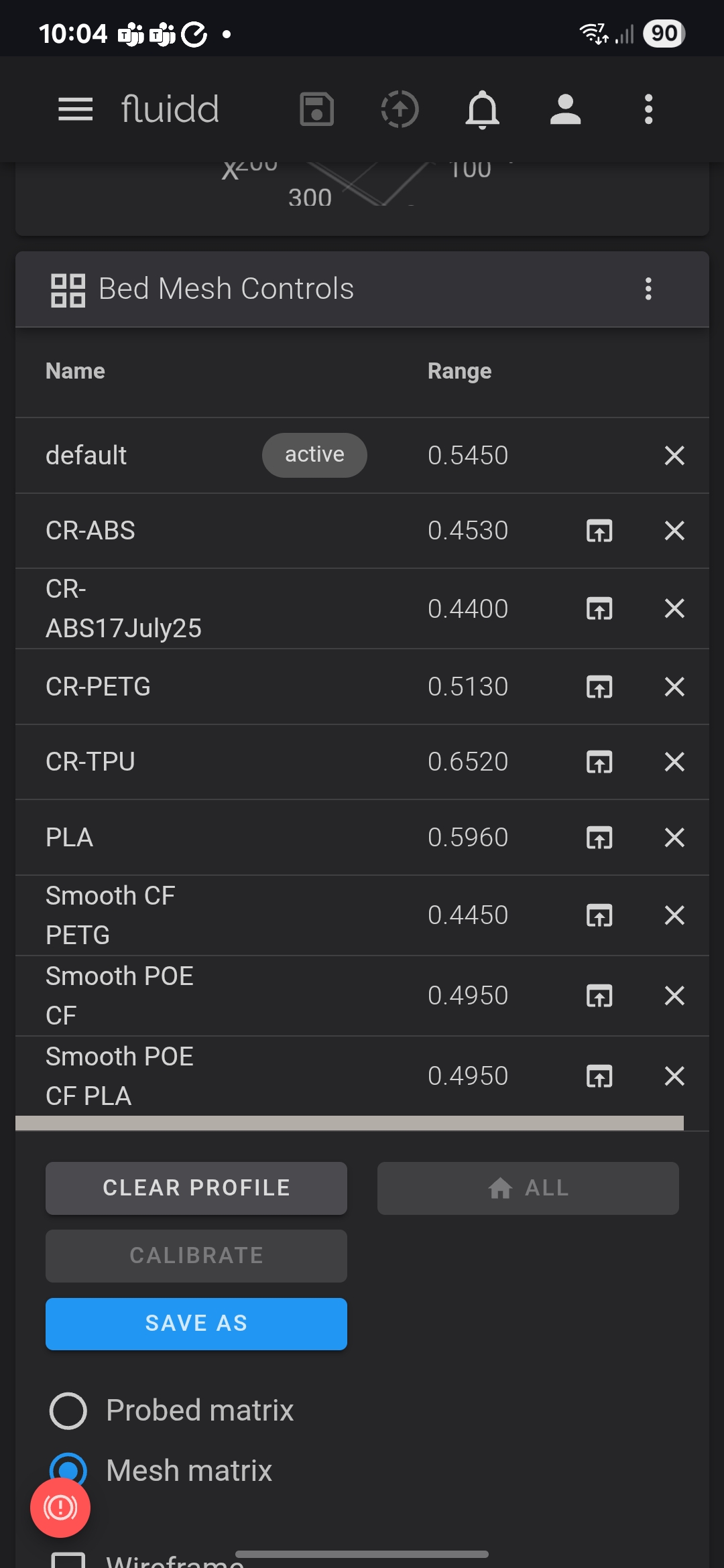

Please post your fluidd bed mesh profile…to see how flat the ABL calibrates the IDE+build plate.
As that will indicate if a) its flat b) its installed correctly.

sounds like you need a custom user preset for your nozzles, ie above correctly added (as you’re running 5mm IDE higher)

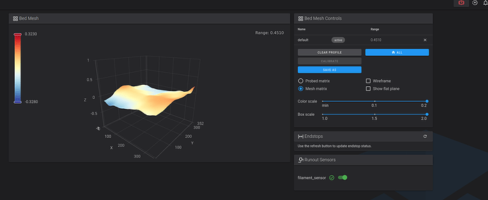

1.1.3.13 and here’s the bed mesh:
What was your bed mesh before installing the IDE ?, .45 isnt great, if id payed that much $$$ for IDE id personally want much better levels than you get from the default stock K2…
Fyi these are my profiles from the stock setup, and while they are not great the ABL manages to compensate for a good-enough 1st layer calibration test.

As i wasnt very happy with the answer that supprt gave me on "acceptable " bed mesh variations…
Im printing 4 foot long joined together parts and .5 is realky cr*p when extrapolated over 4 feet…

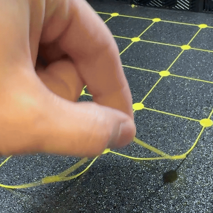

FYI, I think you should do one of these K2 1st layer tests.
or
pay ??? no thanks…
3D Printer Files | 3MF File | Creality K2 First Layer Calibration | Creality Cloud
free
K2 Plus Layer Test by KIMZZOGGO - Thingiverse

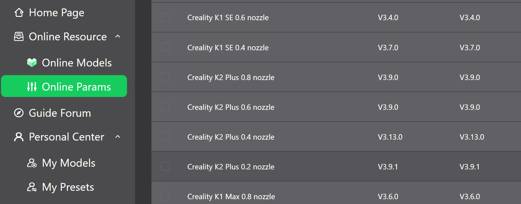

and if you still can’t get good results after creating a custom nozzle profile…

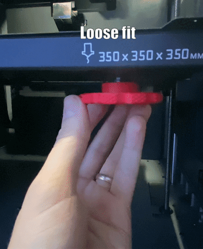

Yep, what i did was from I forget which site, but it was one of those mesh tests I didn’t just make it . Those knobs make calibrating the bed so less painful they’re terrific and just pop right over, no hardware needed. I use one and just move it around from each to another once I finish one. No need to keep them on there or print 4 I figured after I had done just that for the longest time. :slight_smile:
