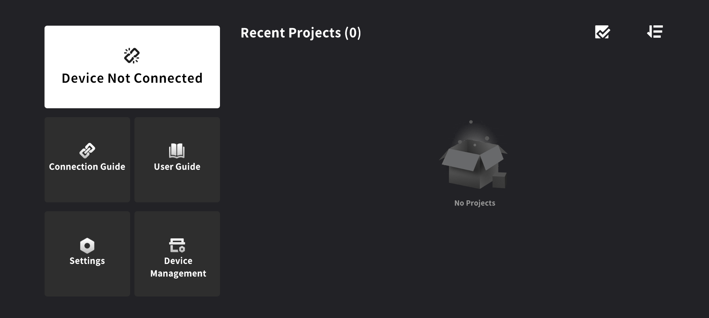

However, after (successfully) installing new firmware and software, I encounter a problem: in Android app I keep seeing:
Device Not Connected

Blue light goes green (as it should) when connected to the computer but keeps flashing blue when connected to either Android phone

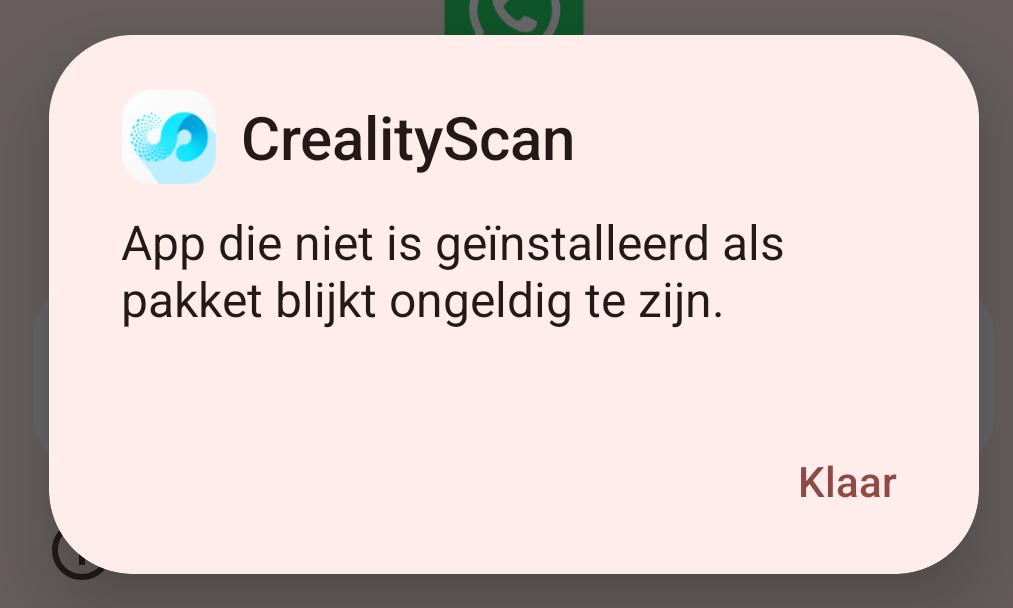

I downloaded the APK and tried to install it (of course developer activated and accepted to install from ‘unknown parties’.
Unfortunately the install ends with (freely translated) ‘CrealityScan. App is not installed, not valid package’
Second opinion:
After forced stopping the 3.0.2 version of CrealityScan, then clearing cache and memory, and lastly installing the currently installed 3.0.2, I tried to install your 3.0.1 again and……. It works!!!

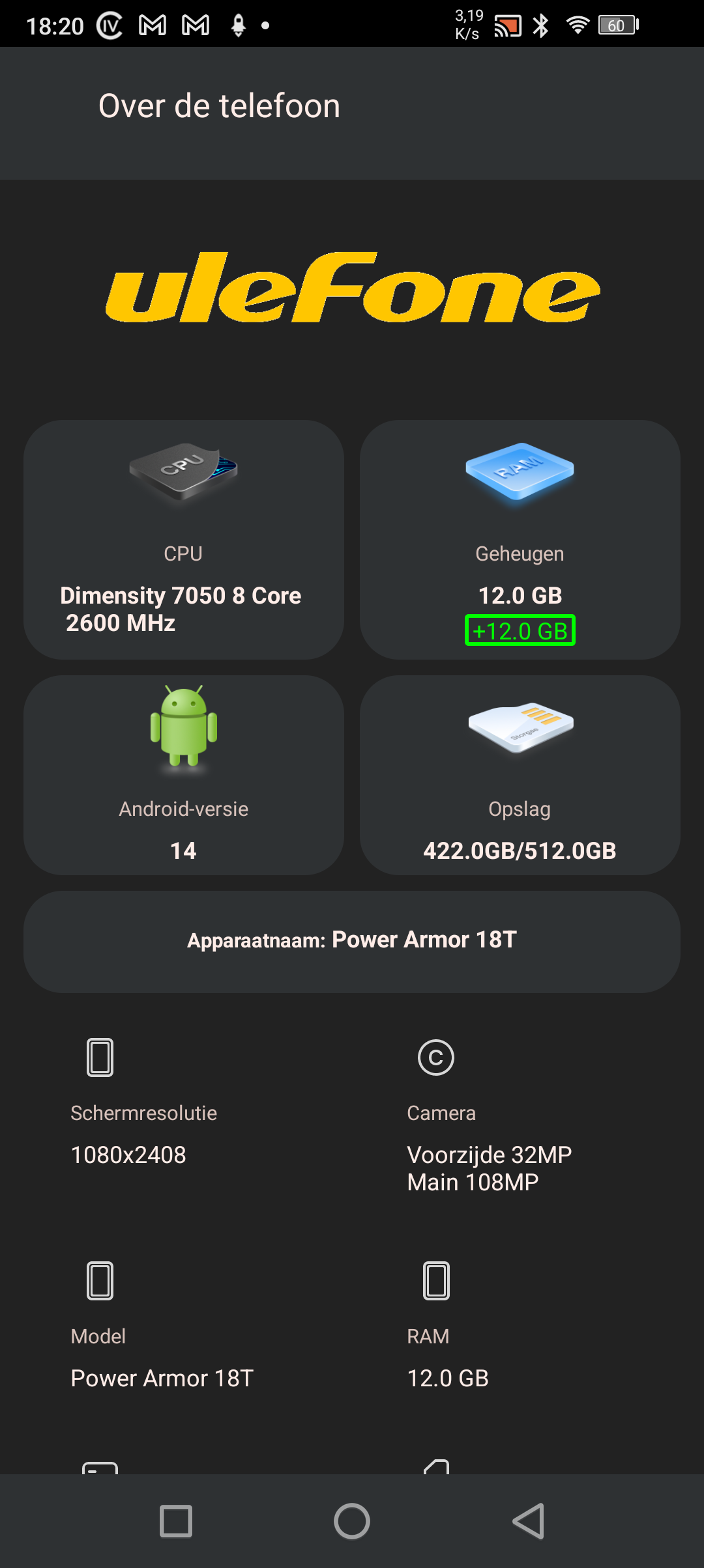

They ask which phone this is and which Android version exactly. You can use the 3.0.1 version temporarily.
Ulefone Armor 28T Ultra and 18T Ultra
I’ll tell them maybe it helps fixing the standard version for this phone.
