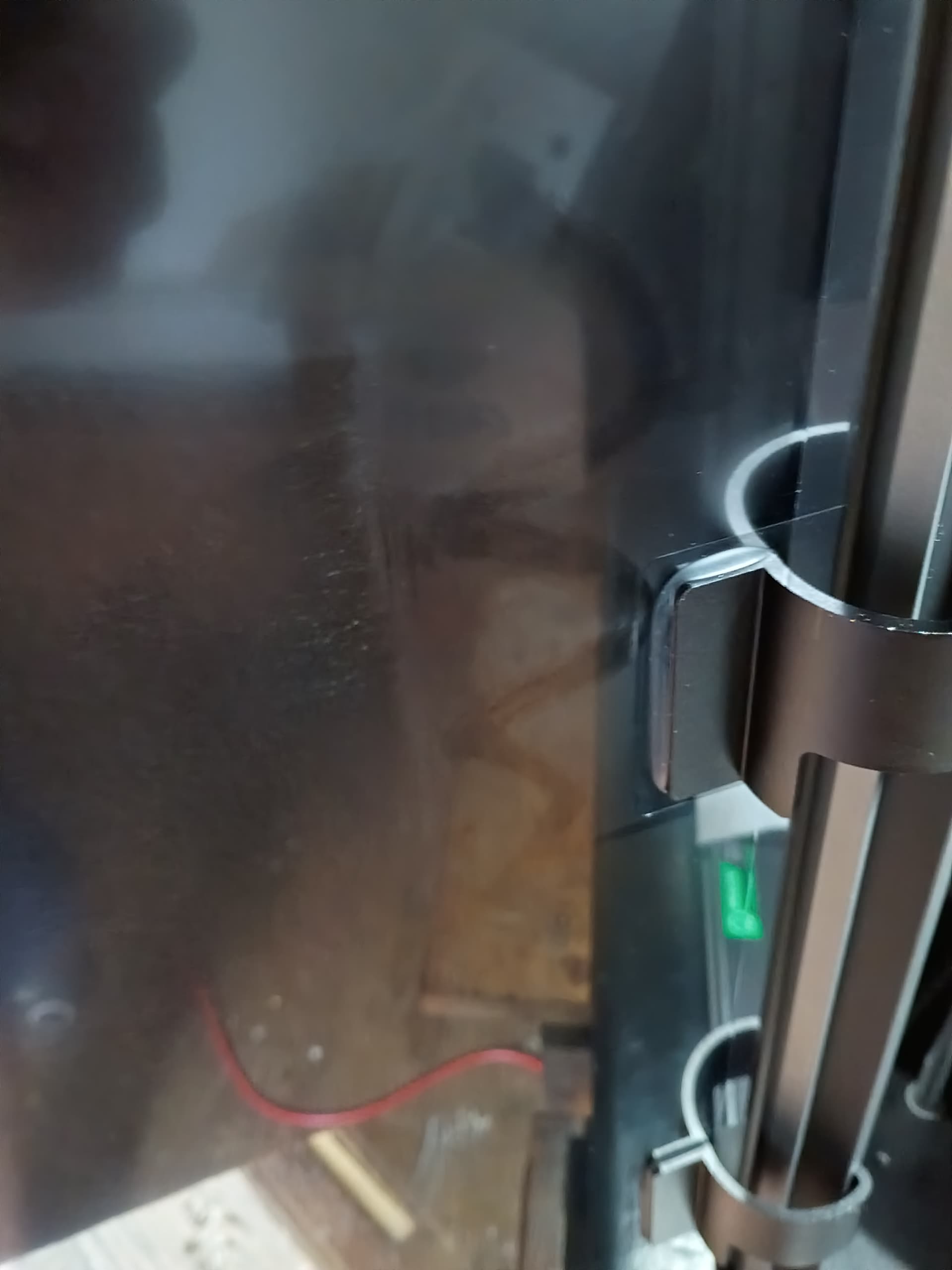

Got my K2 Pro and was thrilled how well the prints stuck to the bed with no glue. I ran about 20 prints and thought it is about time to do some lubing. So I grabbed the grease that came with the printer and put a little dab where appropriate. I though this was a great idea to use grease since it will stick well to the components and it is official 3D printing Grease. WRONG!

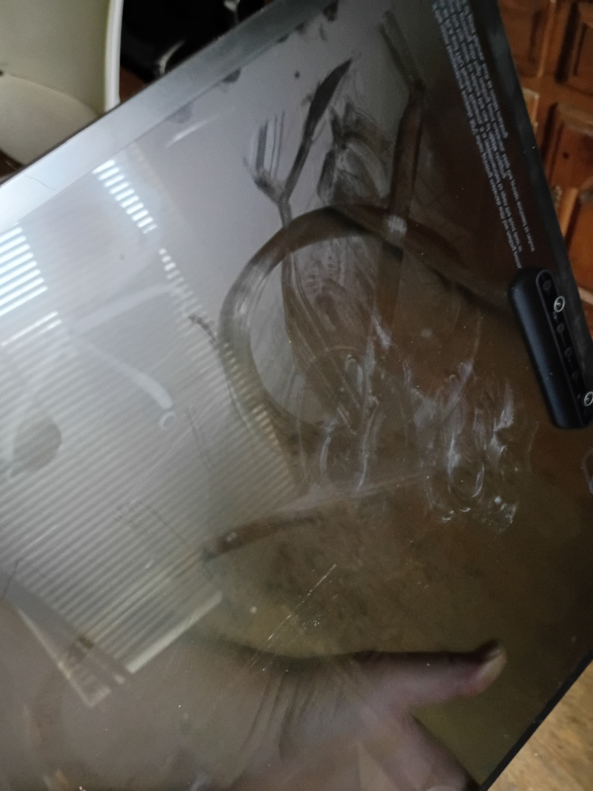

I am working exclusively with ASA and a heated chamber of 45C. After about two prints I dismissively noticed that the front glass was blurry, then my prints would no longer stick without glue. I’ve pondered this for a couple days and have come to the obvious conclusion:
**The Grease is Out Gassing and filling my chamber with grease residue!
I suggest sticking with gun or sewing machine oil (possibly hydraulic oil) but I now have to wonder if even those out gas at 45C. I will be investigating high temperature non gassing oil.
Any suggestions?

For the record the grease for the nozzle is not the same grease as is intended for lubrication. I have wiped clean a few times and the residue, while not as bad, is still showing on the glass after a few prints. I am of the strong opinion that this grease should be avoided, especially for a heated chamber. Only acetone and steel wool has been strong enough to make the bed plate usable again. Still have to use glue.

Update on what I consider a very important subject that is not getting any attention.
The grease provided with the printer out gasses and ruins the bed sheet.
After a week of wiping down the printer after each print, I think I have most of the residue gone.
I received a new bed sheet, put it in and started printing with great results.
I sprayed the PTFE lube on a paper towel and wiped it on the metal to metal. Won’t know for a long time the effects of that. Apparently it take 24 hours for the PTFE to cure but I’m going to just run it.
There should be a in depth investigation into this as I am convinced the out gassing permeated the PEI sheet on both sides and ruined it. I suspect the whole industry is being effected by outgassing lubricants.
