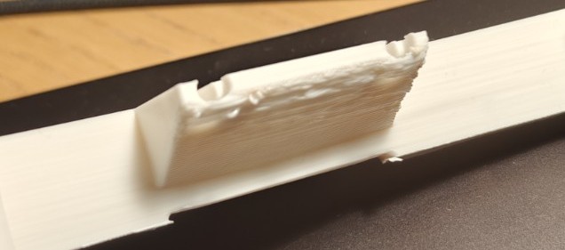

Hi all! I used to print ABS on my K2 Pro and this was working fine. Now I do the same thing and overhangs are now like in the picture. Tried both ABS filament brands I have here, both the same. I think between my old prints and now there are at least new CP version and new firmware on printer. I am little frustrated as this was working fine before :frowning: I checked the slicer profile as well, used a standard one, used standard ABS profile as well, does not really change it.
Can someone give me a hint on this? Much appreciated :slight_smile:
Welcome to the community. This looks like filament moisture. Did you dry the filament and try again?

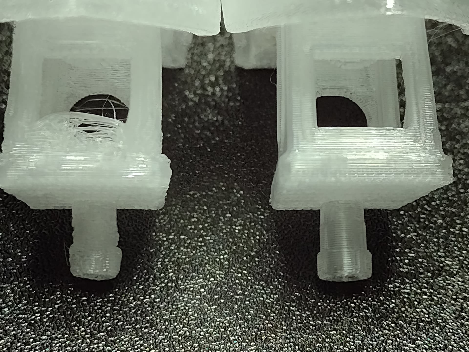

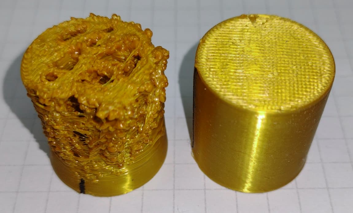

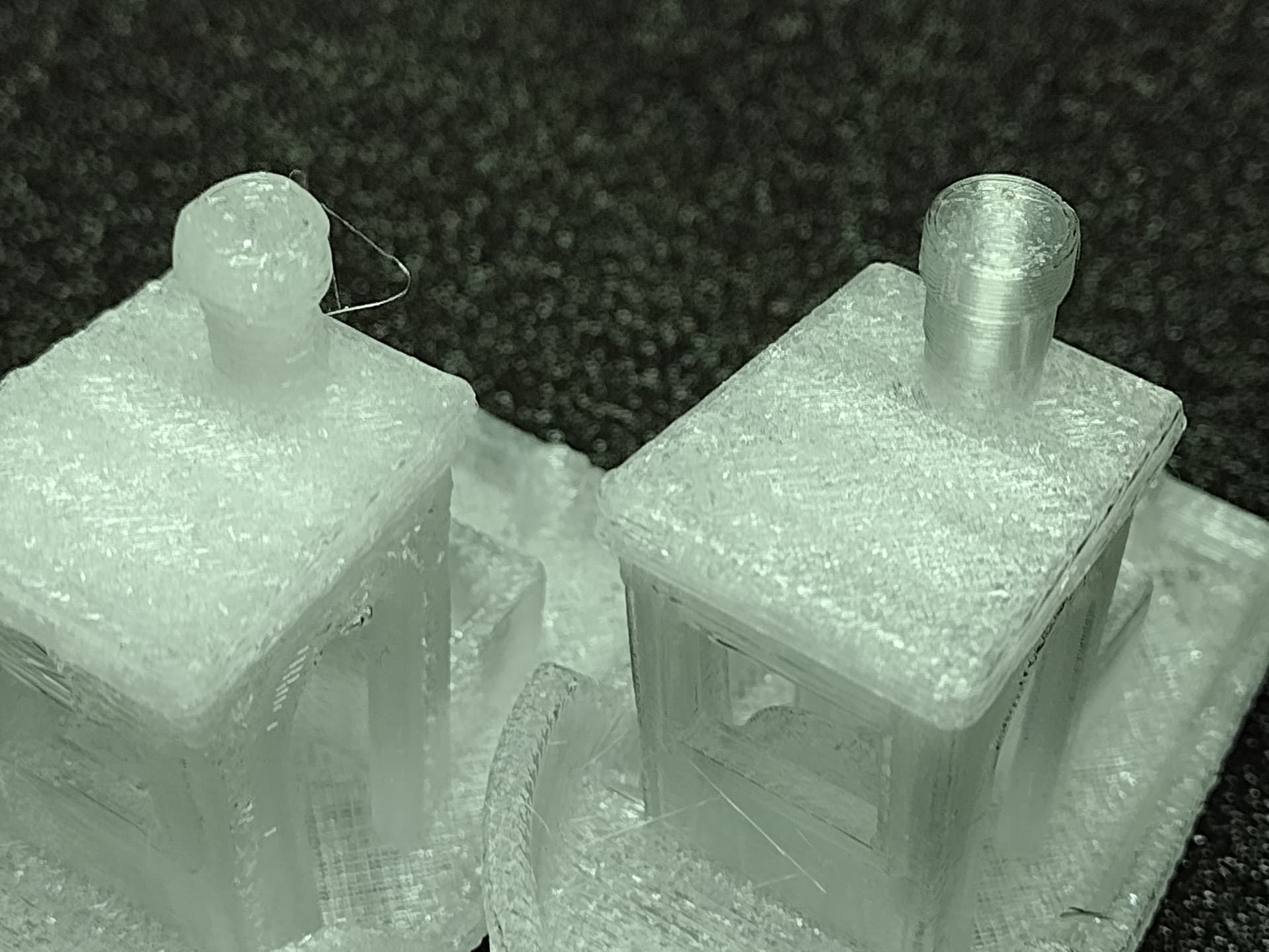

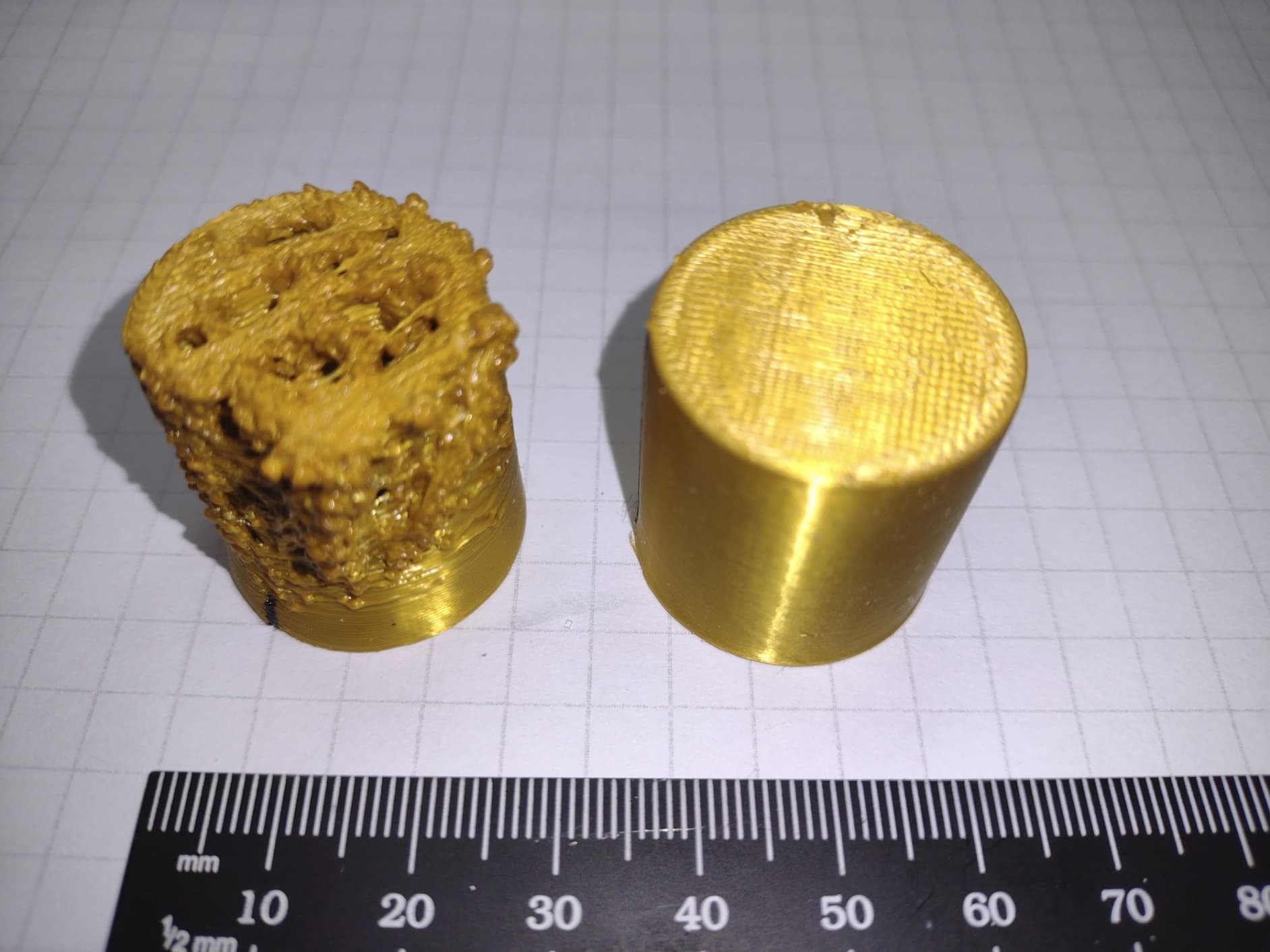

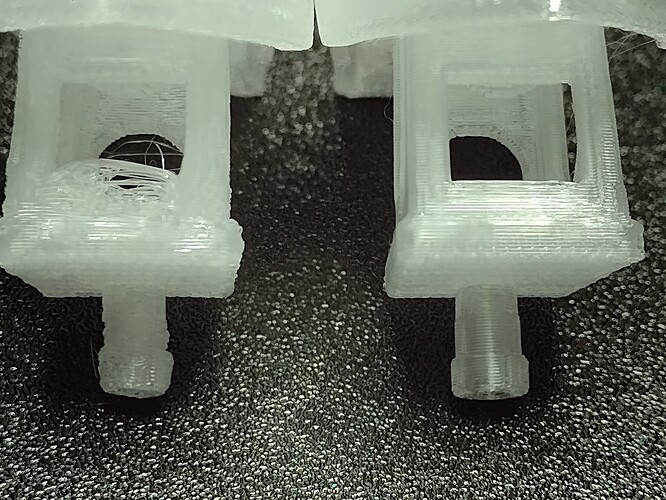

Some test examples below that I keep around to show wet vs. dry filament. The wet print is on the left. The Benchy is clear PETG, and the gold print is silk PLA. This shows that even PLA, although less moisture-sensitive than many other materials, can still be affected.
