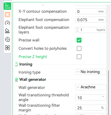

It does work. Arachne is the wall generator type - see the screenshot. Arachne works better for texture and curves than classic.
Thank You. I’ll give it a try with athe Arachine setting.

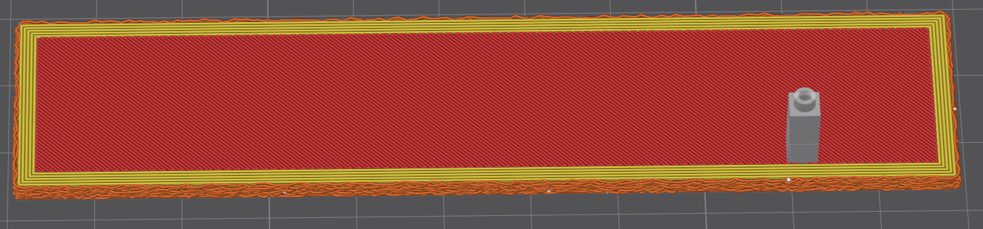

I’m still missing something. I’ve painted an area for a fuzzy skin test:

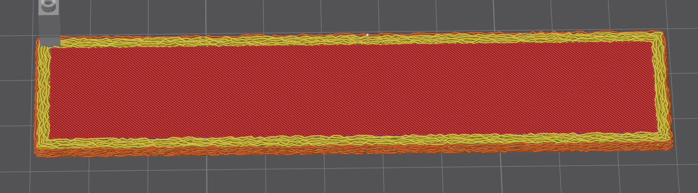

But it seems to apply to the outside edge only:
I’ve been trying out different settings. “All walls” gives an interesting result. It almost appears that Creality paint does not consider the top to be a wall. Could that be it? and if so, why does it affect areas outside the fuzzy wall paint?

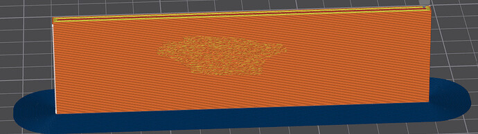

O.K. I get it. the fuzzy paint has to be on a wall. If i turn the rectangle on it’s side, fuzzy paint works.
Apparently if you paint a non-wall (even a top surface), it spreads everywhere. Strangely, is spread everywhere when I used it on a sphere. Right now I’m just trying to do a section of a plate, so the sphere issue will have to wait for another day.
