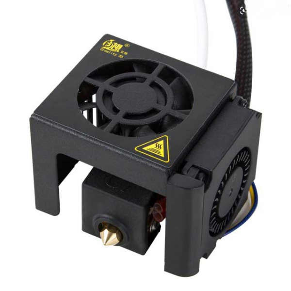

Assuming that you have the stock Ender 5 printhead it should look like the one below…
The fan on the front where the yellow logo is should be running at all times. It is only the side part cooling fan that should be controllable.
Ahh sorry, I have a ender 5s1.
The part on the back is the cooling fan. There is no problem with the fan at the front
Thanks for clarifying which printer you have. Yep as you say the part cooling fan is on the rear and the heatbreak fan is inside the front. The heatbreak fan on the front should run at all times and only the part cooling fan on the back should be controllable.
If you are still unable to control the part cooling fan then I would recommend reaching out to support in case you have a faulty mainboard or printhead board.
