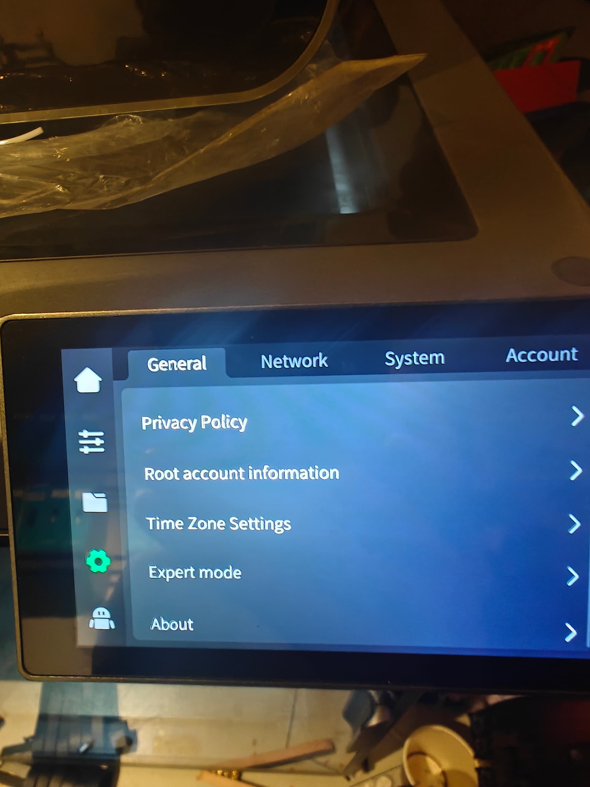

I’m getting lots of system errors (XS2060) and one Creality Wiki suggestion is to look at the printer’s log files and see what the error previous to the system errors was and attempt to fix that.
Have downloaded the logs onto a USB but they are PW protected ! anyone know the PW?
creality_2024 or creality2023.
You can find the password when you go to root when these dont work anymore.
Thanks for the reply but dont understand as there is no root directory on the USB drive i’m using. DO you mean root on the printer?
Yes the root on the printer, you can find it on the printer menu.

Thanks, When I try to go to the root it gives me this
“The authenticity of host ‘192.168.1.29 (192.168.1.29)’ can’t be established.
ED25519 key fingerprint is SHA256:hu6lRQVF8SHO+USFk/gI8GuivPm/tS0SyiU7mKUIM6w. This key is not known by any other names.”
Is this “Key Fingerprint”, or part of it the pass word?
OK I got the Password via the printer (creality_2024) but it won’t open the log file I downloaded on the USB
I’ve logged into the printer using ssh - cant see any logs. are they buried somewhere further in?
Thanks
OK I think I found the logs in /mnt/UDISK/creality/userdata/log

I think I have solved the system error 2060 problem, I back graded to 1.1.3.13 and so far so good :grinning_face:
