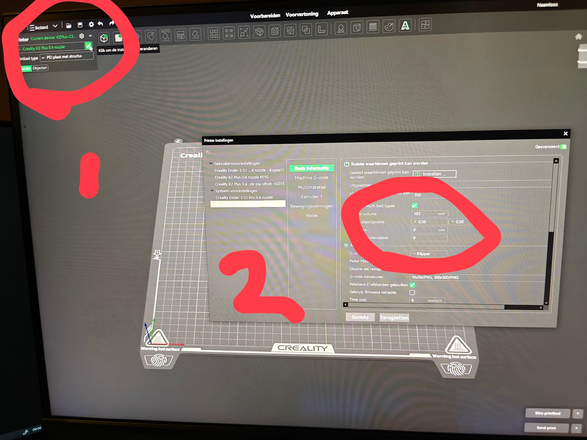

Can I ask how you adjusted the z-offset? I get 2784 errors after the print runs a few minutes. It’s very frustrating.
Thanks
there are 3 ways. What i do.
To determine my offset i set it before the first purge line in fluidd.
You can also set it on the printer to determine. Expertmode then z-offset
When i know the best offset you can make a printer profile. Dont forget to switch when you print something else.
