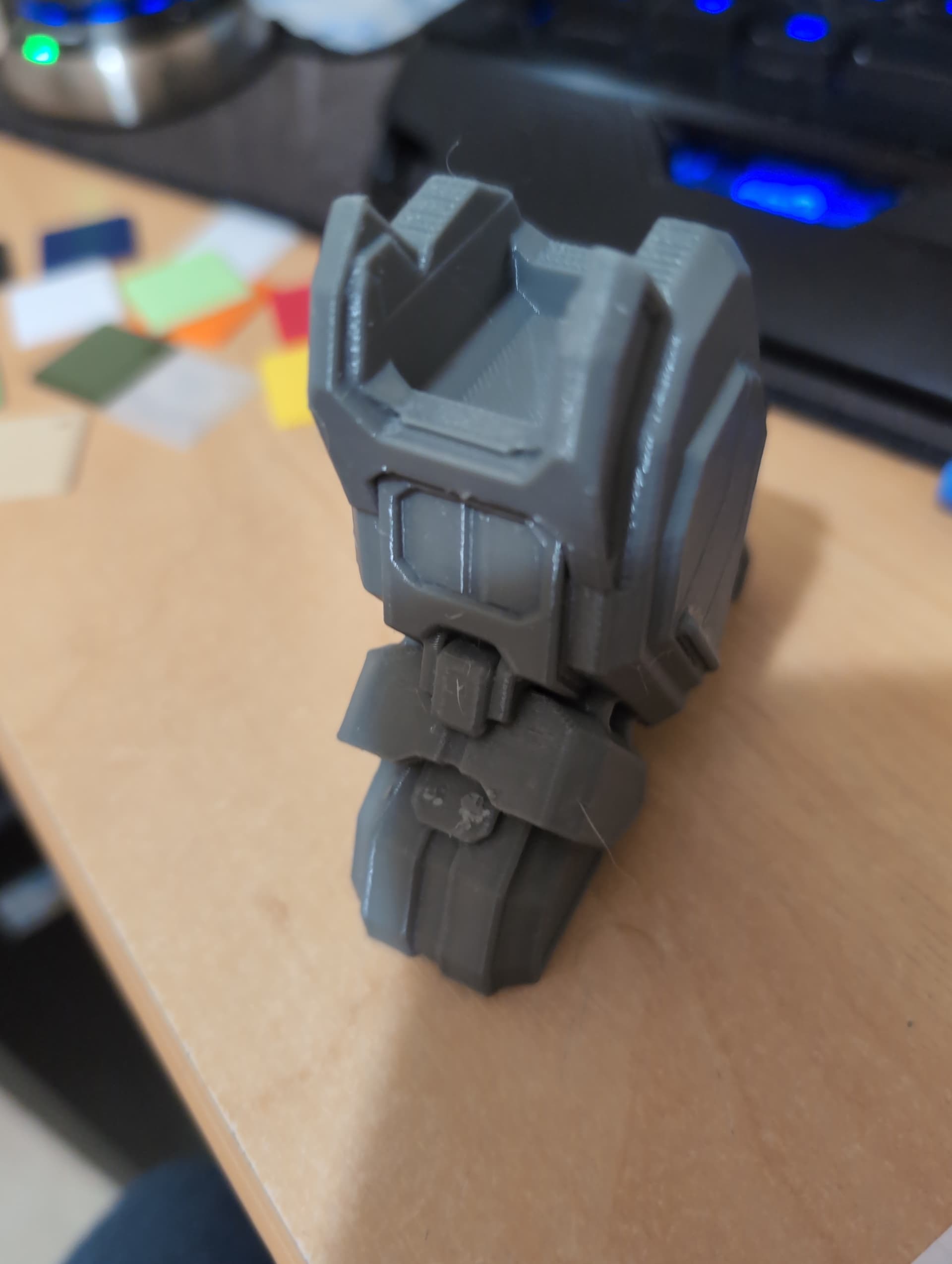

In other news, grey PETG prints like a dream (pictured below). It’s the clear that I’m struggling with. It’s probably my fault for starting with that; it’s the highest resin content because there’s no fillers or pigment in it. As a result it’s very cohesive (sticky) which means it has more affinity for itself than the bed…
