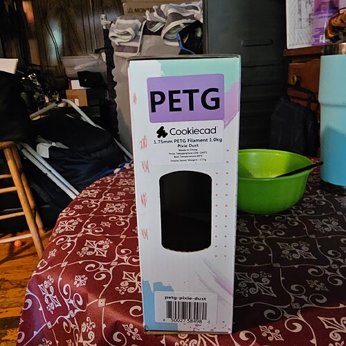

I have the K1C I have printed up. Using PLA ABS ASA, but now I’m trying P.E.T.G, cookie cad The COLOR IS pixie dust IF THAT MATTERS? The printer will print the first layer. Perfectly? But when it gets to the second or third layer, it shreds, everything, i’ve tried changing the settings. I’ve tried changing the heating. Of the nozzle and the bed, but it makes no difference. It still does the same thing. I’ve tried reclicing. And the filament is fresh out of the box.. I don’t have any trouble with any of the other filaments that I mentioned in the beginning of this message. Don’t need to dry them. I don’t need to do much of anything with them. They just print . I have this fancy stuff and it wants to give me problems… any suggestions on something? I may be doing wrong, or is this particular filament? Just c***. Thank you for any help that you may have..
