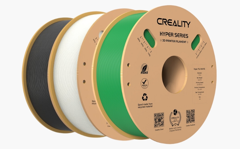

Part 1: Filament Types and Properties
3D Filament
1.1 PLA Filament
  • Pros: Easy to print, biodegradable, low warping, good surface finish.
  • Cons: Brittle, low heat resistance, not very durable.
  • Tensile Strength: ~60 MPa
  • 100% Modulus Hardness: 3.5 GPa
  • Elongation at Break: ~6%
  • Print Temperature: 180–220°C
  • Print Bed Temperature: 20–60°C
  • Ideal For: Prototyping, hobbyist projects, decorative models.
