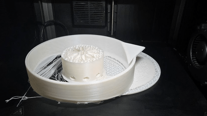

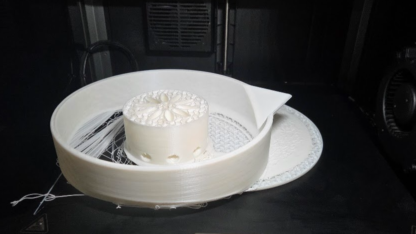

Something else strange happened which you can see in the image attached. The entire print at some point shifted to the left and it continued printing on that shifted location. Maybe that’s an issue for another thread but posting here just in case that’s a common problem.
I did pause the print on the second layer but when I continued, it did pick up from the same spot. As you can see in the photo, it went off to the side quite a few layers above when I restarted it so I’m not sure it’s related.
Any ideas?
