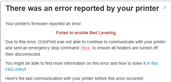

Wife bought me an Ender-3 for XMAS a few years ago. I just got back home to start using it 6-months ago. Recently she got me a new plate, CRTouch and new PLA+ subscriptions from numakers.
I have been playing around with settings, firmware and such. I was able to print before adding the CRTouch but I noticed that before I installed the CRTouch it said Ender-3 Pro on the screen and now it says Ender-3 E.
I use Octoprint to communicate with it via COM4, when I send a print most times I get an error “M112”. If I dont get the error then it starts printing but after about 5mins I hear the print pop off the plate.
All I did was hit AutoHome on the printer!

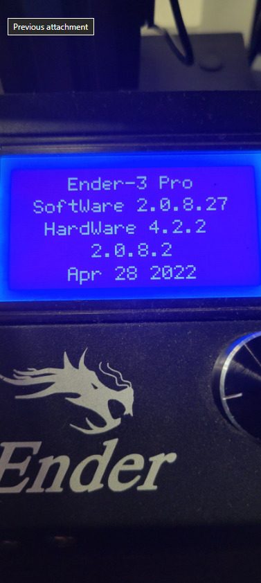

it says 4.2.2 on the board. not sure what else to look for
Ok ! Then I would suggest you to flash this one
Ender Series Firmware Download | Creality 3D Printer Firmwares
I already have 2.0.8.2
Flash it again. You could have a corrupted firmware.
