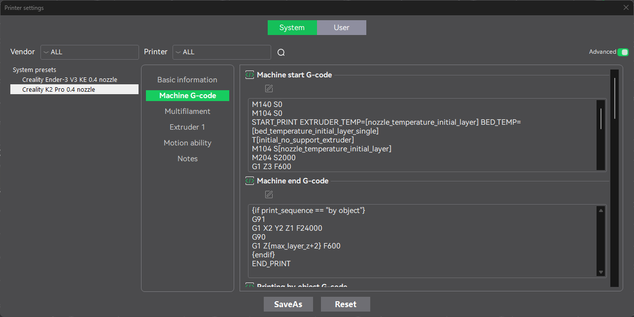

Hi! I didn’t try manipulating pre-heating but it should be hidden in the Machine G-code settings:

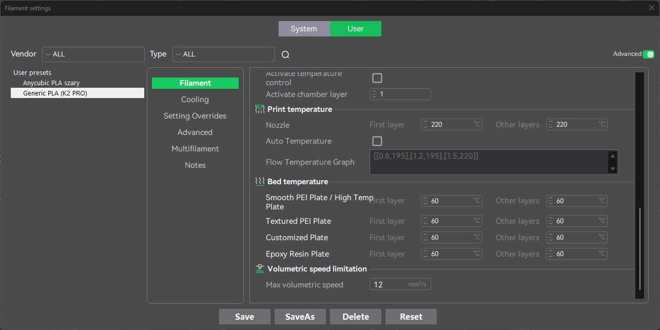

Please check if you have set good temperature in the filament settings also:

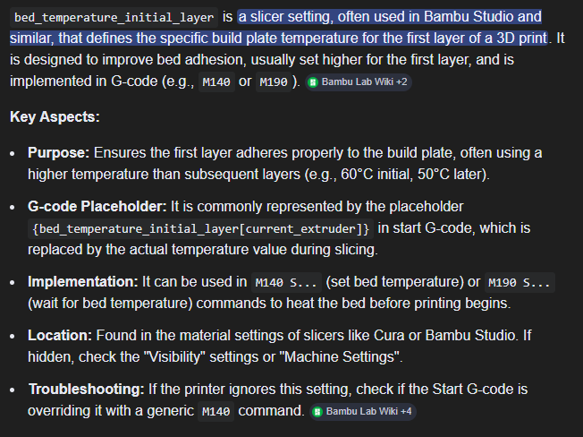

Printer can pre-heat the bed to check if the heating module works properly. I hope it will give a clue for you. I am not a gcode specialist, but as I searched it can be M140 command in my example - you can set your own temperature after the command. More information that I found in the Google:
And here you have also similar question from UltiMaker forum Build Plate Temperature Initial Layer is ignored · Issue #17233 · Ultimaker/Cura
