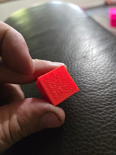

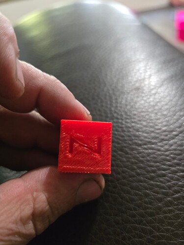

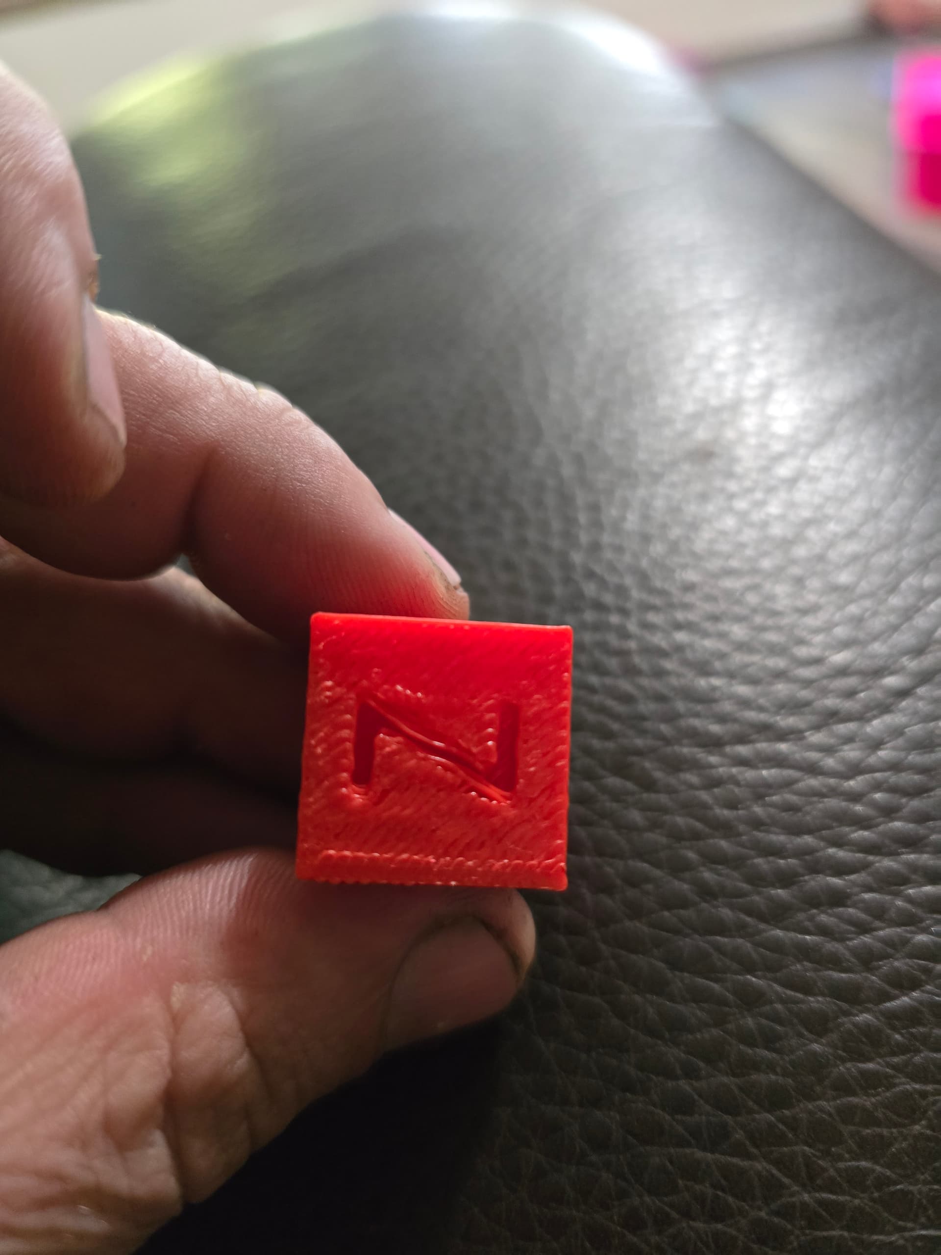

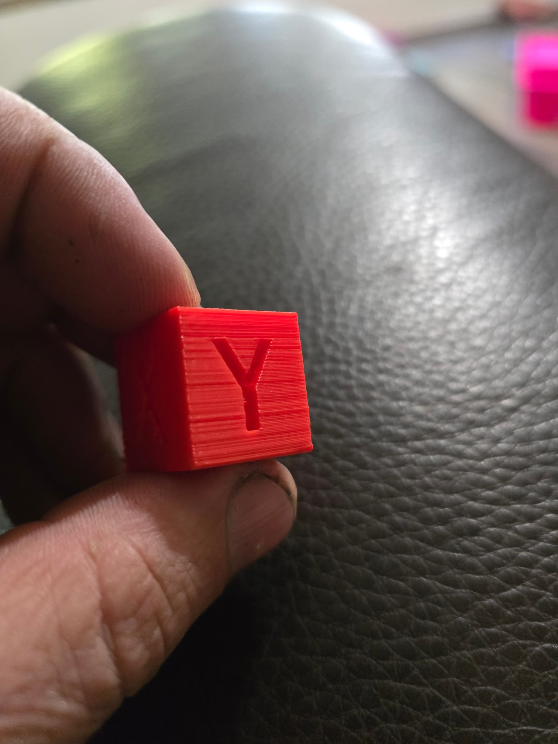

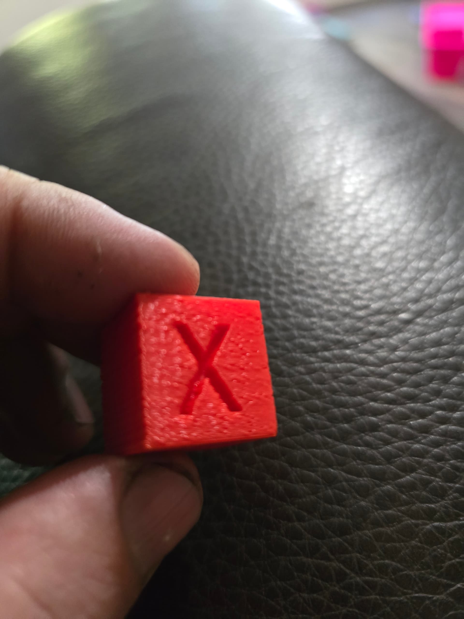

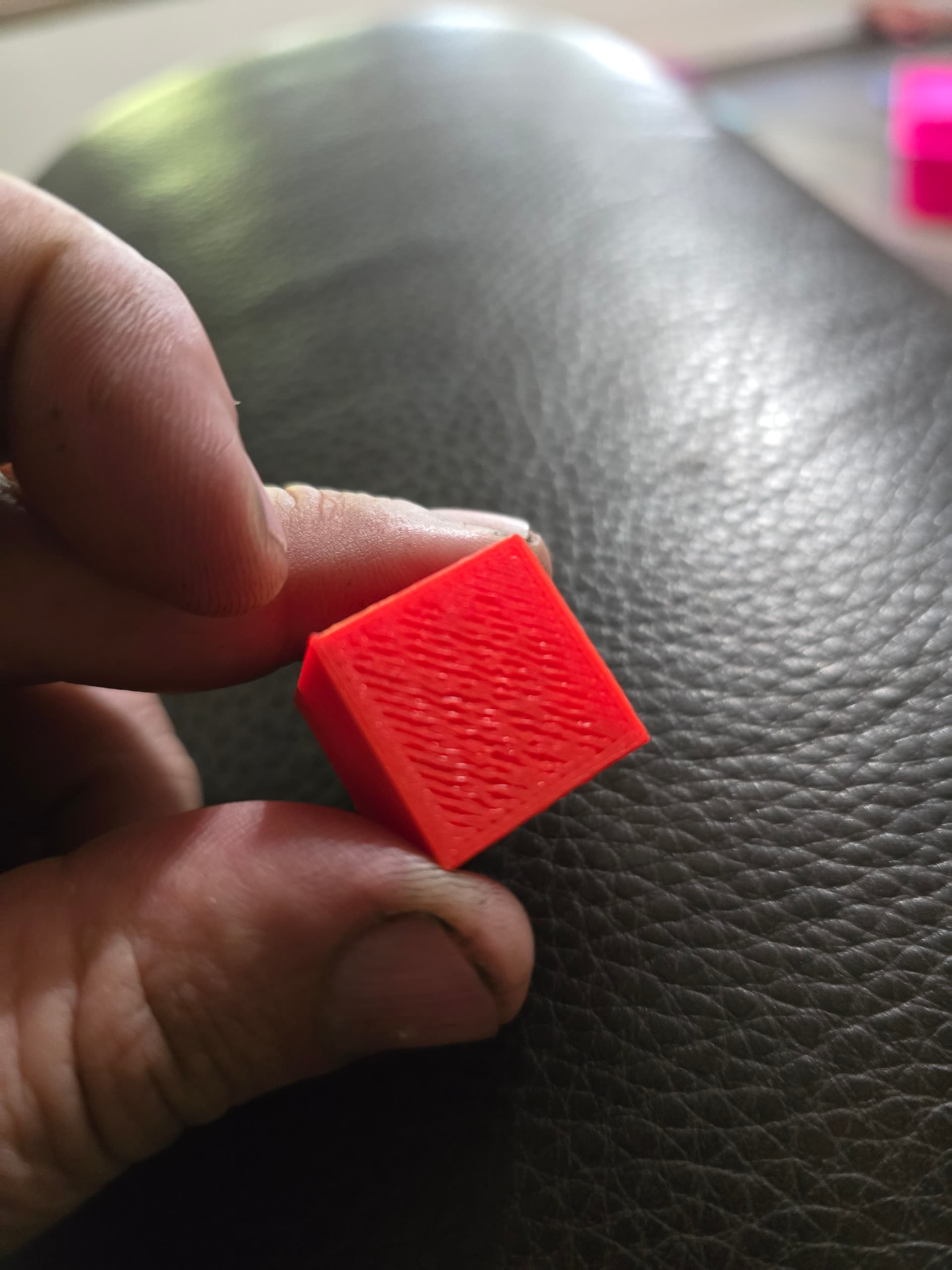

So ive been fighting my Hi for a few months now. I have tried every calibration, flow, pressure advan e the works. Checked the belt tension ended up have to rebuild the x axis tensioner and still my prints look like this. Does anyone have any ideas

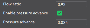

the presure advance on that cube is noticable under extrusion, if you are printing with PLA and nozzle 0.4, try with this parameters.
also check the screws under the printhead that hold the printhead to the carridge block of the linear rail, also check the screws of the linear reail, make sure they are all tight
i will try those setting i had it at .94 flow and the same on the pressure advance. i just took the hot end completely off to rebuilt the x-axis belt tensioner but i will check them again. you are talking about the 4 screws under the bridge correct?
Exactly, im talking about those 4 screws, and i think theres 7 screws on the linear reail, make sure those screws are tight. plz answer this when you done trying every i said and post photos of your new calibration cube results
if your cube prints with the same bad results, then put flow to .96 and presure advance make a minor change put in 0.036
i’ll try that tonight, I also ordered a new extruder cause i did some read on other sites and people where having simpler issues cause of extruder issues
maybe, but do you try with another nozzle? i never had a problem on my printer, i have like 800hs, never got a clog or anything like that, i constant change nozzles from 0.4 to 0.6, even used temu nozzle 0.4, never had a single problem, but as i said, i always check all the screws of the entire machine, lubricate the rails, tension the belts, etc etc, only thing i dont do is clean the build plate, not even in my HI or my SPARKX i7, never used glue, with a perfect bed mesh and all screws tight (EVERY SCREW), you dont need anything like that
i have replaced the nozzle that was one of the first thing i tried. how do i lube the x axis? what i think happen is i got a clog at the extruder and i damaged it trying to clear it. I tied your setting but there was little change. sorry i didn’t take pictures.
what type of lube should i use on it? like a dry spray lube
you can use that, but is better if you find a similar one but more like oil, less dense than that one
