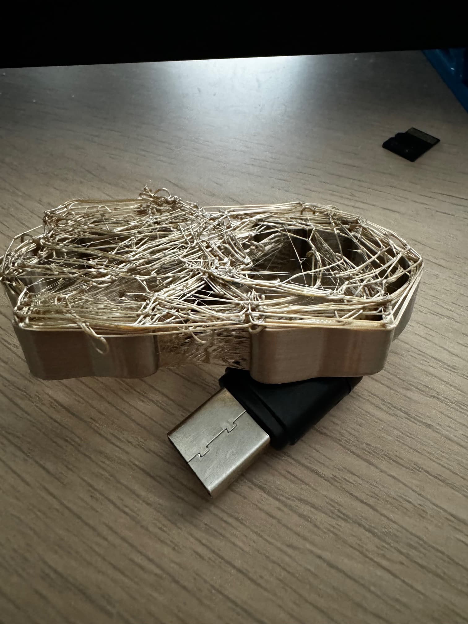

Printed well out of box, now several issues...VERY Frustrated and Puzzled (listed below)
Ender -3 Pro (Not sure exact model)
0E3094C1-48F1-401A-BB9E-E0BD1C950564_4_5005_c
Worked fine out of the box before I had any clue about anything such as bed leveling.
Made several items with nice finishes.
Initial default settings were 200 degrees for nozzle and 60 degrees for the bed.
Printer started acting erratic and printing string
After numerous YouTube videos I did these upgrades/fixes.
Leveled bed several times
Purchased Creality Glass bed, worked fine for a few prints. Eventually set the bed to 85 degrees which read approx 60 degrees with infrared thermometer
Cleaned bed with 91% Isopropyl Alcohol
Replaced the extruder mechanism where feeds through gear
Changed Bowden tubes, fittings and replaced nozzle.
Extruder SEEMS to be fine if I manually extrude
Tried Creality & Cura slicers
Tried printing different prints
Tried many different heat settings on nozzle
Changed extruder motor and also replaced one wiring harness (for the extruder only)
Tried different PLA
I started to get close agin to printing somewhat, not perfect but kind of ok. I was just getting stringing and felt like I was back in business with just some needed tweaks.
Then it went erratic again. Seems 1/2 way through a little Benchy print, it comes off the bed and just started making string.
All the axis’s seem tight
I am about over this Ender 3D Printer after endless hours of trying and getting no where.
Pics Attached.
Any advice?
Thank you in advance!
Wayne

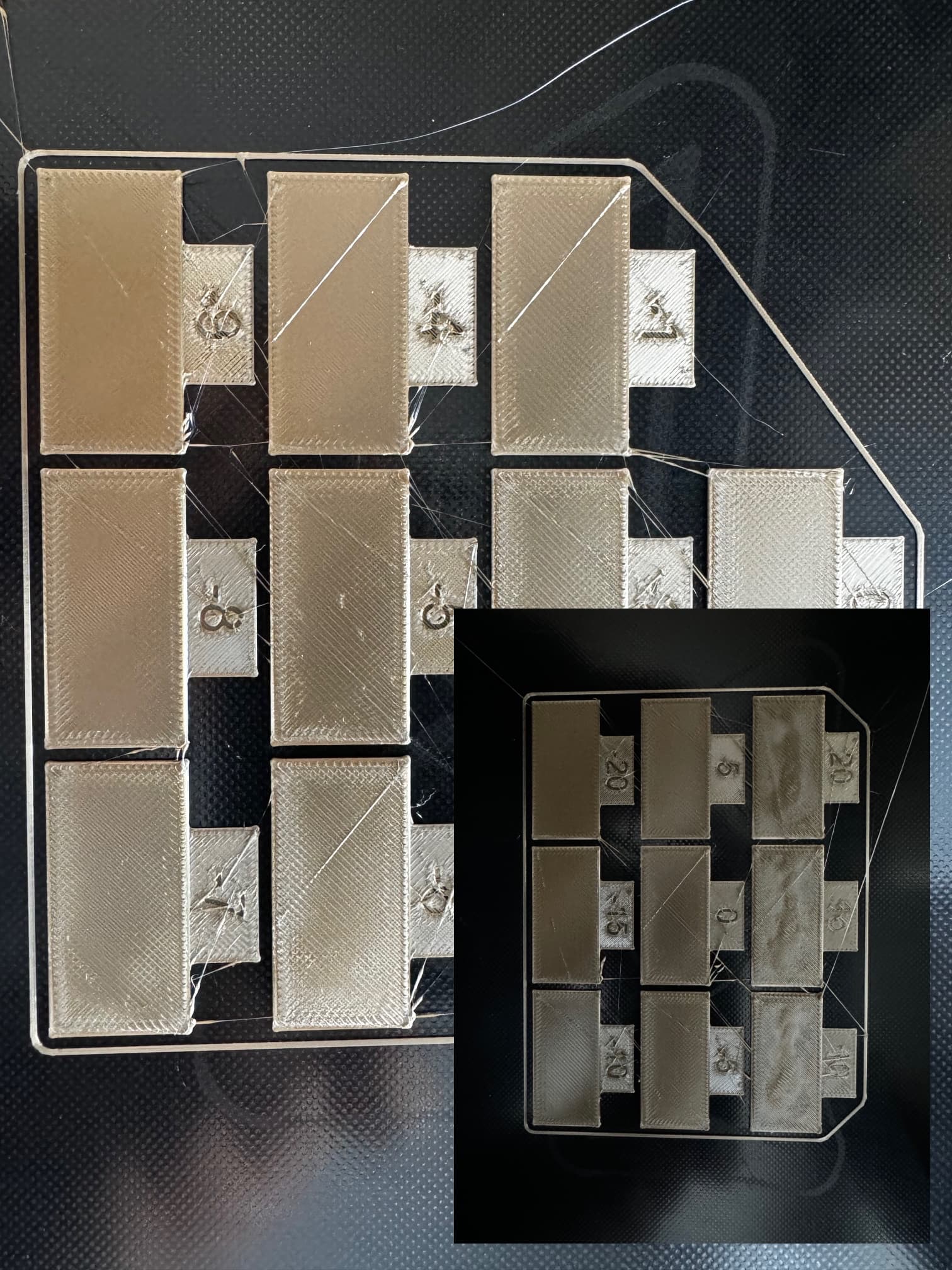

I downloaded orcaslicer, I did the 2 flow tests. Since I’m a newbie on the site I can only upload one pic, it is flow rate pass 2. (but I kinda of merged the 2 results into one pic)
I did order the PEI and expecting that tomorrow.
Not sure how to check “estep calibration”
Both tests did stick to the bed, maybe because they were not tall tests? Time will tell…
Thanks again…Wayne
You’re welcome wjo1000
Glad to hear that the flow rate tests went well and thanks for supplying the photo.
What I would recommend is now that you have Orca installed and setup work your way through the calibration list. Start at the top with the temperature tower and work your way through them. Ideally you will only need to print the temperature tower at the temperature ranges stated on your filament spool.
As a general rule the only tests you would need to perform to properly ensure correct printing is temperature tower, flow rate and retraction tests. All the other calibration tests should not really be required for your printer setup. Calibrating all of these 3 will not only ensure you filament is being melted and dispensed correctly but will also ensure close dimensional accuracy for your prints.
Here is a link to the OrcaSlicer calibrations tutorial and how to use them…
OrcaSlicer Calibration
To check your esteps you would usually put a mark on the filament at 100mm and 110mm from the entry point of the extruder, then heat the hotend and tell the printer to extrude 100mm of filament. If it extrudes too much or too little then you can easily measure and do a quick calculation to work out what your steps should be. Here is a link to a guide which should help explain things a little better…
How To Calibrate the Extruder Steps

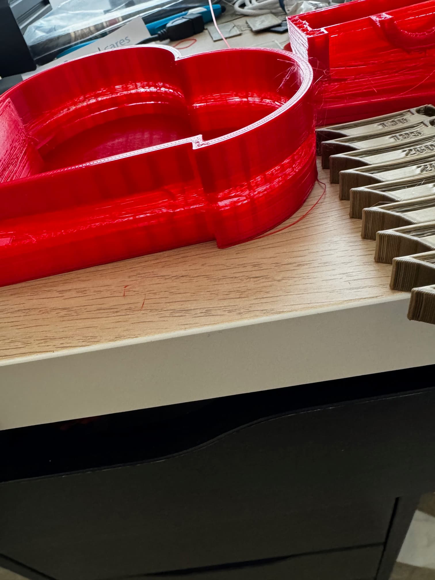

Hi Nikoli,
I thought I was out of the woods last week, I thought my issue was just stringing.
When I printer the heat tower, all levers look very similar. You can see a piece of it in the pic.
Then I tried to print another piece, it was adhering to the bed ok, but then as you can see, it’s not sticking between layers.
I feel stuck in a loop. Being a newbie I do not fully understand all calibration settings. I did find one article and set a retraction.
Again,
I am Clueless…
Wayne
