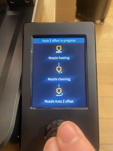

Hi - newbie here! Just opened out new Ender 3 V3 SE. During set up the printer bed moved backwards but failed to move forwards again and makes a horrible sound for a few seconds when setting up. Then the nozzle tries to come down ahead of the plate. No way of doing a reset as the screen only has the language option and then the ‘Auto Z offset’ page in view. All thoughts gratefully received

Pics in case I’ve done something really stupid ![]()
I only have this option on the display screen -after choosing English and confirming nothing is on the plate.

Update - so Creality support were brilliant. Turns out the belt was too loose. I tightened it and all is now working. Thanks again for all your help
