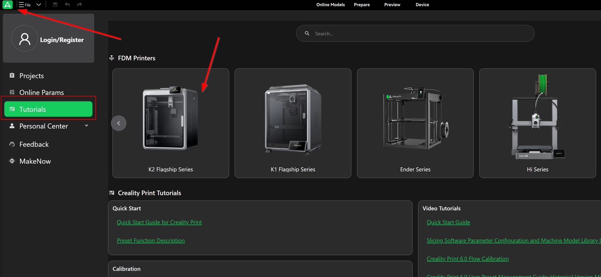

Before addressing your questions, it sounds like you may want to start with the tutorials first. Here’s the quickest way to find them.

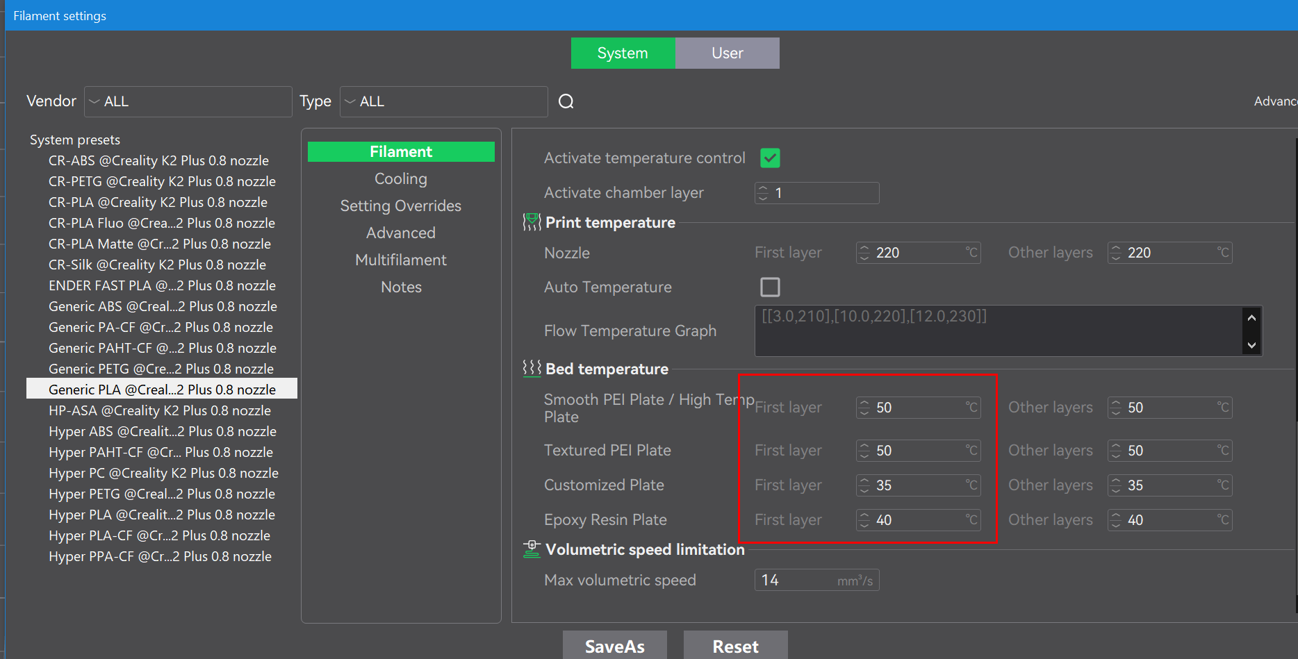

  1. Build plate temperature too low
    For PLA, typical build plate temperatures are in the 50–65 C range. If you are using stock PLA settings and still seeing lifting, try increasing the build plate temperature in 5 C increments within the filament manufacturer’s recommended range, usually found printed on the side of the spool.
If the build plate temperature is set too high, or if the first layer is squished too aggressively, you may see a defect known as Elephant’s Foot, where the base of the model flares outward. There is no harm here but just back off the temperature if this happens.

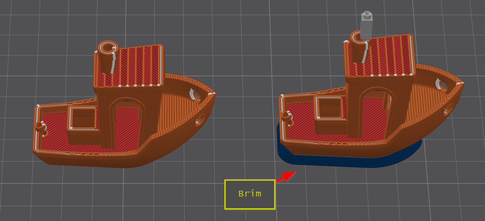

  1. Brims
    Brims are easy to enable and add a single-layer perimeter around the base of the model to increase adhesion. This option can be found in the print settings.
Note:
Brims must be manually trimmed after printing. A razor knife works, but a deburring tool is safer and produces cleaner results. It’s also a tool you’ll want in your kit anyway. Deburring tools are commonly used for metal and plumbing work and are easy to find at hardware stores.

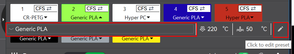

  1. Filament temps - If you’re filament temp is two low for the first layer, it may cause the print to not stick at the start. This can and will lead to the model becoming unstuck during print leaving you with either a big blob under the nozzle or a pile of spaghetti. Fix this by going into the filament profile and increasing the filament temp for the first layer.
