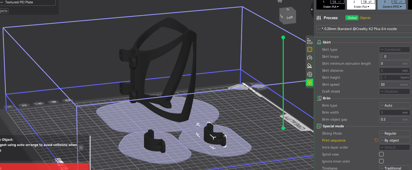

Printing by object instead of default by layer

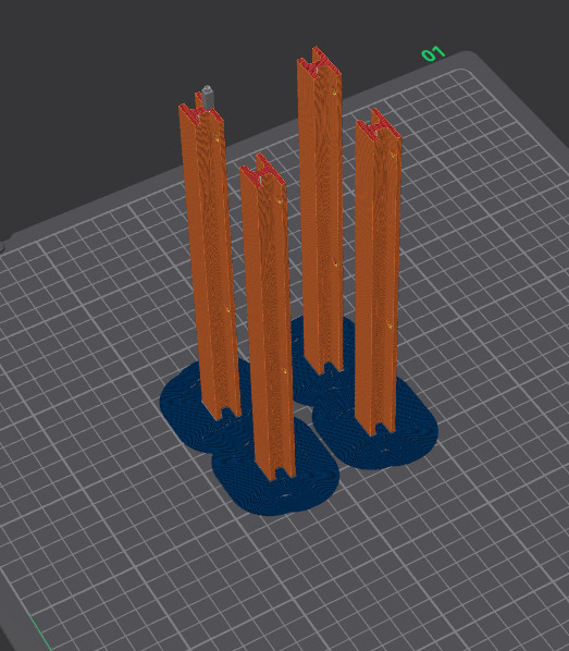

Interesting feature this, I find that If i’m printing multiple tall skinny objects, I get better quality and less chance of them falling over, being knocked over during print, if I switch to print by object and just print an object continuously before moving onto the next object.. don’t use it that often, but if trying to print say 4 really tall objects like this:
it has more chance of working (even with Glue & brim I’d likely get 1 of 4 failing and have to exclude it)
it enables this type interface and if you move the object apart so the extruder has space to operate, the objects in above photo printed without issues..
really only need it for tall skinny objects.. but its a useful option
