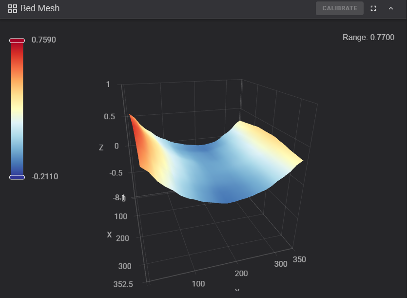

Z-offset strategy did not work, because depending on the bed region I still had issues. I’m now back at 0 offset. What really seems to have solved for my “taco after a car crash” bed was to increase bed_mesh resolution to 13x13 and interpolation to 3x3. For the first time I was able to print a full size solid first layer with great quality (not perfect) even though my bed has 1mm deformation and is not uniform at all (not a smooth taco shape).

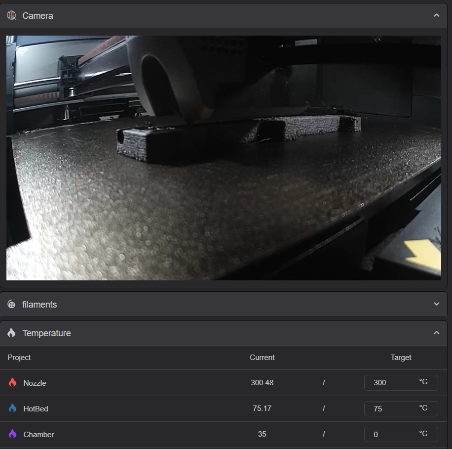

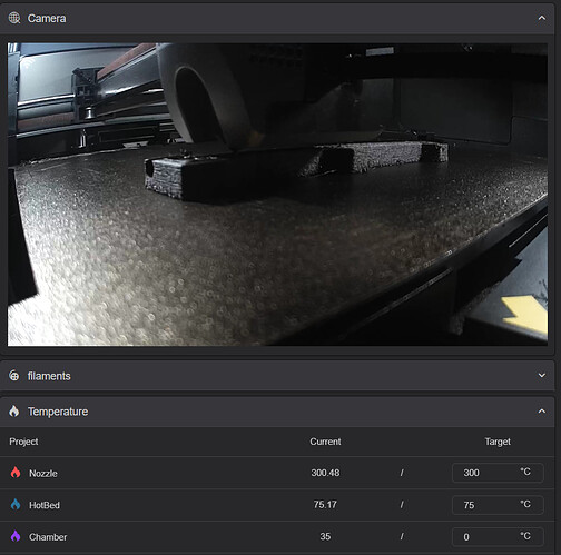

This is my most recent mesh.. Currently printing PA6-CF @ 290c with a bed temp of 75. Let everything soak for about 20 minutes and this was my result.
Actually @ 300 nozzle.

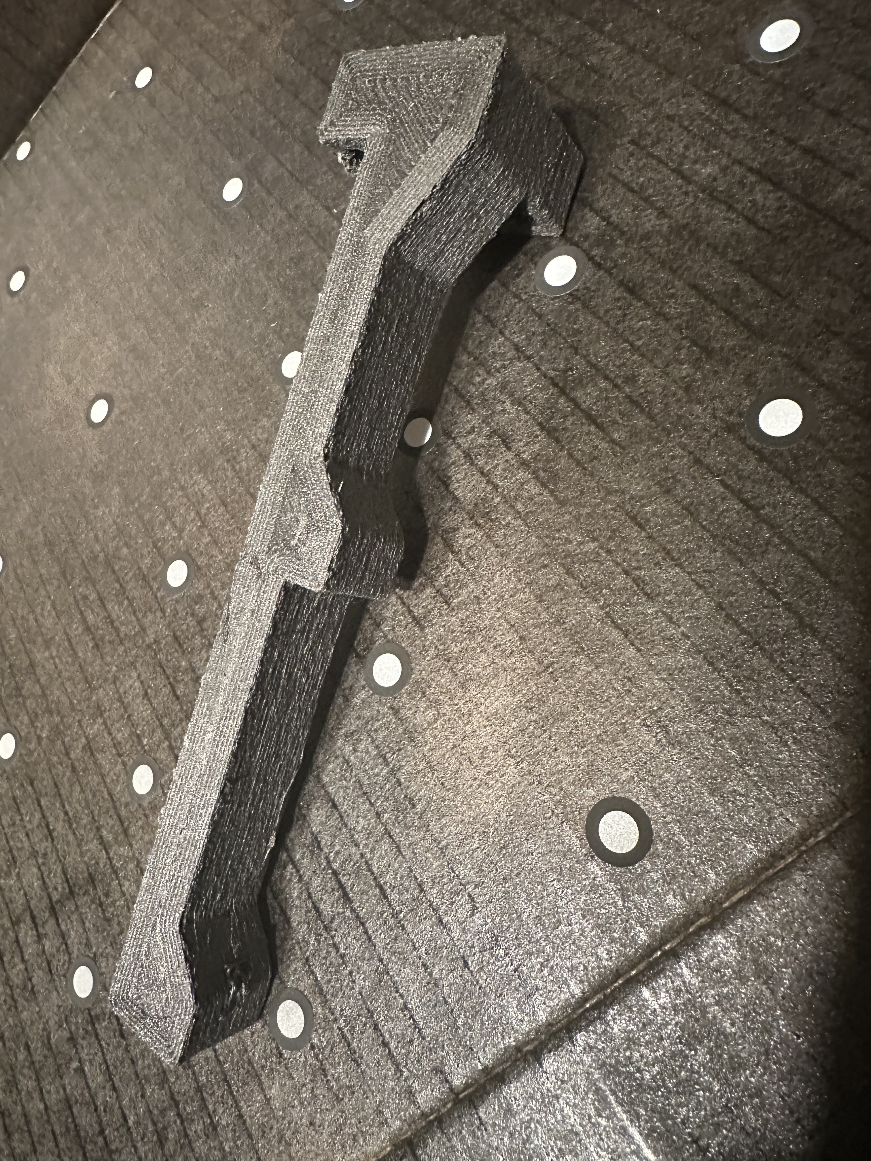

So, this was done way too hot. Just ran calibrations and 290 is a sweet spot — but with no calibrations outside of the auto bed mesh etc, this is how my bottom surface came out w/ 0 offset. (First go with a .8 nozzle).
